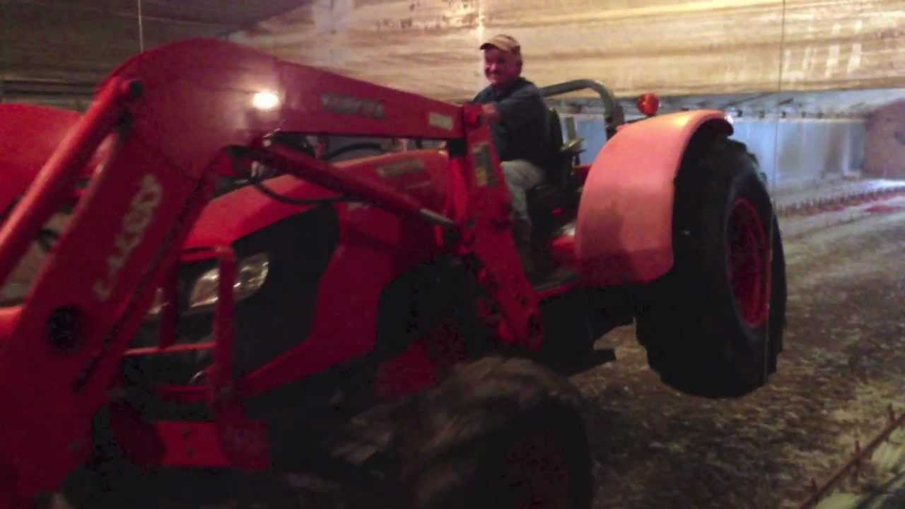

Yes. It also adds lateral leverage if you're not on completely flat ground to tip you over sideways.
Hey, speaking of tipping over sideways have we started arguing about the role of the front axle pivoting yet?!
Great example of front pivot doing its thing when not enough counter weight is used. It's a fun short video to watch at this link: https://www.youtube.com/watch?v=mRus_-ipbUo
