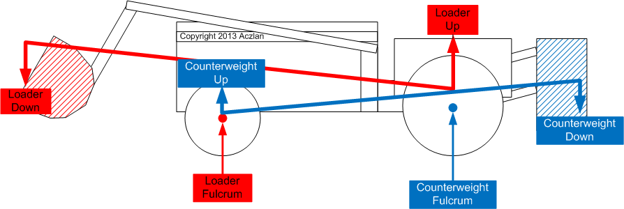

This discussion come up every year or two. I will assure you that any weight put on the 3pt unloads weight off of the front axle. Even 1 pound. How much it unloads is a function of how much the wieght on the 3 point is and how far back it is from the centerline of the rear axle.
Lets use an absurd example to illustrate my point. hitch a boom pole to your 3 point. Only now this boom pole is 100 foot long. How much weight on the end of this 100 foot boom pole do you think you would need to lift the front axle off of the ground when your loader bucket is full of wet sand? Not much I would wager. In fact in the boom pole was made of steel, I think you front axle and loaded bucket would be off of the ground without any weight on the boom pole. Now shorten the boom pole to 50 foot long. Would the loaded bucket and front axle stay on the ground? Maybe? how about 25 foot long? Now we would likely have to add a little weight to the end of the boom pole to raise the front end right?
How much, I will leave to others to calculate, but my point is any and all weight you add to the 3pt, whether that is 1 pound or 1000 will take weight off of the front axle, as we have built a lever system with the fulcrum point the centerline of the rear axle, and the 3pt is definitely behind the rear axle center line. So the more weight we add, and the further we place it behind the fulcrum, the more weight it will remove from the front axle.

The simplest way to look at the math/physics is to consider the "additional" load on the front axle as a function of loads on the front loader and loads on the three point. This will be the load above and beyond the basic contribution of the tractor weight. When perfectly ballasted, let's say there will be no more load on the front axle than usual. For that to happen:
F * LF = R * LR
where:
F is the load on the front loader
LF is the length from the front loader's load to the rear axle
R is the load on the three point
LR is the length from the three point's load to the rear axle
That tells us that the rear ballast load must be:
R = (F * LF)/LR
As an example, say I lift 1000# in my L3200. LF is about 7'. LR is about 4'. That means:
R = (1000 * 7)/4 = 1750#
In other words, it would take a heck of a lot of ballast not to add additional load over the front axle. More ballast than the load itself!!!

That is not how the physics work. There are loads on the front and rear of the tractor, plus the tractor's weight, all pressing down. That is counteracted by the combination of the ground pressing back up with a force (or reaction) on the front axle and a force on the rear axle (either of these can be zero if the axle has lifted and the math/physics still works). They all have to add to zero if the tractor is stationary (i.e., not going airborne and not sinking into the ground). Any combination of the front and rear axle reactions that satisfies physics will do that. The exact combination is determined by the distances between the various loads and reactions, which is how leverage comes into play.
