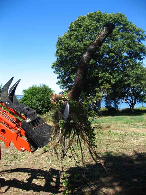

I second these concerns. I have 2700lbs lift at pivot pins on a 4000lb/40hp tractor but have to be careful lifting big things like rocks/concrete barriers because the loader will lift more than can be safely transported given my ballast is usually a mower or even a BH. I almost never lift to full height anyway but usually have heavy loads just a foot or so off the ground.
Where I find lots of loader capacity very useful is in uprooting trees. That way you are using more the curl or lift while the grapple is still in contact with the ground and more of the lift capacity is usable.
