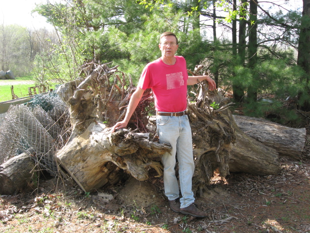

I've dug up large white poplars with my humble T5C Back Hoe (days/stump), tho' these were not oaks as blanket TSO's spread. (Howdy 'T'!) A friend has done similar with his JD 500C (hrs/stump). (a big'un) Neither of us could do much neatly without re-positioning a few times, something less needed when grinding.
Dug stumps are indeed large for tree dia and become a mess to get rid of. Dirt doesn't just flake off when dry, or rinse off in the rain. TSO's clay soil clinging won't help them burn, and if ashes are added to compost it'll go in there too. (recent pic of poplars dug 8yrs ago, & you can see what's left now .. clay still caked-on)
I had apple stumps ground decades ago, and the only hassle was that tossing all those chips in with the back-fill sucked enough nitrogen from the soil to keep anything from growing there for years. (lawn, not woods or pasture-in-progress, and sink-holes will appear as roots docompose) Soon after, I dug similar (mature) apples with Glenn's big JD. That was anything but the 'snatch-n-grab' job I expected it to be. (Cutting large roots had to be done at random, and works best with a SawZall run off the generator vs trashing chains)
With enough stumps to remove I'd consider grinding to be the more efficient option o'all, needing only a fraction of the time/labor and equally less work to clean up and re-level each hole. A BH would do a lot of other tasks, but digging stumps doesn't seem to be their shining hour regardless of size or power. (say Glenn's 70hp vs T5C's mere 20) IMO, whether a grinder or BH should be an attachment vs dedicated gear should consider other general uses for either. :2cents:
