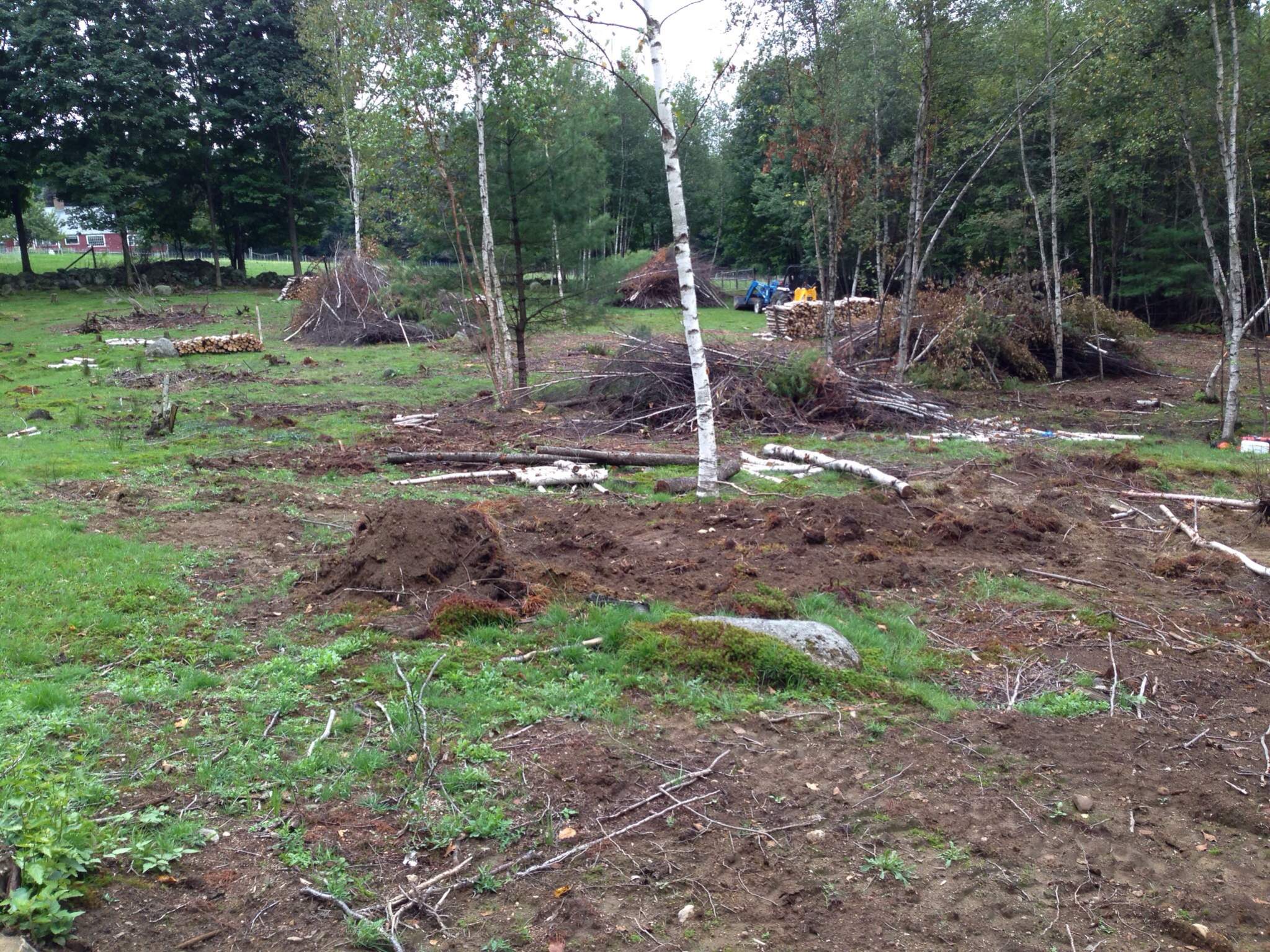

I never used a stump grinder but I stumped an area for a hoop barn and paddock area about 120 x 80 in the woods off of my front pasture a few years ago. I was using a 750 woods 3pt backhoe then. There were several 20 inch maple and ash trees and lots of 6-12" stuff. It took up to 2 1/2 hrs each to dig around the big ones, break up the roots and pull the tap root. Then you have to get a 6-800 lb root ball out of a 4 foot hole...! Very time consuming. The smaller stuff... not so bad. I ended up leaving a dozen flush cut 10" stumps in the barn area since I had 100 yards of fill brought in to raise and flatten out the area for the 30 x 40 barn. There are 5-6 big stumps off in the woods that are still pretty solid. A few places had a hole so deep I put the stump back in upside down and was able to cover it with 2 or more feet of dirt. I now own a Kubota KX121 and IMO even that is small for stumping. I learned a better way is to dig and break up the roots around the tree you plan to cut / stump. Push it over so the roots break off. The root ball is smaller and exposed. Pick up the trunk end with the thumb and cut the stump off as close as possible. My lower pasture (about 5 acres) was previously logged off 25 years ago but never stumped. Since it had some new growth of 5-8 inch birch I decided to get back there and started to open it up. While stacking brush, I pull those old stumps real easy with just the thumb since the roots are pretty much gone. image.jpg
