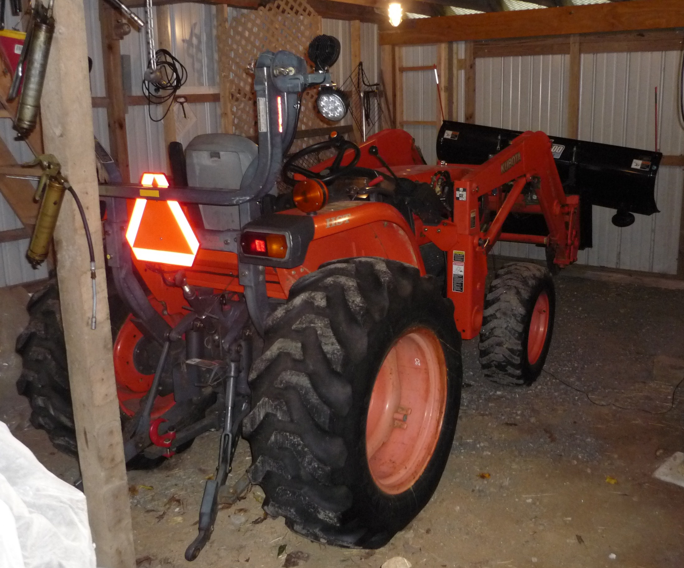

The wheels may have been USA sourced, with different paint: I see a lot of Kubotas where the wheel paint is more faded than the tractor itself. kOua's questions are relevant... tires, tranny, loader, etc., and could make our "opinions" vary accordingly. We sold our L3130 for over $14,000, in early 2015, but it was clean, serviced, and I had added some good lighting and so forth. (note the faded wheels in photo! I had forgotten about that.)

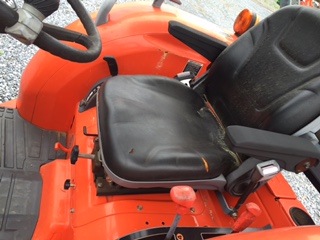

Neither tractor has the quick attach bucket, both has one remote. The 3130 has a shuttle shift and the 3301 has what he called a shuttle shift but it was different from the 3130. 3130 has telescoping lower links, 3301 did not. 3130 has the La 723 bucket 3301 had a smaller bucket but I can't remember the numbers. Ag tires on both which is what I want. 3130 looked well maintained no leaks, no dents, normal wear and tear. Small tear in the seat.

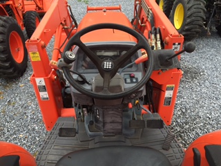

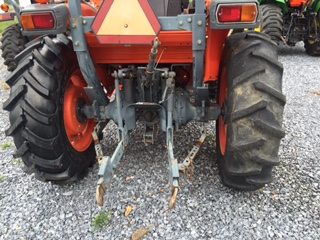

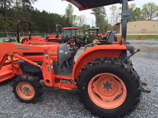

Pics of 3130

Whats with the rear tires?
Maybe make a deal with the dealer to order another rear tire for the other side, and offer to split the cost with him as an offer.

Not sure, but I think you'll want both rear tires to have the same age and, most importantly, tread pattern. Especially if you plan on keeping the tractor. Nothing wrong with the shuttle shift, unless short loader trips are all you do, period. Otherwise, you get a little more power to the ground and PTO... Still like the L3130. SSQA is doable, if you can weld and cut. Our L3400 had it installed by the last owner, and it seems just like the factory setup. Here's a link to another thread about just that:
