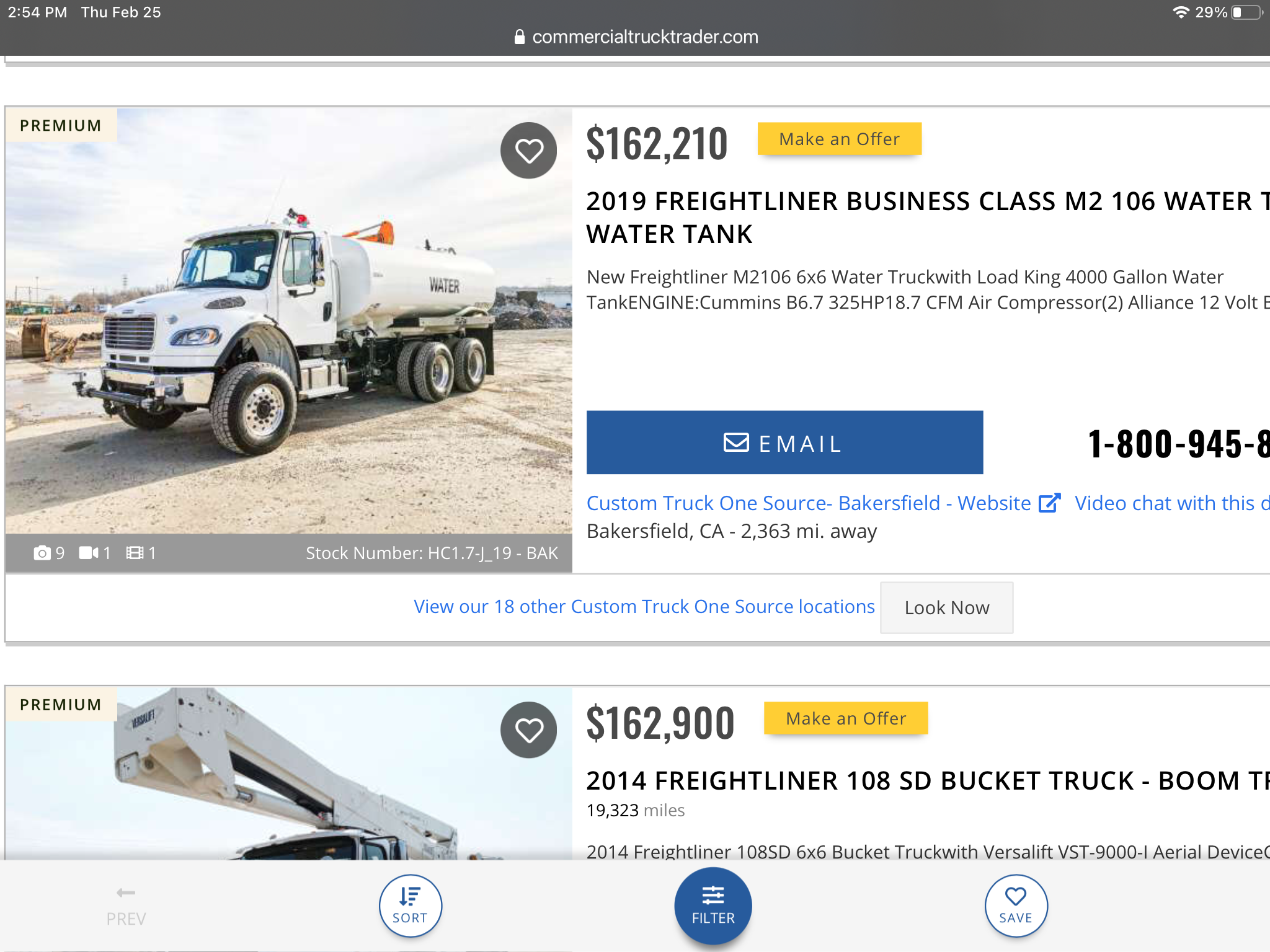

Lets not get too crazy....:laughing:
If you are suggesting an 2-3 liter eco boost gas engine is in the same league as a 6.7L Cummins, I got some prime swampland in Arkansas I can sell you for 100k/acre :rolleyes:
Do you really think this 6.7L Cummins powered Freighliner 6x6 with a water tank could be powered by a Ford eco boost gas engine and last more that a few hundred miles?
