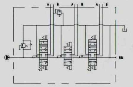

Just realized that I gave plenty of history, but still haven't described the goals! /forums/images/graemlins/blush.gif
Actually, didn't you just replace a pump JJ? Any insight would be greatly appreciated. /forums/images/graemlins/cool.gif
The Valve:
1. Makes the front and rear hydraulics independantly controlled instead of parrallel (meaning you have to unplug any front attachments to use the BH and vice-versa)
2. Makes attachments reversable.
3. Allows for soft starting and hard stopping, vice versa, any combination, or anything inbetween. The current setup always has hard start and soft stop.
The triple pump:
1. Splits up the steering and the lift.
2. The large section has 50% more displacement, so I can run high volume/low pressure attachments if I want (the down side being for PT attachments I'll have to meter off some volume or run at half throttle - but I'll have spare spool on the triple valve anyway, not to mention a spare ball valve)
3. My existing pump becomes a spare
4. Since the PB port of the steering no longer needs to go to the lift valves, I can run it to a fine [3micron] filter instead (which I forgot to order, but that can be a later project).
So, it all does have some reasoning, but that doesn't mean that I'm not nuts or that I didn't mismeasure and something will decide not to fit. /forums/images/graemlins/crazy.gif /forums/images/graemlins/grin.gif

Some assembly required! /forums/images/graemlins/grin.gif The parts on the floor all came out of one bag; notice there are two more lever assemblies still in the bag. /forums/images/graemlins/smile.gif
Not quite expecting that one, but it beats the heck out of the rest of it that I am expecting. I held it up to the machine, it will fit; that cover will give me some issues, but I knew I'd need to cut it for the levers anyway. Now I'm thinking one large slot instead of holes.
Haven't unpacked the pump yet; hope it looks as good, and fits even better than the valve!

This really tells the story. The dentened postions are sweet! I have not idea why, but between having the control of a mechanical valve and the feeling when you it "kick" into the detent; the whole thing just feels "macho" compared to the switch....and I haven't even put the hoses on yet! /forums/images/graemlins/grin.gif
It would have been nice if it was a bit smaller, like the 2 spool I was originally looking at (which was smaller in general too; not just the 1 less spool), but I couldn't pass the bargain on this one; especially knowing if I did, I'd want the 3rd spool sometime.
Notice it is much larger than PT's, but this one needs twice the flow rate as the loader, so I don't think there is one of that size that could have worked.
Afraid the cowling might have to disappear altogether, but I'm open to suggestions! /forums/images/graemlins/smile.gif
