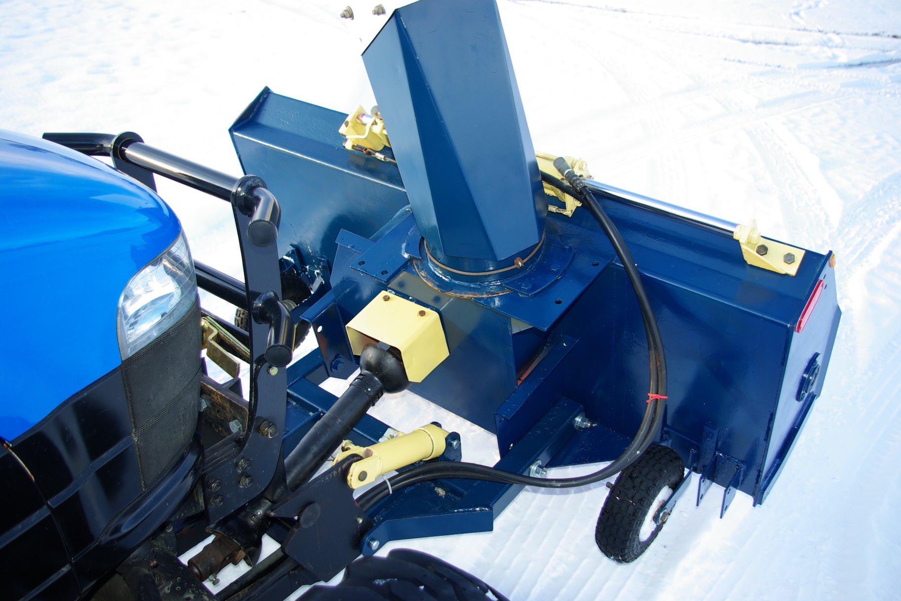

That's tied to the chute via a cable for chute rotation.
   / YSS Series Snow Throwers? #12

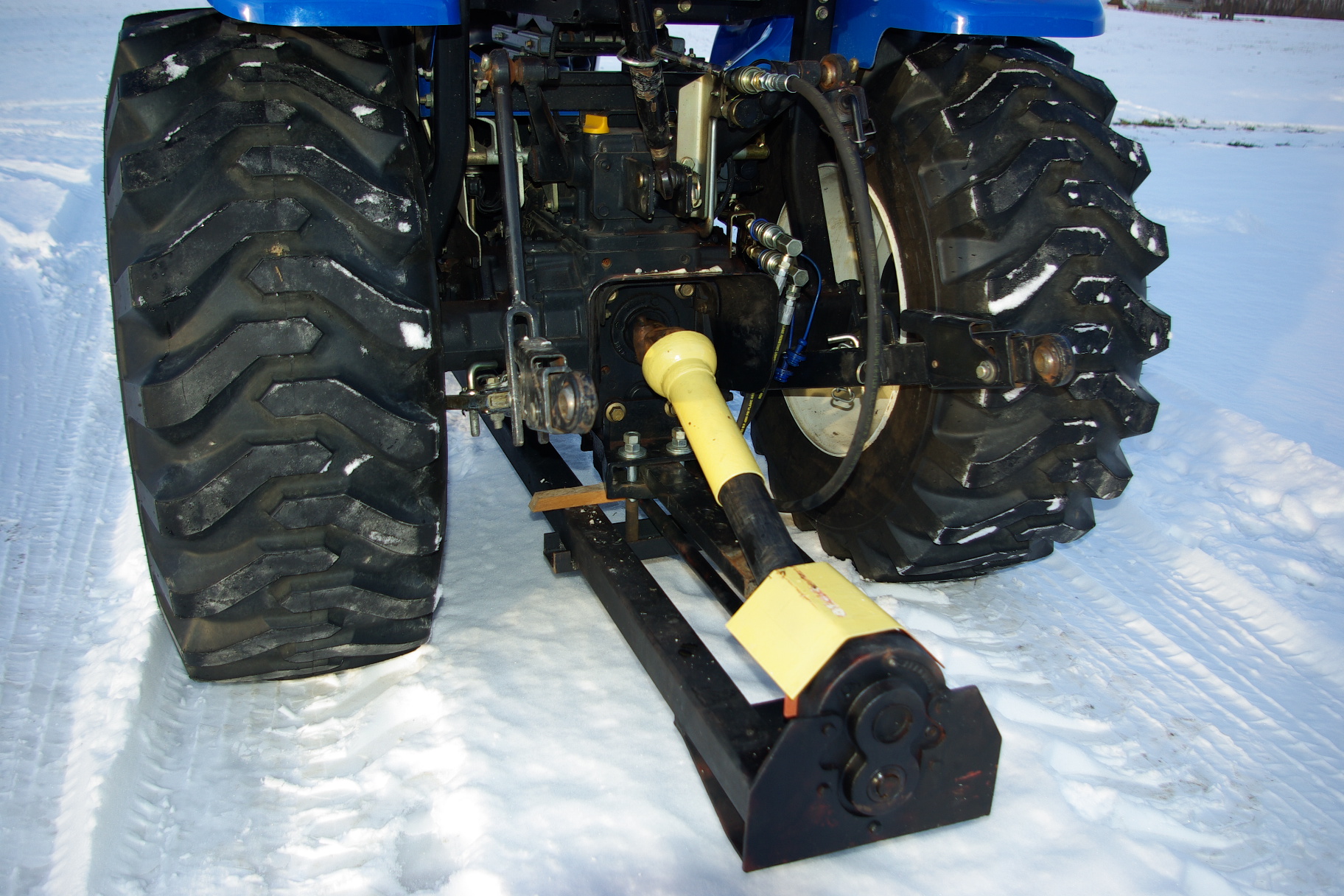

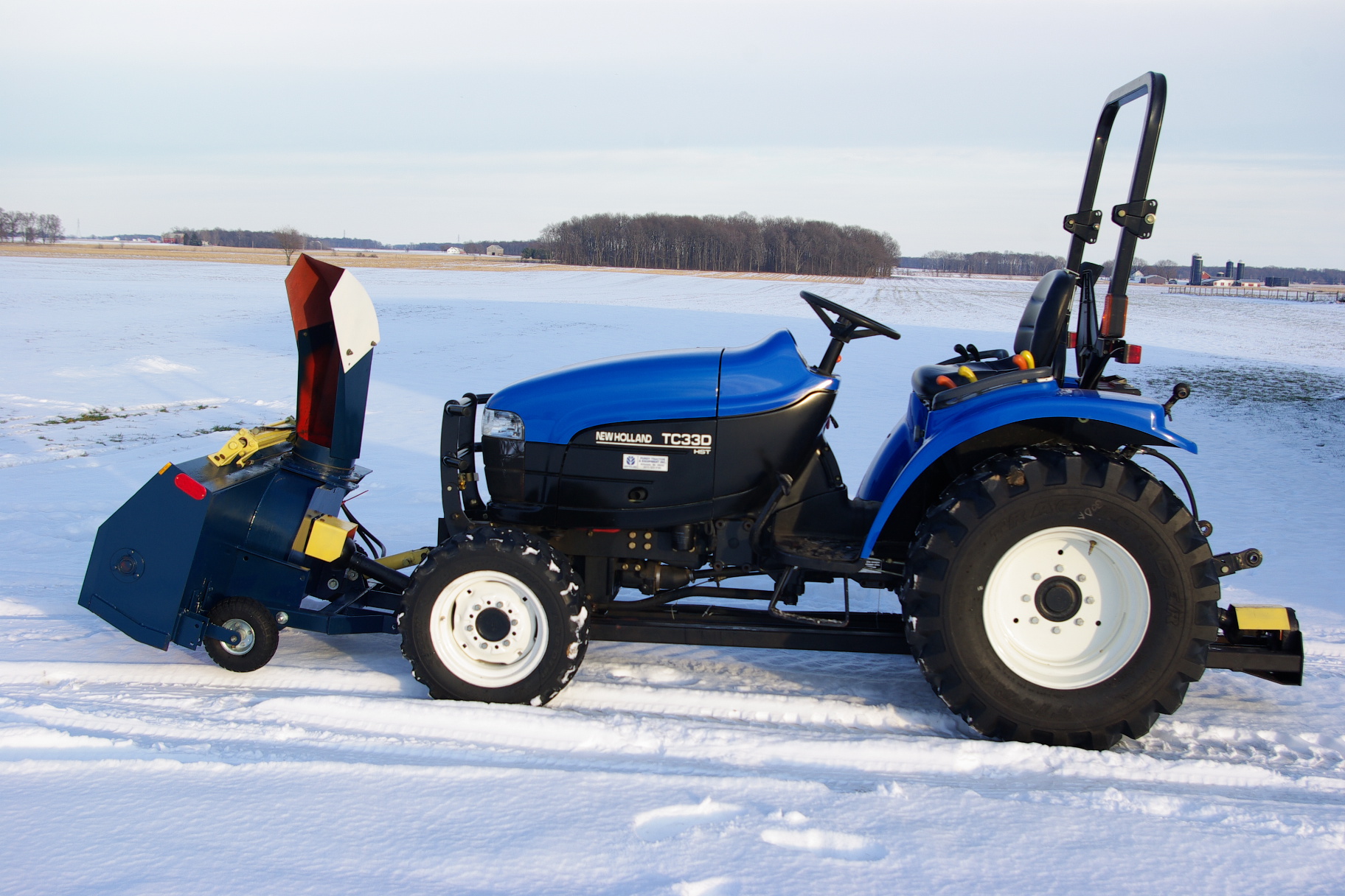

I posted these on "SNOW WEAPONS" a week or so ago. The model is a YSS-60 and although bought with most of the undercarriage, I converted it to a 3 pt. mount for my previous Case-IH 1130. Put the undercarriage under my TC 33 and with some figuring, cutting, welding and luck made it work and returned it to a front mount (tired of looking backwards). Runs very smooth and I have not been able to hurt it yet but still waiting for the heavy snow, which may be arriving tomorrow here in lake effect, Indiana.

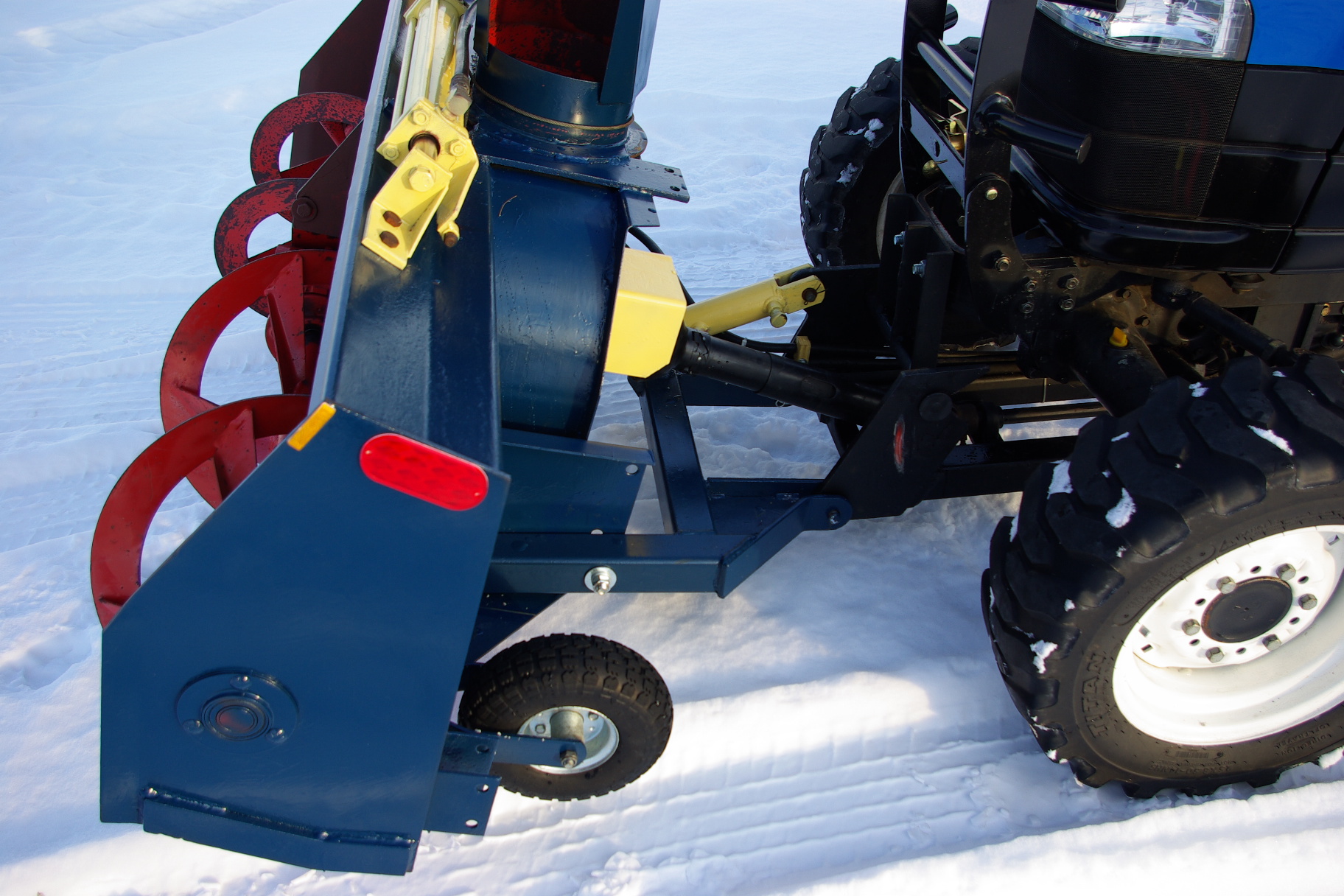

Nice conversion! How well do the gauge wheels work when turning? I was looking at the exact same modification for both my 48 and 60 models. Not at all impressed with the factory skids.
   / YSS Series Snow Throwers? #14
The gauge wheels work and the fact that I'm on snow helps. Gravel drive so I have the blade set about 3/4" above the wheels. A little lift pressure on the hydraulics helps even more. They obviously do not pivot, just slide on the snow. That little lift cylinder pops right up with a 2000 psi system so I found an in-line restrictor for the lift line. Much more managable now. I assume the Yanmars of that era probably were not that high of a pressure.

Gravel drive and parking lot here too. I was planning on building a caster style arrangement with DOM tubing to allow some rotation when turning although I don't turn much with the blower down.
Thanks for the prompt input.
   / YSS Series Snow Throwers? #16
If you look close, the height is adjustable by loosening the clamping brackets. When I used it as a 3 pt. unit, the height was easily adjustable with the top link. The wheels are from Harbor Freight and cheap to replace. I have broken 1 hub in the 10+ years I have used it.

Glad to see the blower preserved/restored. Sad to see it's been cut up and not on a Yanny, but at least these things are still out there and going! :thumbsup:
