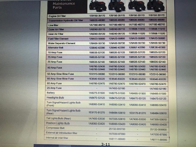

Transmission hydraulic oil filter (198535-48080)
Line filter (1A7180-48210)
Fits YT347 and YT359

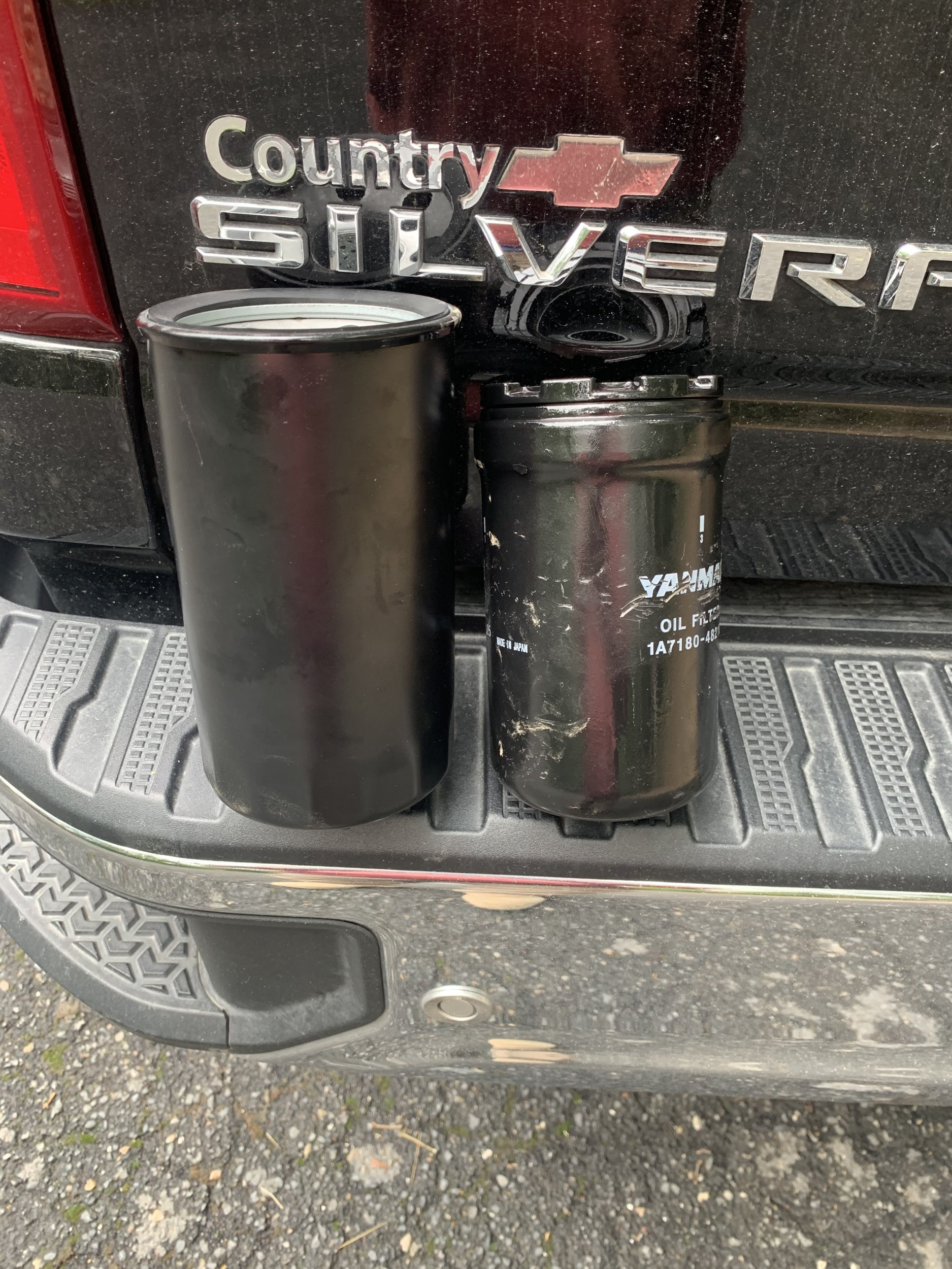

Here is a pic of the two hydraulic filters, not sure which one you need but you can see the part number on the smaller one.

Thanks all for the help. I do need the smaller filter.
