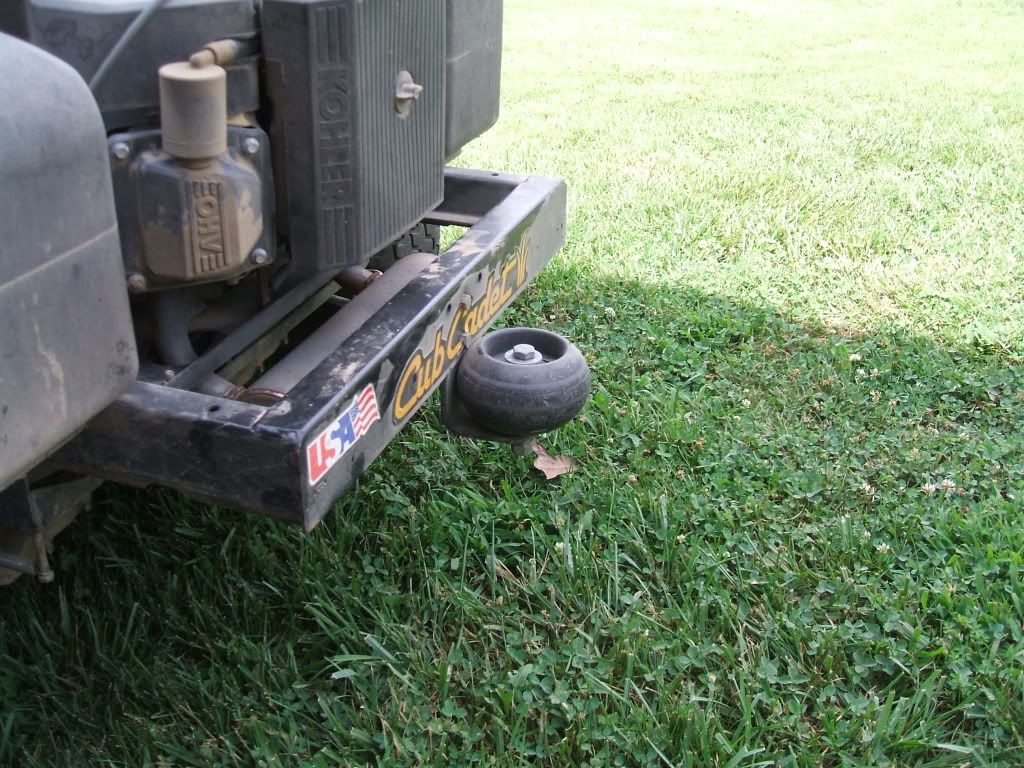

Great mods to all. Gotta say OM's are the purdiest. Love that wheel guard. I don't get too much collection on my 44". None that can't be blown out w/ my leaf blower. Savage, you must have one HECK of a smooth lawn to allow for setting that low a deck setting!

You have to understand that I am not the one that mows with Z-Force most of the time I use a Allis Chalmers CA with a Woods belly mower. The little woman uses the Cub to do the cutting around the house and other areas the I can't get to. She won't use the string trimmer so she tries to cut as close as possible to things and that guide wheel was always ether bent or completely missing and believe it or not she has managed to bent the guide wheel center bolt even after I welded on the guard.
Well tomorrow I have to put a new blade belt on because she decided to try to cut an area that hadn't been cut yet this year and didn't raise the deck up. It clogged it up solid and smoked the belt till it broke. I shouldn't complain I could be cutting the whole 10+ acres we cut each week all by myself.

I understand the need for a bumper. I installed a tow hitch on the back of the Z-Force to tow 15 gallon spray tank to spray the driveway and ditches and then I started noticing horizontal gashes in trees, posts and even one in the vinyl siding on the small old farm house we use for a guest house. I had to mount one of the old guide wheels in the hitch to prevent anymore damage.
