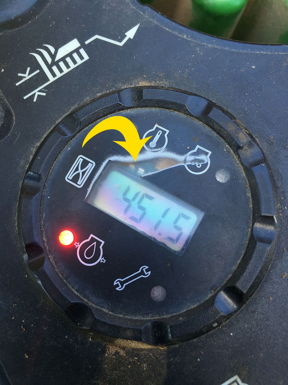

Alright, more details and mysteries for you, if you're game. I checked every connection I can find (fuses, wire endings, etc) and all are in tip top shape as far as I can tell. Turning key to ignition still gives a small jolt to starter every once in a while (even when not being jumped off) . . . I stumbled onto the following (image below). Notice the "tear" in above the digital readout. Now, I know for a fact that this showed up AFTER my numb headed criss cross jump start that started this mess. I'm wondering if the issue is with this part? Wanted to get your take on that.

I'm going to keep positing my findings on this thread for future users. I found out something interesting. The main bolt on the side near seat that secures my control panel to my mower frame was missing (top screws are intact). I had a theory and tried inserting a screw driver into the threads to make a connection between the frame that holds the bolt and the metal control cover - viola . . . . Error light quit and it started. I have reordered the bolt to take care of that and will post if it is a solution or not.
