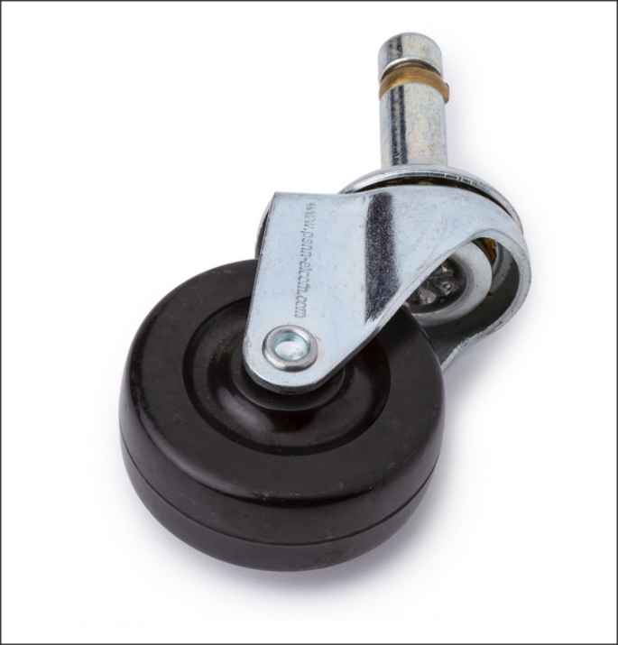

They are just large diameter casters - no thread needed.
   / Z700 Series
That's funny. That's exactly what they look like and probably perform like. Good on even terrain.

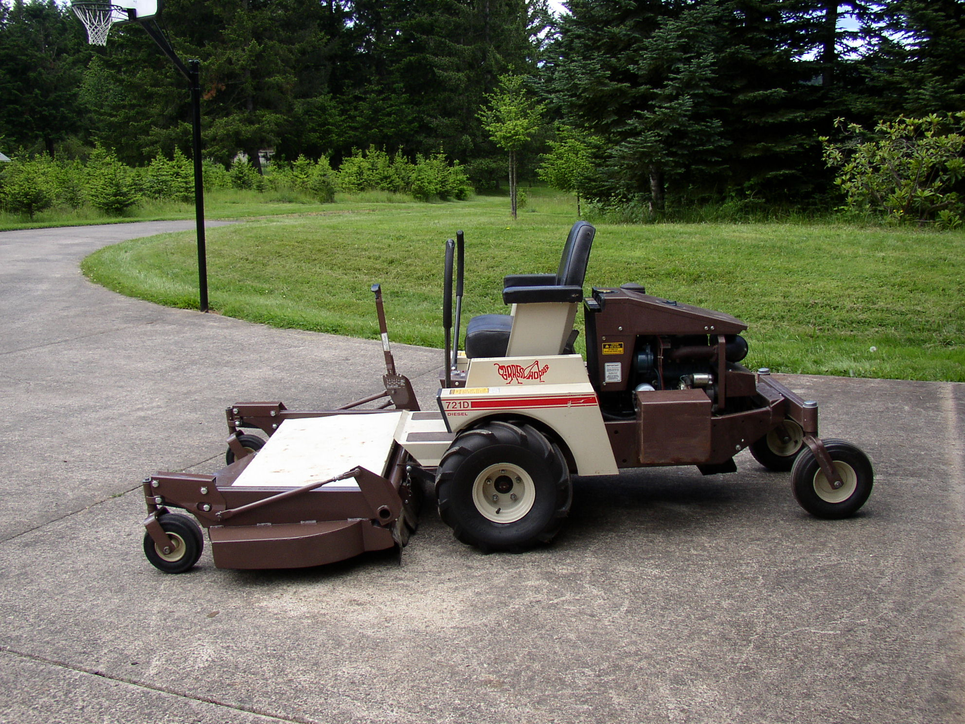

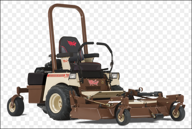

The front deck in Grasshopper is great when for example there is a need to get under fruit trees etc.
Ours is a year 1993 ex. commercial mower, with 61 inch mulching deck bought used about 19 year ago.
The deck can be manually tilted up for service, but it's very heavy so hoist is needed for tilting it up for sure - my solution is simple:
I just drive the deck up on HD car ramps, which were made out of 3"x10" 7 foot long planks.
The newer Grasshopper models have deck lift available.
