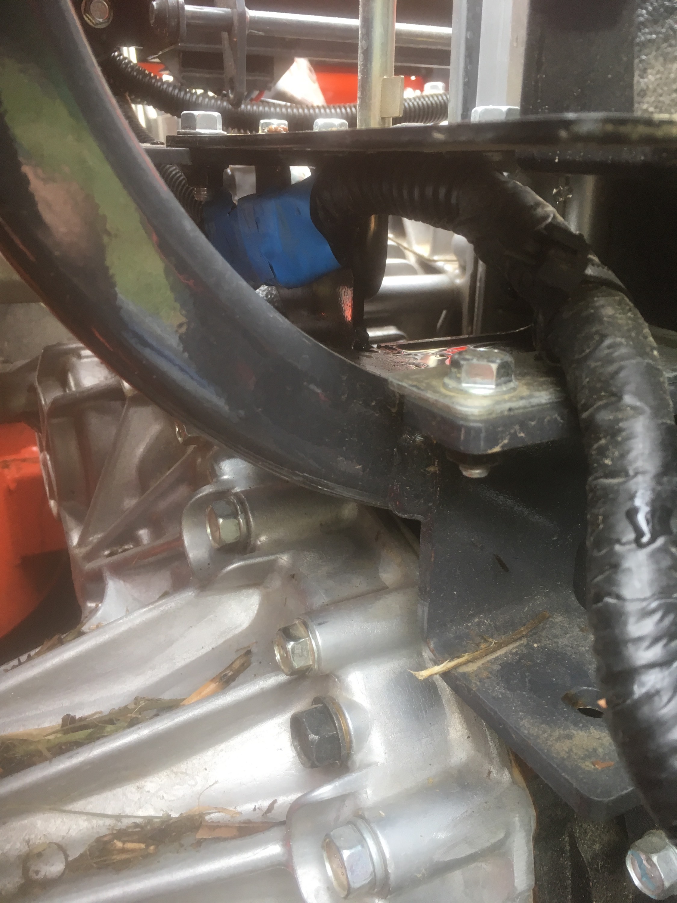

Found it.
For those with 1211's. If you look behind the rear tire on the left side where the rops goes down above the axle. You will find a smaller loomed wire that is doubled back and is taped to the larger harness. Mine had blue tape on it.
There is your power and ground wire plug for rops lights. You will need to put a fuse in the bottom spot of the fuse box labeled lights. It will then power on and off with the key switch.

Nice find. Mine has it on both sides I believe. I did find wires on both sides wrapped in blue tape

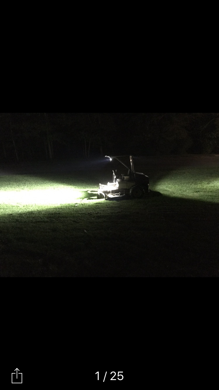

I have a light bar and fender lights on my Grasshopper. The light bar on the canopy is a lot better mounting spot. I bought good pods for the fenders that actually are flood lights unlike the cheap ones but it’s such a low vantage point they throw a lot of shadows off the mower and don’t go very far. IMG_2077.JPG
