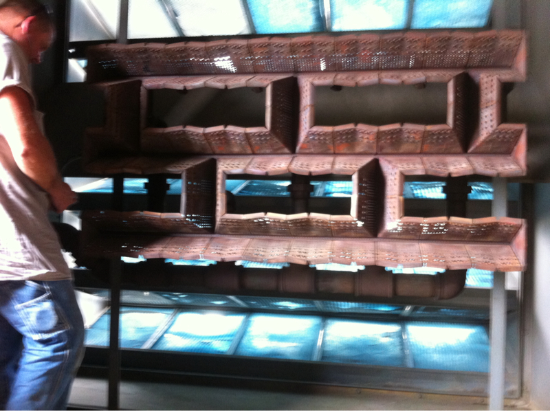

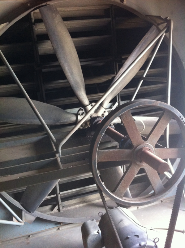

Just take it out and make sure it's clear and the area is not loaded like others said. I would recommend spraying penetrating oil in instead of heat to soften harden grease. Had a locked up prop in a Hartzel make up air unit. I pulled grease lines sprayed Kroil in bearings, cut belts, and pulled sheave. I went to the end of prop and pulled and pushed to no avail, it was locked tighter than a drum. I left it and quoted the bearing change. Next time I was there I walked by and it was running. I shut it down and climbed in.... Same Bearings! Maintenance guys said it when they looked at it it was freed up. So they put it back together and let it eat. Guess the Kroil loosened the hardened grease. That is what I use now when I pull a zerk and grease has hardened. Fan is going on year four on same bearings. Lol (attached fan and burner pic)
