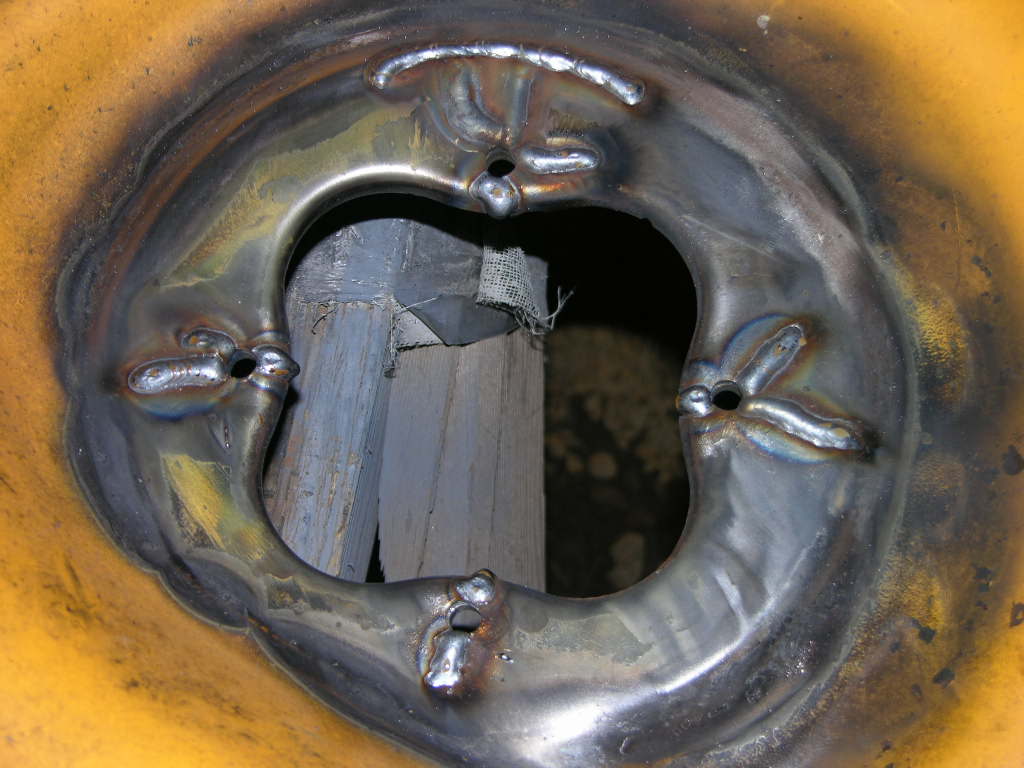

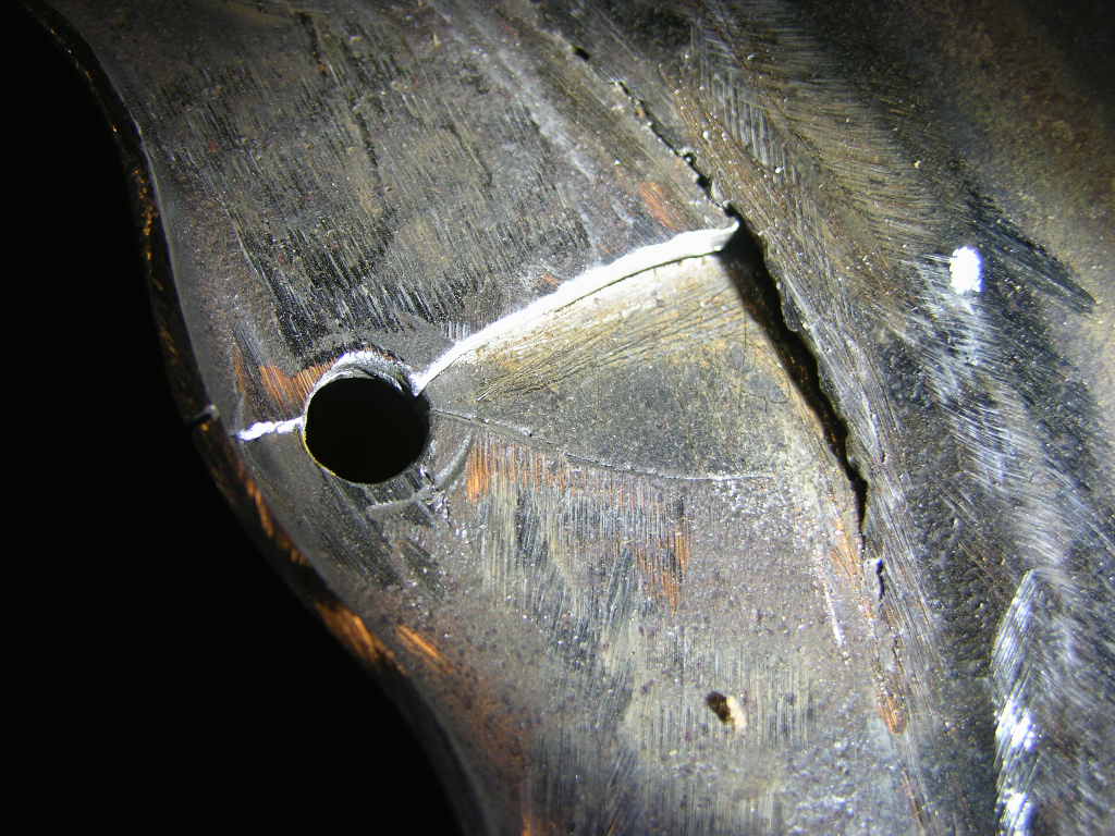

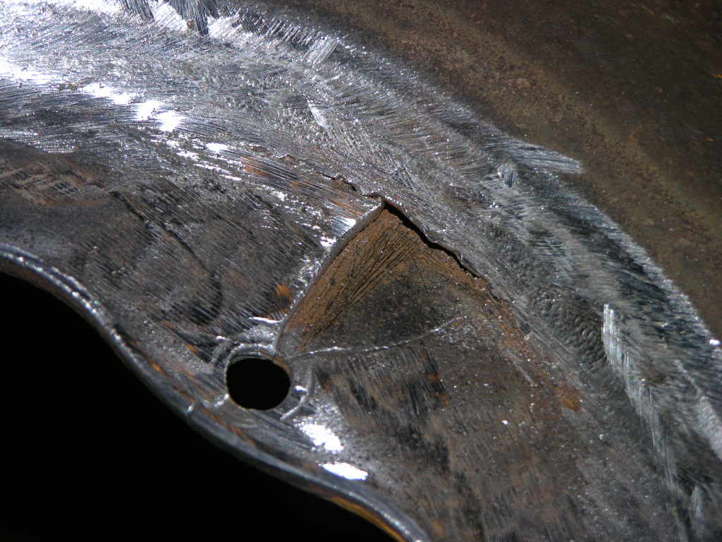

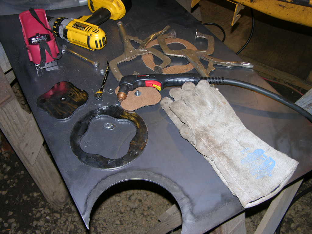

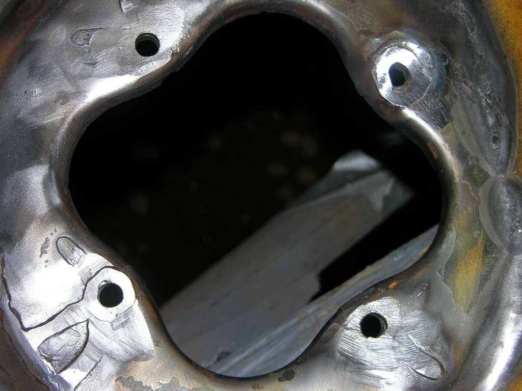

Found out ya can't really mow 3" limbs sticking out of burn piles with a cheapy stamped steel deck :confused: - Bought a Cub RZT50 a few years ago, mowing time went from 2 days to 2 HOURS - the Cub was the only under $3k machine with a Kawasaki, and I'd had good service from the little JD with a smaller Kawasaki.
Fast forward to last week - ran over a limb end hidden in the grass, heard scary noises, stopped and found one blade and spindle laying UNDER the deck, spindle housing broken, etc - next few posts show the repair/beef-up. Hopefully it'll work better than the 13 ga. stamped steel deck by itself :rolleyes:
Pics, hopefully in order - apparently the pic uploader is STILL broken - chose 10, uploaded, only got the LAST one. Started over and uploaded EACH pic as chosen, so the first one SHOULD be the last one. Oh well...

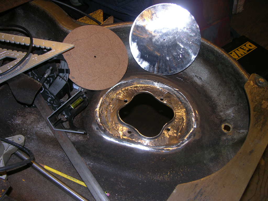

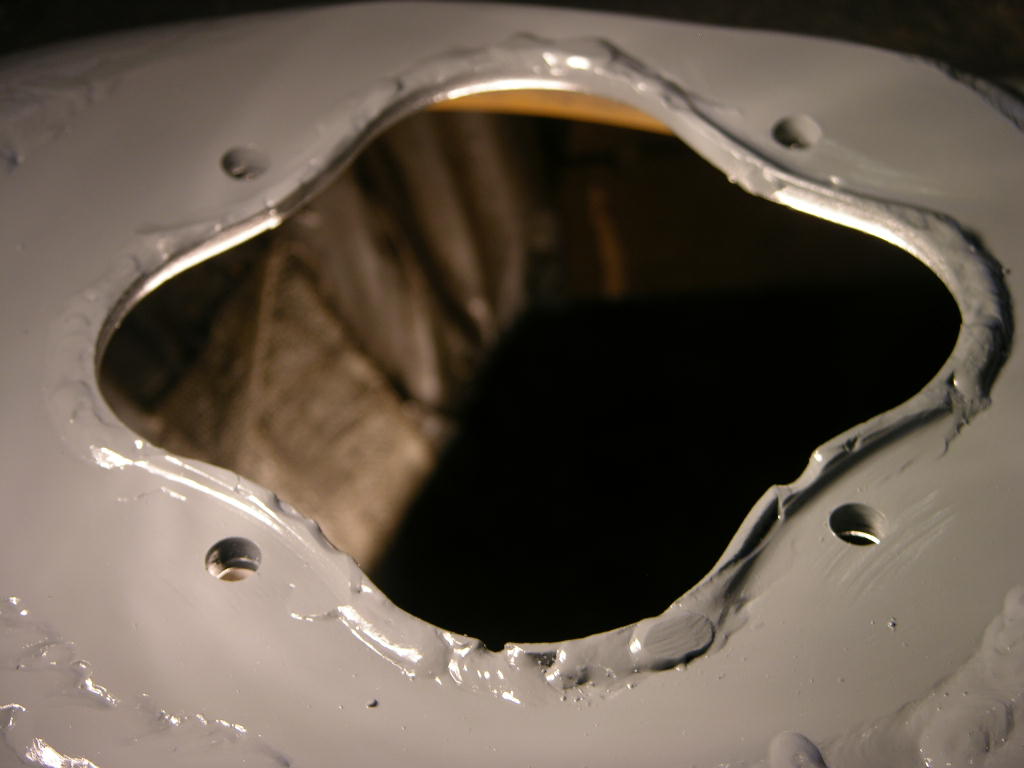

Pic 2 - broken - Pic 3 - cleaned up - Pic 4 - Worst hole - Pic 5 - 1/8 masonite plaz pattern - Pic 6 - Worst hole closeup - Pic 7 - 3/16" thick reinforcement ring - Pic 8 - fit check - Pic 9 - Clamped @ all 4 bolt holes, tacked in place - Pic 10 - Top site, cracks welded - Pic 1 - Top side, pads leveled, holes cleared.
More to come... Steve

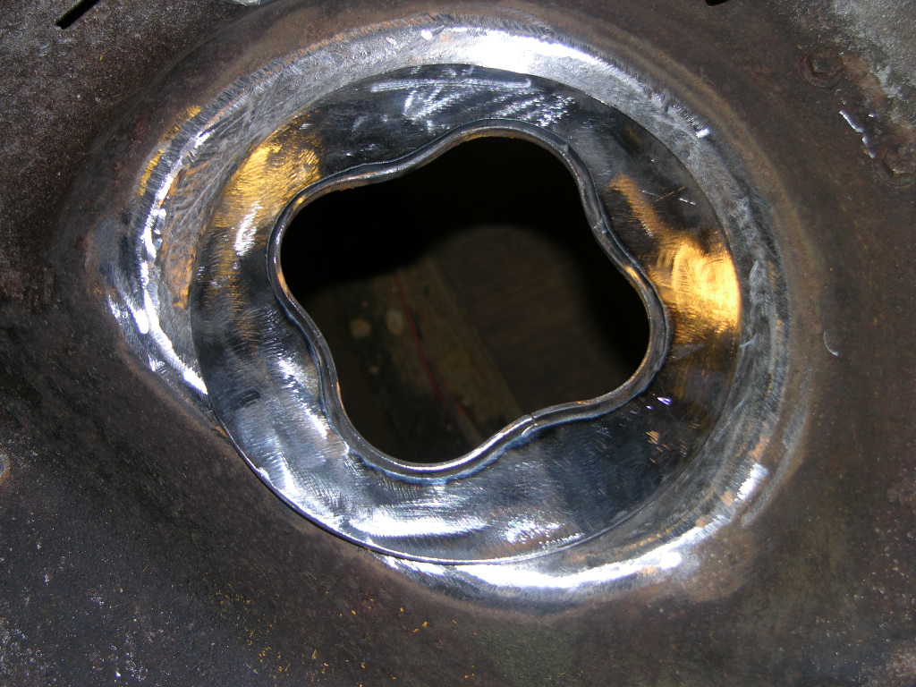

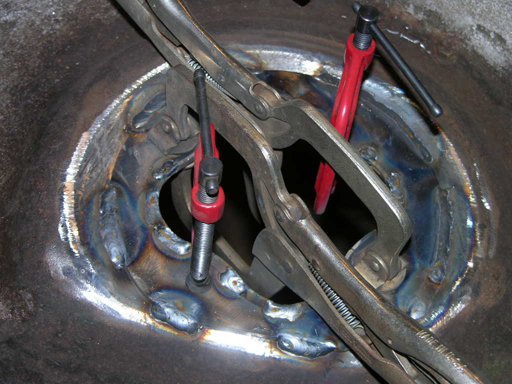

Pic 1 - Bottom, pads leveled for bolt heads - Pic 2 - Middle spindle, almost as it SHOULD be :rolleyes: - Pic 3 - Painted, curing @ about 130 degrees (two 250 watt IR lamps), ready for new spindle (due in a couple days)
I didn't want the plaz pattern to move til it was all cut out, and needed it centered so all the bolt holes, etc, would fit - so I used the center made with the compass on the masonite and the drilled hole in center of the steel circle, bolted them together and spaced the pattern off the steel with washers - then I clamped ONE of the corners down to the bench (pattern, washer and circle) so the bolted center and the clamp locked things in place.
Cut 3/4 of the inner part, then re-clamped the opposite corner and finished the cut.
Once the reinforcement was tacked and partially welded I used a transfer punch to mark where new holes in the reinforcement went, and drilled them out to 5/16" (the bolt size) in 3 steps. Used an old housing with bad shaft to check, and all 4 bolts fit perfect.
I'm saving the pattern, will most likely be doing this 2 more times :rolleyes:
Wouldn't mind a brand new Skag or Dixie chopper, but too many other things have higher priority for now... Steve

Oh, all welds done with MM252 - heavier ones using settings for .035 wire/ 12 gauge - crack repairs in 13 ga. done set for 18 ga. (17 volts/150 IPM) - Started all crack welds AT THE HOLE to keep the heat down/avoid blowouts. On multiple cracks/same hole, I let it cool first (same reasons)
Using lower settings lets me be more accurate with placement without burn through - staying in front of the puddle got good fusion without having so much to grind down.
Pads need to be level with each other on the side the spindle mounts to, other side only needs to be flat for bolt heads... Steve

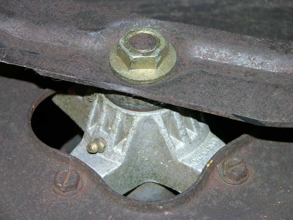

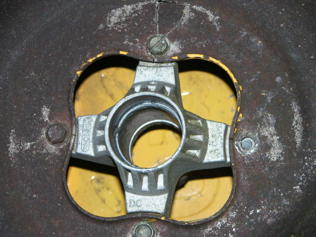

Well, the new spindle finally got here last Tuesday, which is when I discovered that just because they sell a spindle assembly that INCLUDES A NEW BLADE, it doesn't mean they are nice enough to also include a new blade NUT :confused: - fortunately I already had a couple extras :rolleyes:
They also didn't bother to include the 4 self-tapping 5/16-18 bolts that hold the spindle on the deck, but the last time I worked on this thing I decided not to trust those on the spindle I worked on - shoulda done ALL of them MY way then.
Being anxious to murder the grass before I needed a baler, I finished up the welded mount my way, then checked the other two spindles and both were LOOSE. Tightened them up some (carefully, self tapped holes in aluminum) and knocked the grass/weeds back down for a while.
Today I'm cutting out two more "patches" (see earlier pics) and the next time I have the deck off the other two spindles will get the same treatment.
Not trusting aluminum castings/self tapping bolts any more than I do stamped steel decks, my method is to tap the holes in a spindle to 5/16-18, then use longer grade 8 bolts that will reach thru the spindle housing and allow a flat/lock/nut on the back - then I torque the bolts in the aluminum (never siezed) to spec (20 ft lb if the aluminum is at least twice as thick as the diameter of the bolt, and they are) - then comes flat washer, lock washer, nut.
Finally I hold the bolt head so it can't back out, and torque the added nuts.
