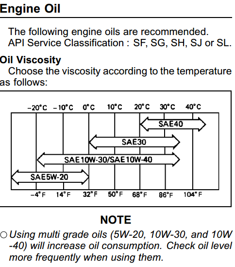

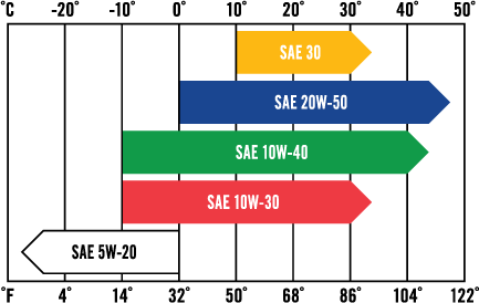

I do believe that Kawasaki recommends 20w-50w oil in all their mower engines. []
last thing I read from Kawasaki is to use 20w-50w oil
FWIW, the manual for my Kawasaki FX850V (purchased in 2011) recommends 10W-30 or 10W-40 for temps between -4F and 90+F.
Steve
   / Zero Turn Mower Shopping #36
Some on Lawnsite claim Kawasaki recently changed their recommendation chart.
http://www.lawnsite.com/threads/kawasaki-changed-oil-grades-recommendations.447650/
Thanks. Here are the old and new recommendation charts lifted from that link:
I have been using 10W-30, but I plan on switching to 10W-40 or 20W-50 when I change oil this fall.
Steve
   / Zero Turn Mower Shopping #37
As I posted on another forum, I changed to 20w-50w and my engine sounded like a sewing machine..I drained it out..mine never used any oil in the past..I think the 20w-50w is for slowing down oil use...dunno
