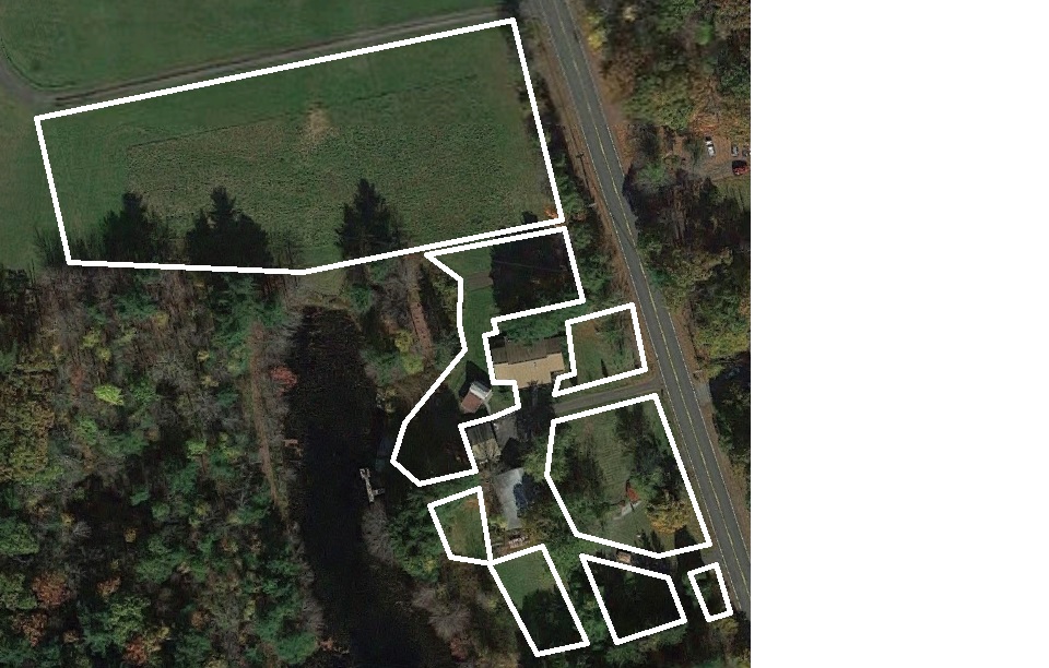

The lawn is one 2 acres field, and then 2 acres broken into small parcels due to driveway, trees, buildings etc. Mostly level, with some slight grades. Lawn is decently smooth, field is a bit rougher, but I plan to smooth out the field in the next year so I can mow at full speed. See below.
