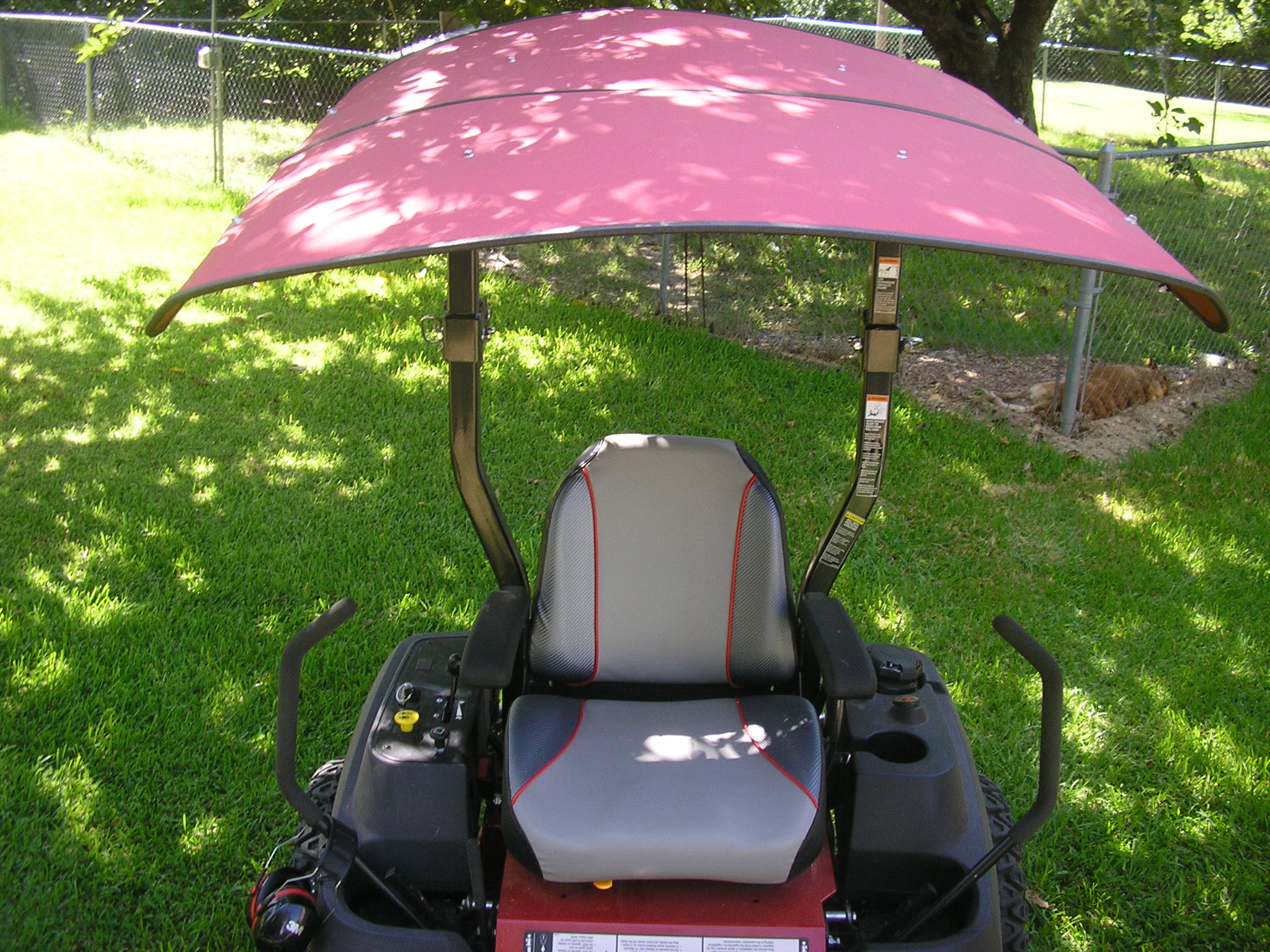

The conventional doesn't have a bonnet and the ZT does so if I wait till the afternoon when grass is good and dry, the bonnet dictates the ZT and up and down trips.

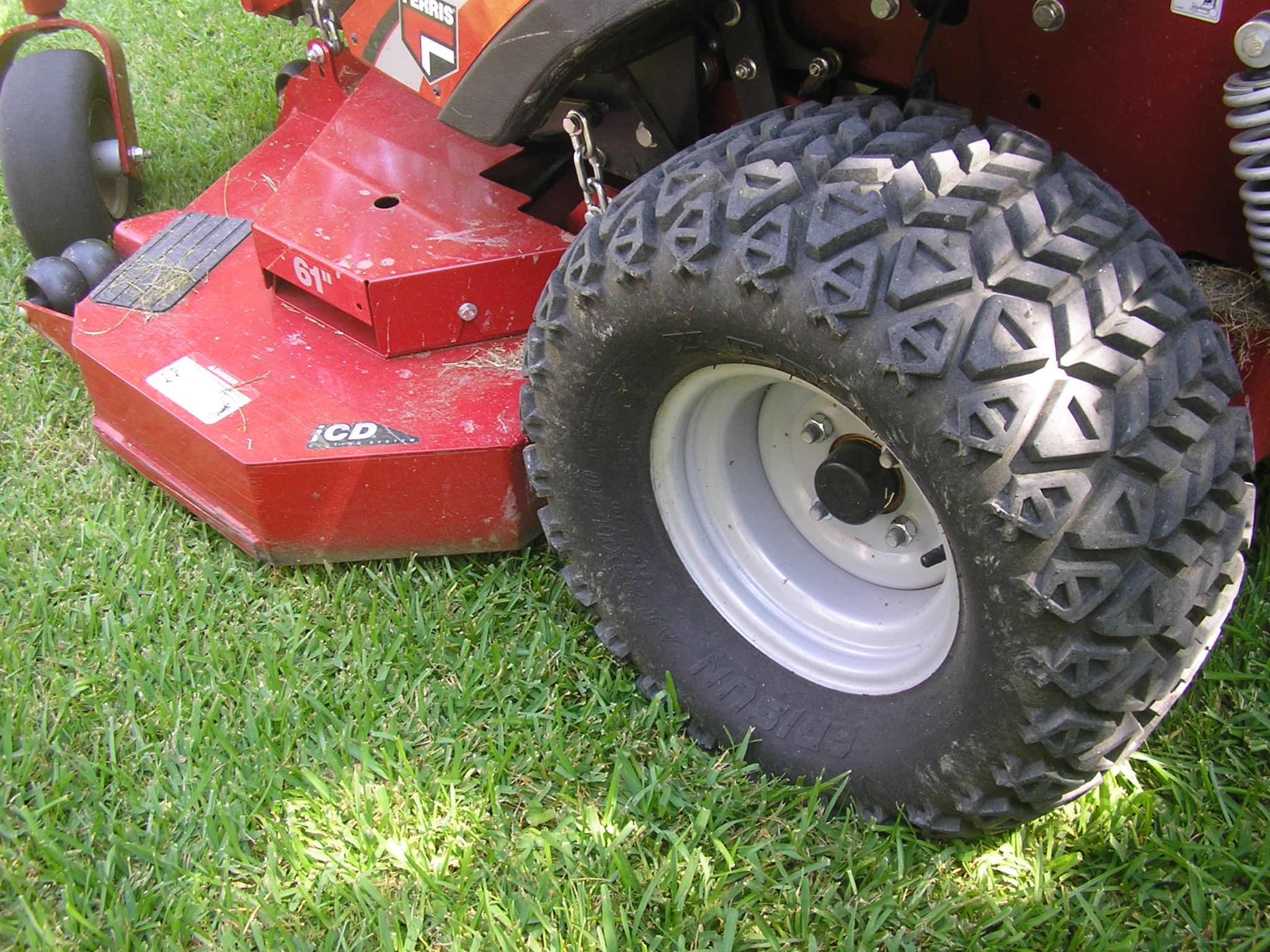

Sorry for the confusion. I was referring to the "Dimple Knobby" tires (I posted a couple of pages back) as "studs". The tire pressure of 5 psig is rated to 50 mph....I read somewhere. On my mowing speed, I figure if the tire will supoort "15 psig max to seat bead" when installing, they have proven themselves to tolerate what I listed at 10 psig and a few mph.
On bonnet, rephrase "canopy". Has nothing to do with traction, just helps to determine which mower I will be using on a hot, sunny day. Real comfortable on the ZT for sure.
The tires shown are a pair of Golf Cart tires that looked like they would have good traction but didn't...also shown are the OEM 10" wheels that I later replaced with 8" to get a larger balloon area with the studs I mentioned. They are now among their friends in my pile of "oops" tires that didn't cut it.

Thanks. Also good to know those particular tires don't work that great, as they are ones I was impressed by the look of. I think I first saw them on the Ventrac/Steiner machines, but of course those are 4WD.

Oh, and where did you get the 8" wheels from? That seems like a good idea too, for a larger contact patch. I aired down my stock 20x10-10s but it made little to no noticeable difference.

ebay has wheels too for a reasonable price. Type may be 8x7, 4x4 ...4 bolts, on 4" spacing if like my 4 bolt patterns on 3 ZTs I have (Ferris, DR Pro Z, Hustler Fastrak), with 8" tire ID like the rims to fit my 8" tires and the 7 is for tire to wheel mounting width. 7" works fine for the tires I bought when run at 10 psig or higher. Most ebay purchases are guaranteed for 90 days or something of the sort. Some sellers take returns. You don't have to put up with that poor service...........
Wheels for 8": 2) Golf Cart Go Kart Riding Lawn Mower RIM WHEEL 8x7 4/4 Silver Zero Offset
( 271801176126 )
Plug that into the ebay search box at the top of the ebay screen. Cost is $60 with free shipping for the pair. They have other wheels or just buy a tire that fits your current rim....they have other sizes.

Ebay. Post 4x4-8, 4 holes, 4" spacing (seems to be standard on ZT mowers which use the 4 bolts) 8 for 8" tire ID. Ran me about 60 bucks, free shipping for the pair. If you can't find anything get back and I'll look in my purchase history, pull it up and publish it.
Sidewall rigidity, and volume of air to absorb impact. Proven problems encountered in my search.
Lots of stiff sidewall tires out there where the application may require it. In a ZT you can stand squirming (defined as: With the mower sitting at rest, grabbing the ROPS bar and pushing hard crosswise to the direction of the mower and observing how far the mower moves with the tires fixed on the terrain), like you felt the first time you drove on radial tires when you had been running bias ply on your car-truck.....made a quick S turn of the steering wheel at 30 mph or such, car squirmed but tread maintained contact with the road.
