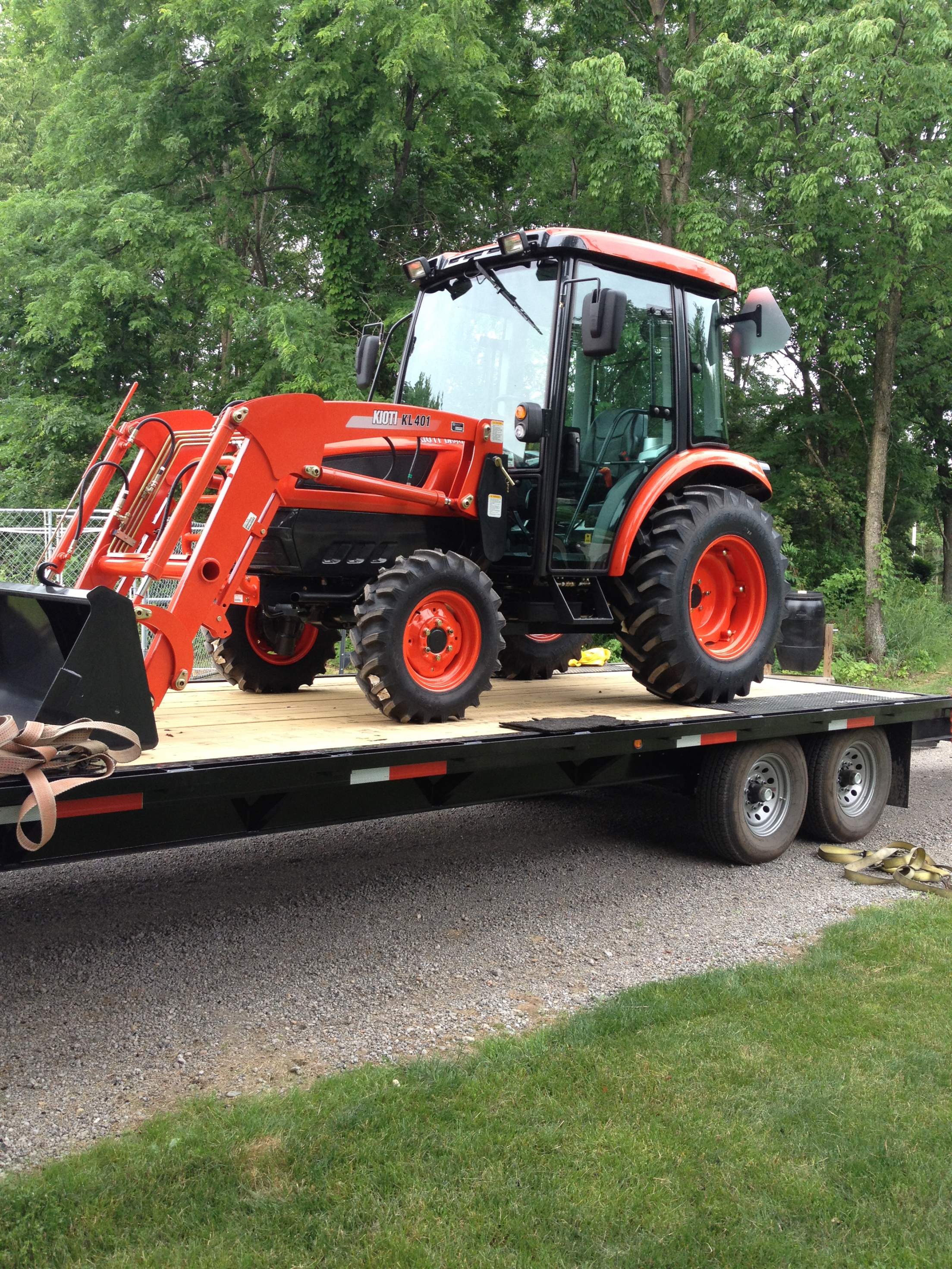

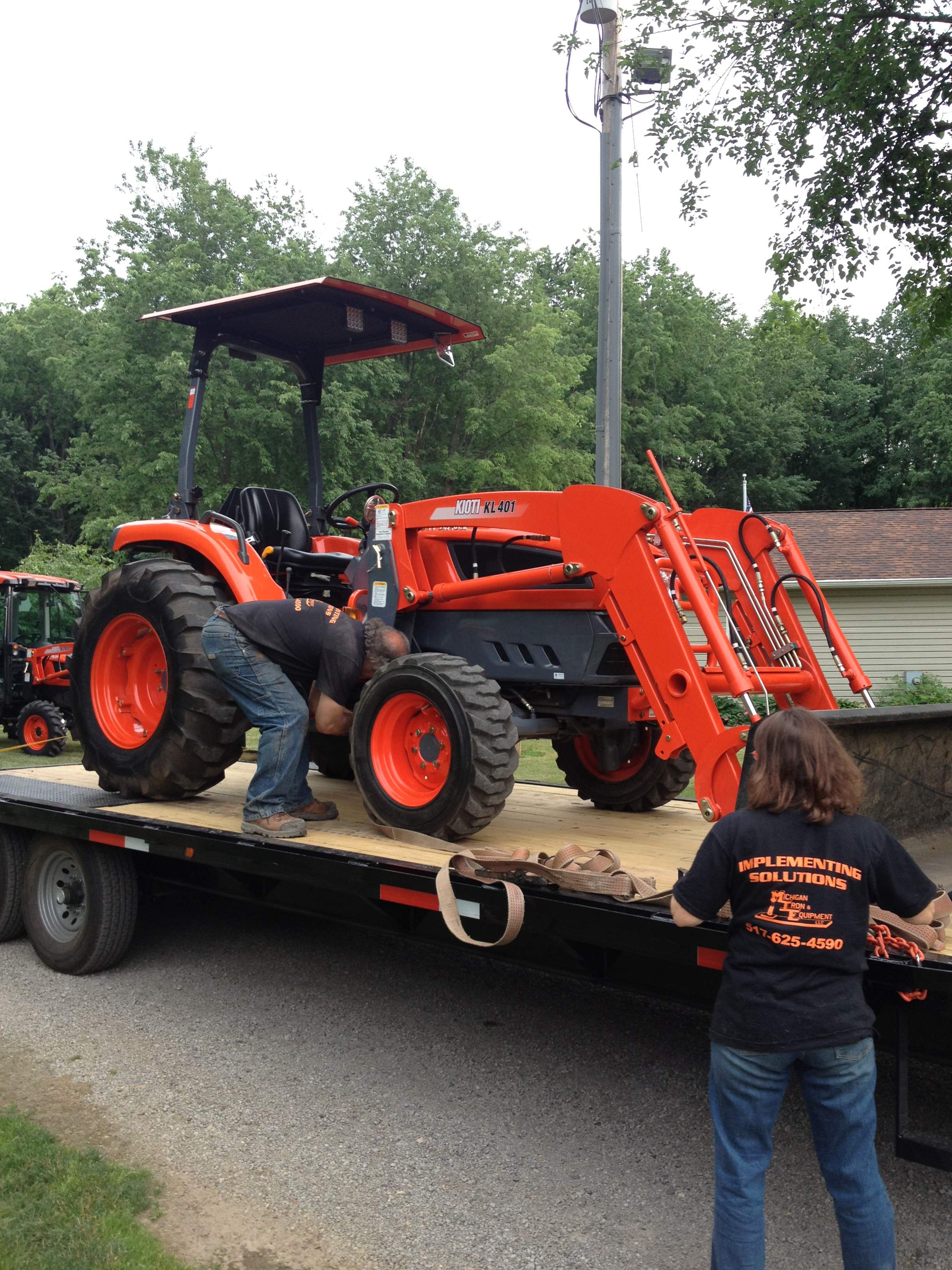

I was one of the shuttle shift (gear)folks when I bought my 2008 Kioti Dk40se .It only took me 4 years and total knee replacement surgery to figure out I needed a HST verses the gear shift.I bought my Cab 2012 Kioti DK40 se with HST.IMHO no comparsion,go with the HST.
