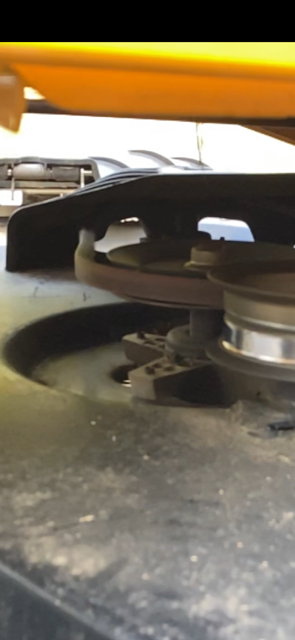

Here is a screen shot of close up of the video with medium throttle PTO engagement. You can see that the belt is well outside of the edges of the center pulley. It never looked like it would come off but when engaged at full throttle it did not jump nearly as far off the pulley as at medium throttle. I may try a video at low throttle next weekend to see what that looks like.
   / ZT deck belt frayed. #44
If you do well with engaging the deck at WOT, all's well. If not, it wouldn't difficult to fashion a guide at the center pulley. Might also do better with a bit more tension.This is a perfect example when dealing with a belt that jumps, to think of the belt being pushed through the pulley complex rather than being drawn through.
  • Good Post
Reactions: N80
   / ZT deck belt frayed. #45
Great investigation work.
I have no doubt that the tensioner pulley, the one with the spring, is that the spring fully extended.
You may also want to video record the action of the tensioner pulley.
   / ZT deck belt frayed. #46
I think sometimes on these larger decks, they build a greater range of motion in the tension spring to accommodate the longer belt and added guide pulleys. So a longer spring fits the bill to keep a more even tension. I didn't see the build model on this, but these usually have a metal "J" hook for the deck end of the spring like some others use. What is nice about them is it is quick and easy to pop another hole in the housing to put an extra inch or so of tension or better align the pull of the spring on the tensioner. I think the OP's hypothesis is correct that the belt hopped the center spindle pulley when things went south. I've looked at similar decks that seem to have a lot of slap after that pulley and the MFR parked a guide pulley directly on the input side of that pulley in an attempt to control the belt travel. So then they spec'd a hard start to control the belt. Combine that with the extra positioning pulleys that direct the belt back to and from the PTO clutch on a ZTR and there is a lot going on.

#47
There is indeed a lot going on and the first half a second or so looks like utter chaos. The whole deck jumps up. The tensioning spring/pulley bounces back and forth a long time before settling down. For anyone who is curious it is very easy to do. Just get someone to sit on the mower and do the engagement while you use 'slo-mo' on your cell phone. I did it with the mower on my trailer to minimize blowing/thrown debris. A clean patch of driveway would work just as well. It is an amazing thing to see.
