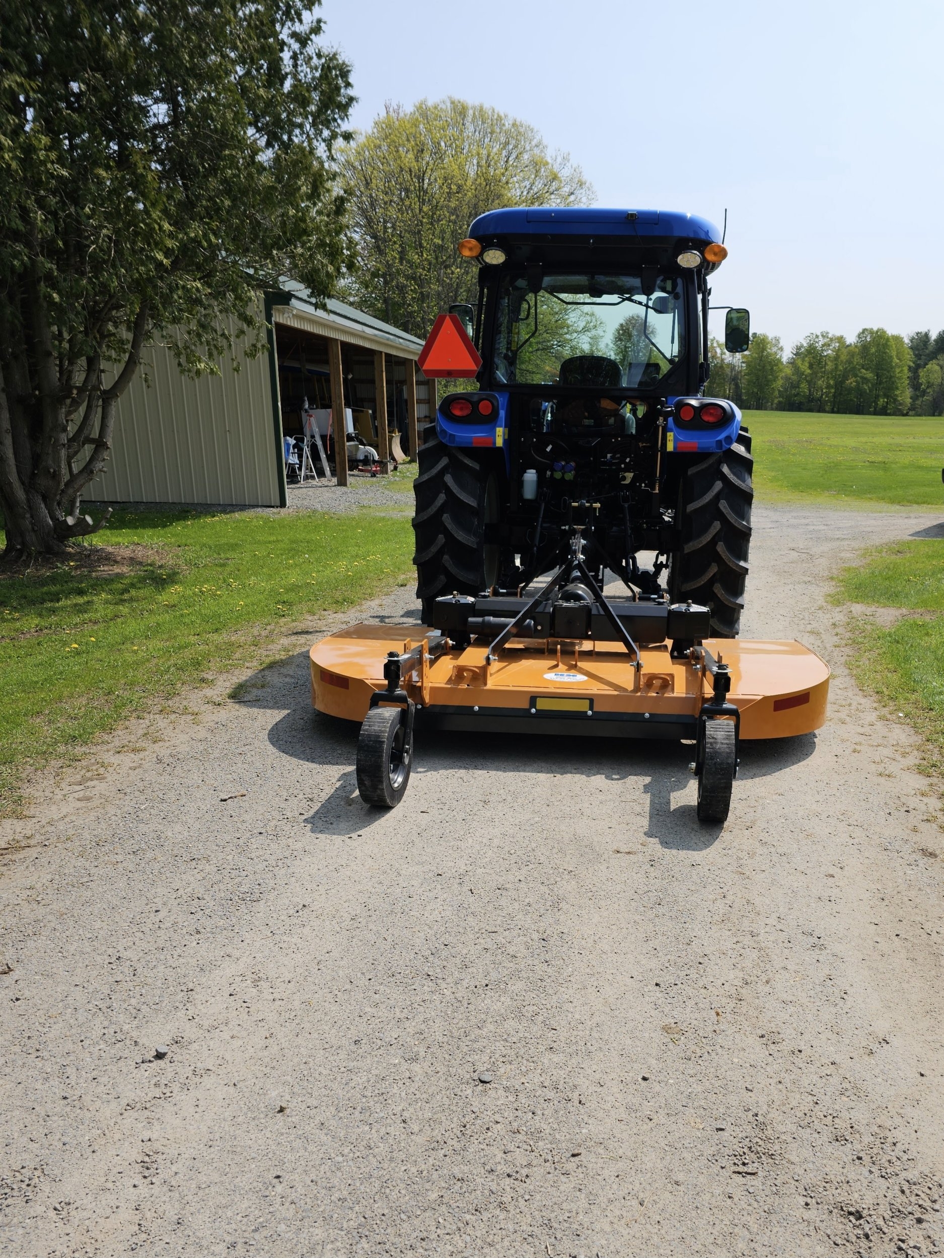

Well unfortunately today we just picked up the new bush hog that finally came in and my worst fears are realized. I tried slowing it down turning it off and Bam what a sound ridiculous I'm done with this BS the blades locked over each other so you have to get underneath and bang them apart or the machine will not start up without bouncing off the ground what were they thinking with this design it just doesn't make any sense that you would have that much mass just come to an instant stop and apparently there are no adjustments or any they'll tell me about ridiculous

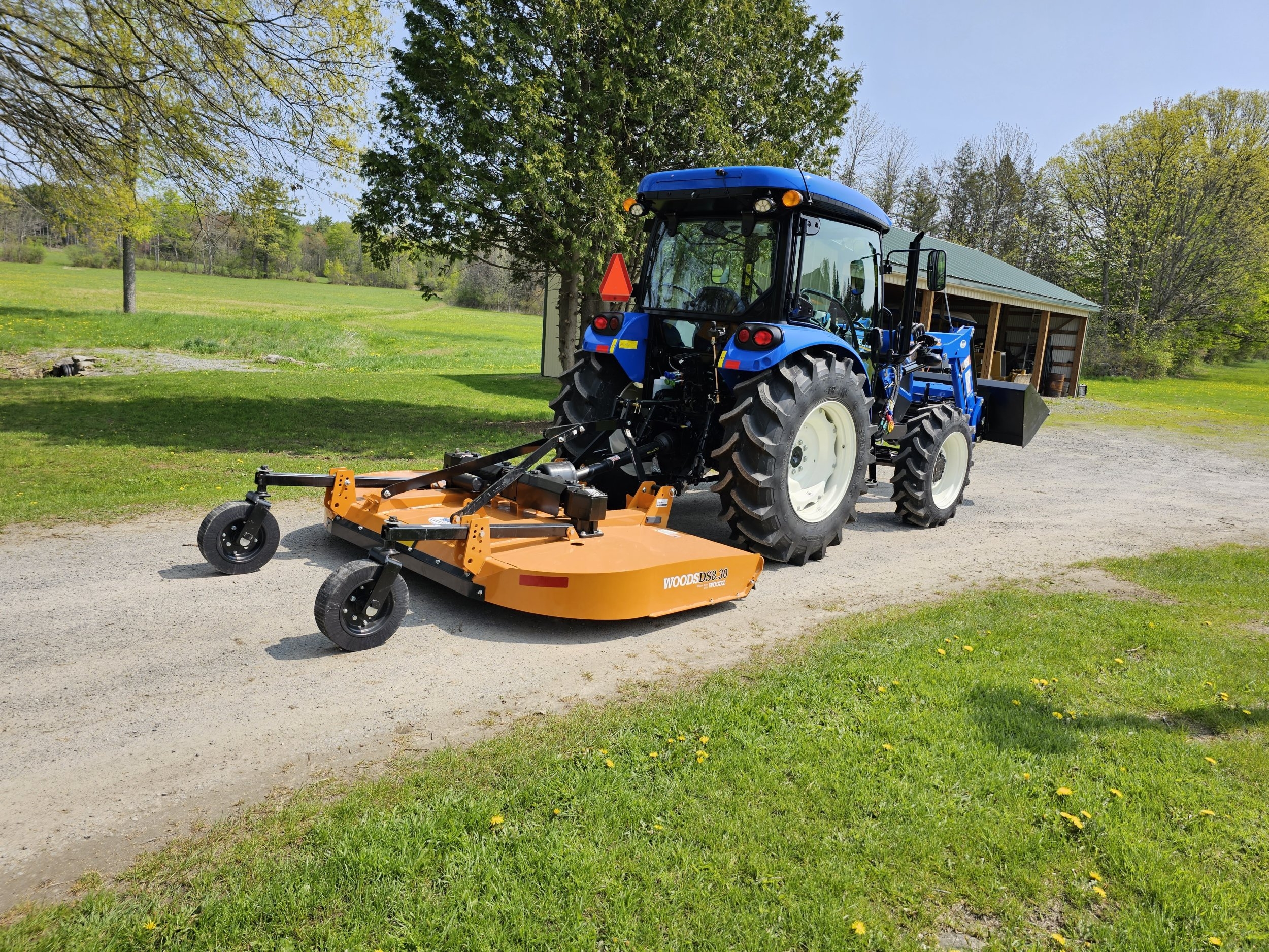

What a shame great tractor just no way to turn the PTO off safely ridiculous
