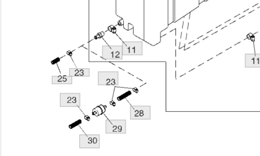

Hello all, my 5105 started surging at mid and high rpm's so I drained the fuel tank and purged it with about 5 gallons of new fuel, changed filter and had a short lived improvement. Now it surges to the point of shutting down even at low rpm's and is extremely hard to restart. I drained the filter today and primed by hand, very few bubbles were present but it was still a bear to get started. When it started at high rpm the exhaust smoke was white and then went black before it shut down, this was the first try. It took quite a few attempts to get it to stay running and I didn't run it very much above idle because I had a set of concrete steps to unload from my truck and get moved and I was afraid it would die if I offered it any fuel. One thing that I noticed that I don't remember happening before is that when it started the plunger on the priming pump would be sucked down as if the manual priming pump was under a vacuum, is this normal and I just haven't noticed it before?
I am going to dump the fuel again, replace the fuel filter and at the advice of another replace the fitting at the bottom of the fuel tank. If I remember right he told me the factory fitting is a check that is prone to sticking and impeding the flow of fuel. The advice came from a heavy equipment mechanic with a outfit I used to work for, he told me that they replaced the fitting on every John Deere tractor in the fleet the first time it came in for repair.
Is my thought process correct or should I be looking elsewhere?
Many Thanks,
Earl.
