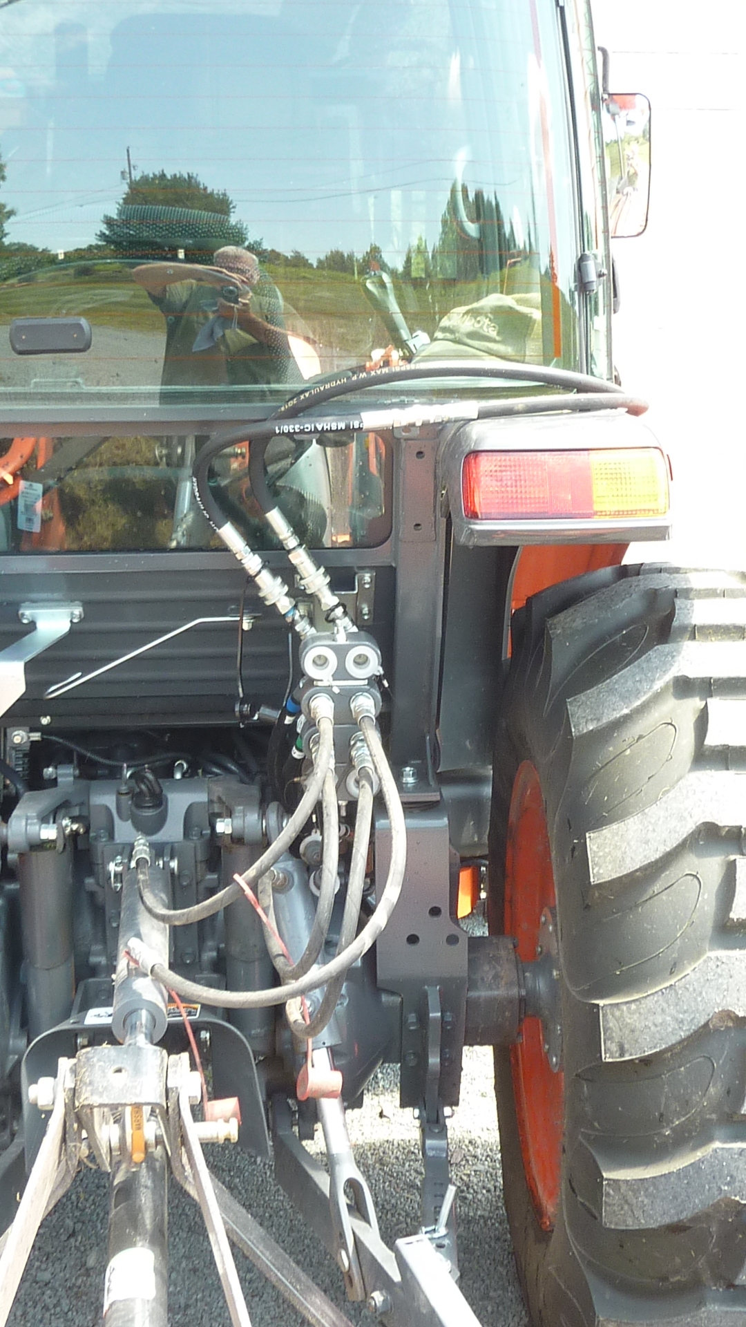

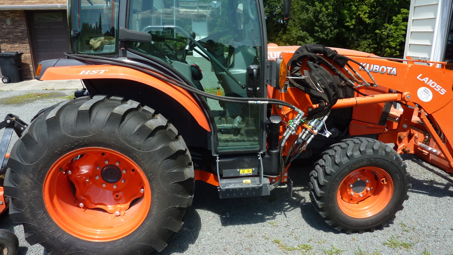

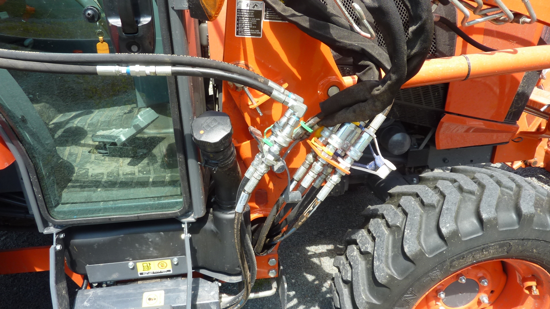

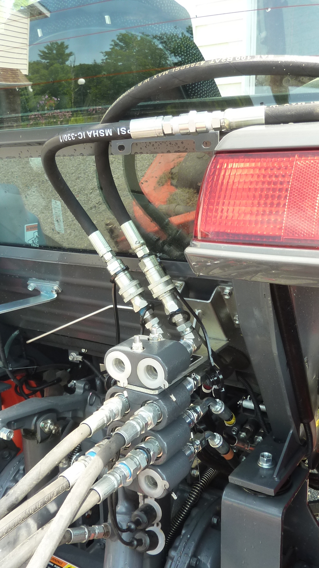

I have a 5145 with one set of factory installed rear hydraulic ports. The dealer connected the hydraulic hoses for the Grapple to these ports. It works great.
I now have a ditch bank flail mower. It came with a two lever control valve. One lever has a float function.
My question is; where should I connect to the tractor hydraulic system to get hydraulic fluid to and from the control valve?
I don't want to loose the grapple or loader function while I am operating the flail mower.
Thanks for any help

You have no choice but to use those ports unless you pony up the money for another valve or use a splitter
You can not simply T into the lines on an open center tractor. If you T into the remote connection lines both the grapple and mower will function at the same time unless you buy a splitter but they come with their own set of issues

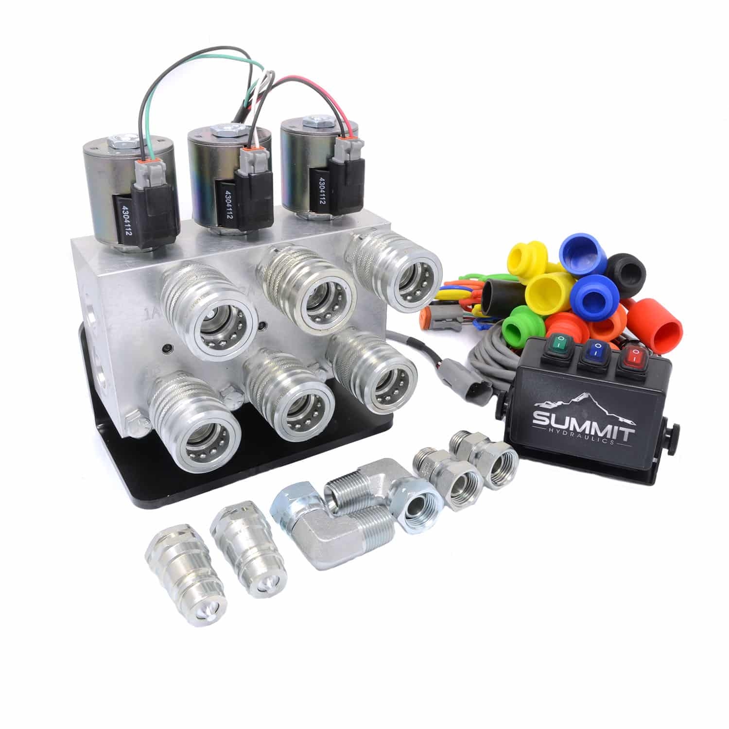

there are two options that i know of:
1. the factory 2nd remote kit.
2. a diverter block where you can have as many outlets as you have space for but only use 1 at a time. the stock control lever controls the remote and you have a switch to select which remote outlet you want to use.
you can also install a W.R. Long 3rd function kit and release the rear remote from operating the 3rd function.

One option would be adding a diverter valve to your rear remote, run one pair of the outlets to the grapple and on the other pair select one port to supply the valve on your flail mower, take the return from that valve directly to the tractor reservoir. Plug the other diverter port.
Depending on how you plumb and wire the diverter when the remote valve is operated and the diverter is not energized it could run your grapple as it does now. With the diverter energized and the remote locked/tied on the flow would pass through the mowers valve waiting for your valve operations on that valve.
