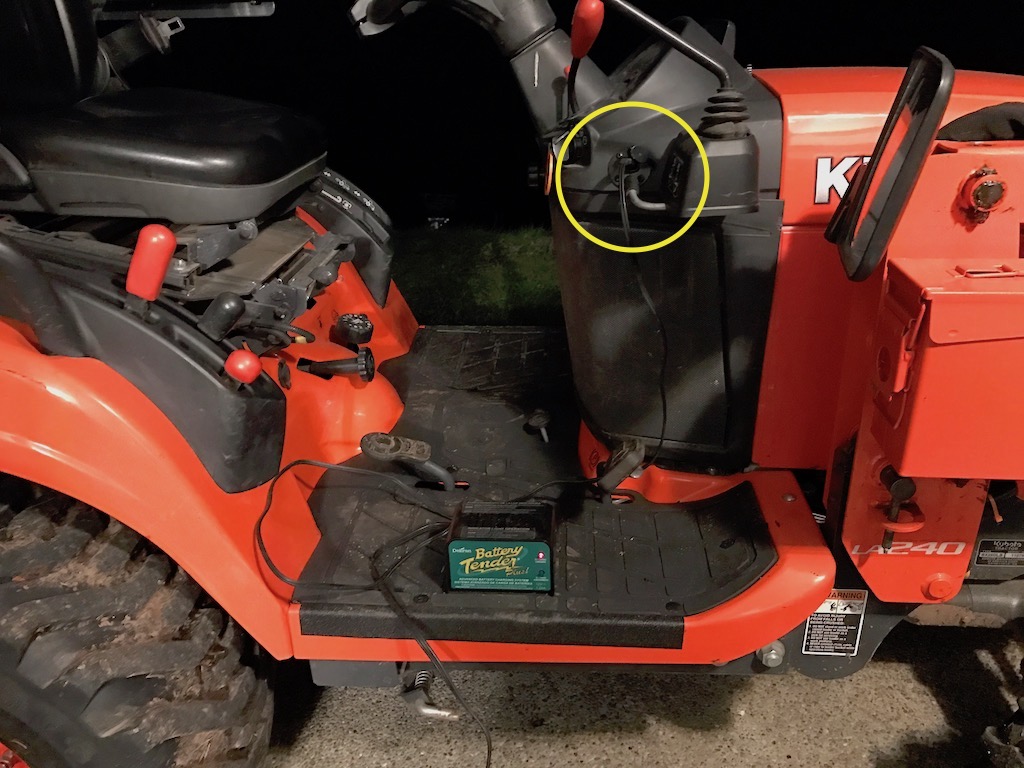

My BX-2350 gets used sporadically in the winter, and if if it's been too long and too cold, the battery needs a charge before I can use the tractor. Of course, it would have been too easy for them to have the battery in a spot where you can simply hook up the charger to it, nope, you've got to remove a rubber bungie cord, yank the battery out and put it on the deck in order to do this.
Has anybody come up with an easier way to charge the battery without having to do that? I'm tempted to somehow mount something that extends from the battery cable clamps to a terminal block with a cover so that I can do this conveniently, but I also want to make sure that would not cause some unexpected badness and no sense reinventing the wheel in case somebody has a better idea, thanks!

This idea I think I got from a 4shorts mod. Simply add a quick disconnect on your 'dash'. I can't find the source online at the moment but I'm sure someone will chime in.

I installed a pig tail off the battery. The connection extends out from under the grill and is where I connect my Deltron battery maintainer. I keep the tractor battery on the maintainer all winter.
