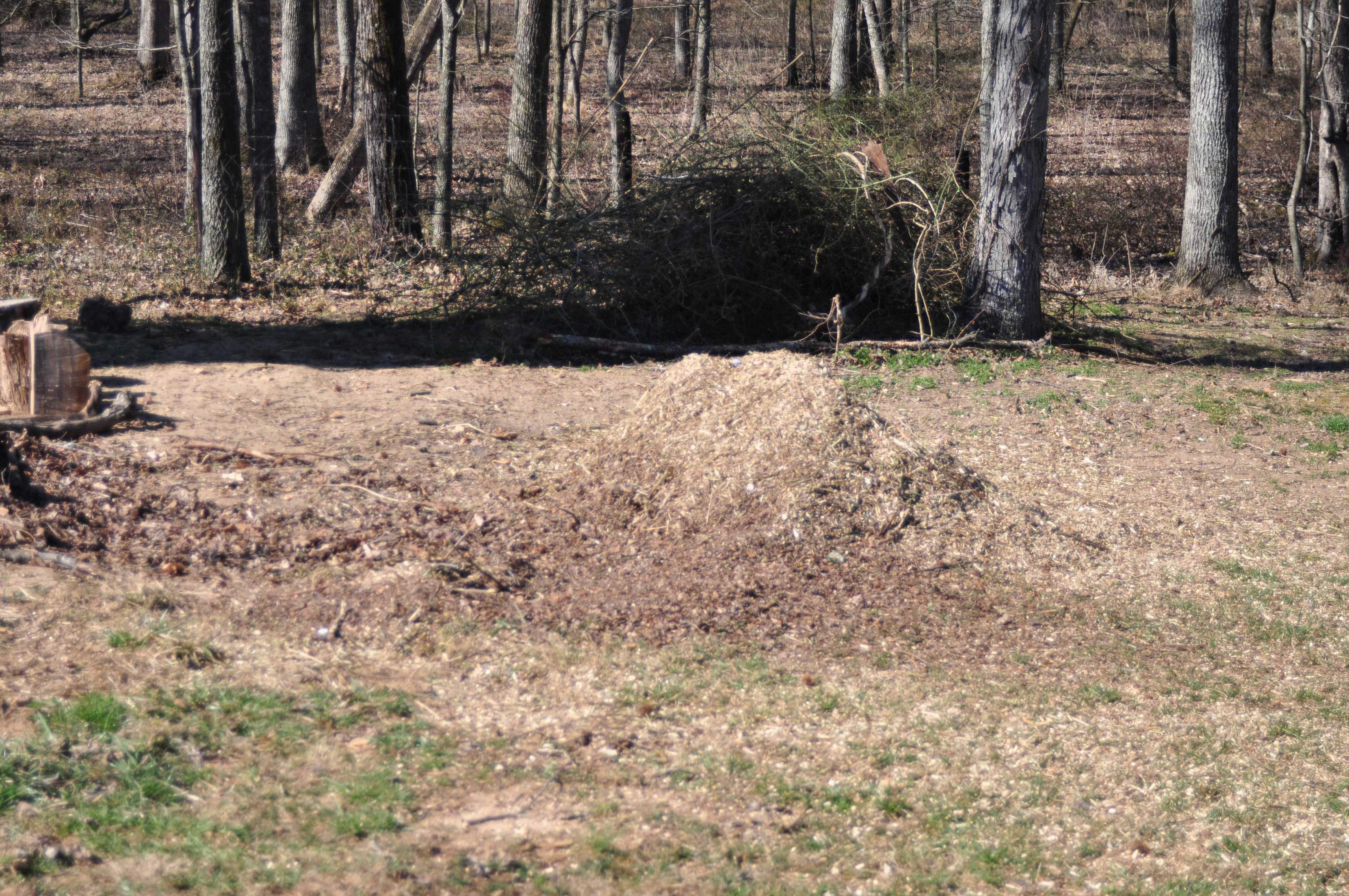

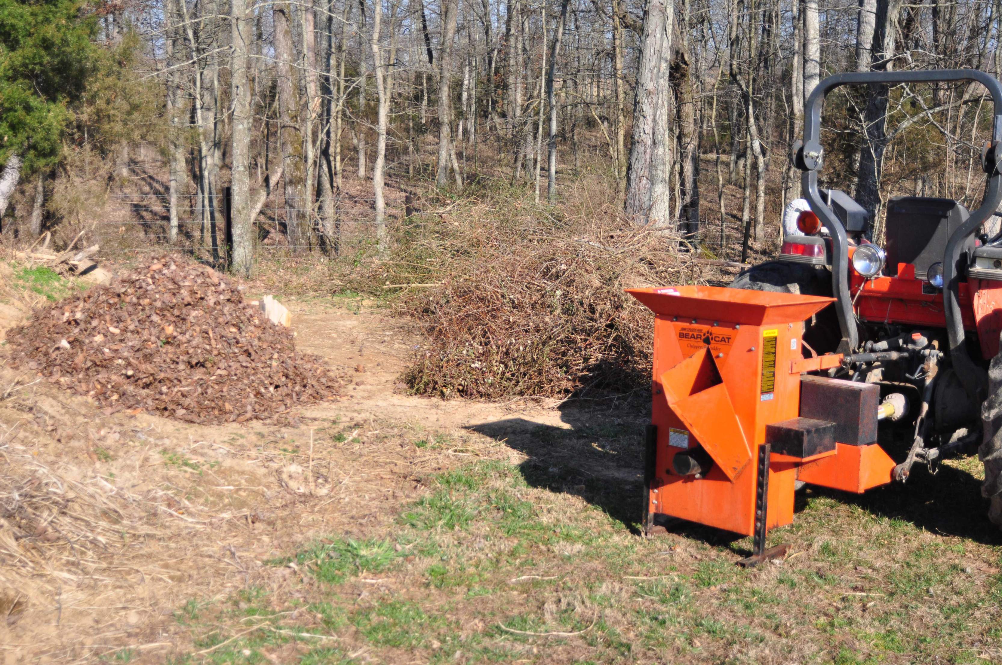

Had a chance to use the chipper today - wow! I'm impressed. The tractor ran it with power to spare - it barely lost rpm even on big hard stuff. I ran a few limbs that were at least 4" and hard and dry. They needed a little pushing through, but it chipped them right up. I found that pretty much if it will fit in the chipper, it'll chip it, period.
I do think the blades need sharpened though. I felt the edges and they had a few nicks in them. Does anyone know if they are reversible?
I'm not as impressed with the shredder, as the pieces that came out were rather big. I think I'll try getting some steel grate and making a smaller screen for it - seems like that would keep the big stuff in there and let it get shredded more finely.
Anyway, thanks again for all the suggestions and advice everyone!

Yes, the blades are reversible. If you need advice on how to take the chipper apart to get to the blades just ask.
Here is the manual: (Darn, too big to upload. Got it from the Crary Bearcat site. If you PM me your e-mail address I'll try to send it.)
Meanwhile, the sharpening instructions are small enough to upload.
