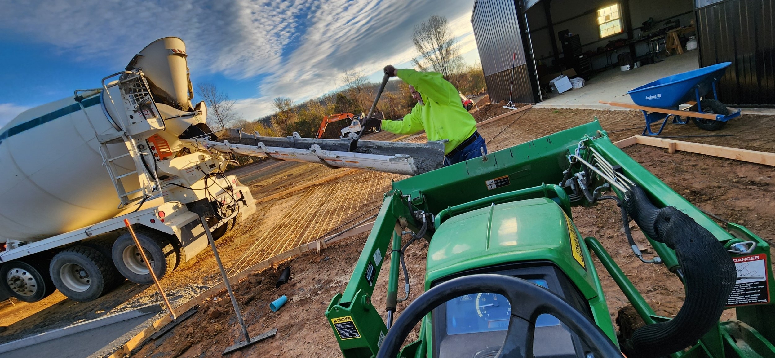

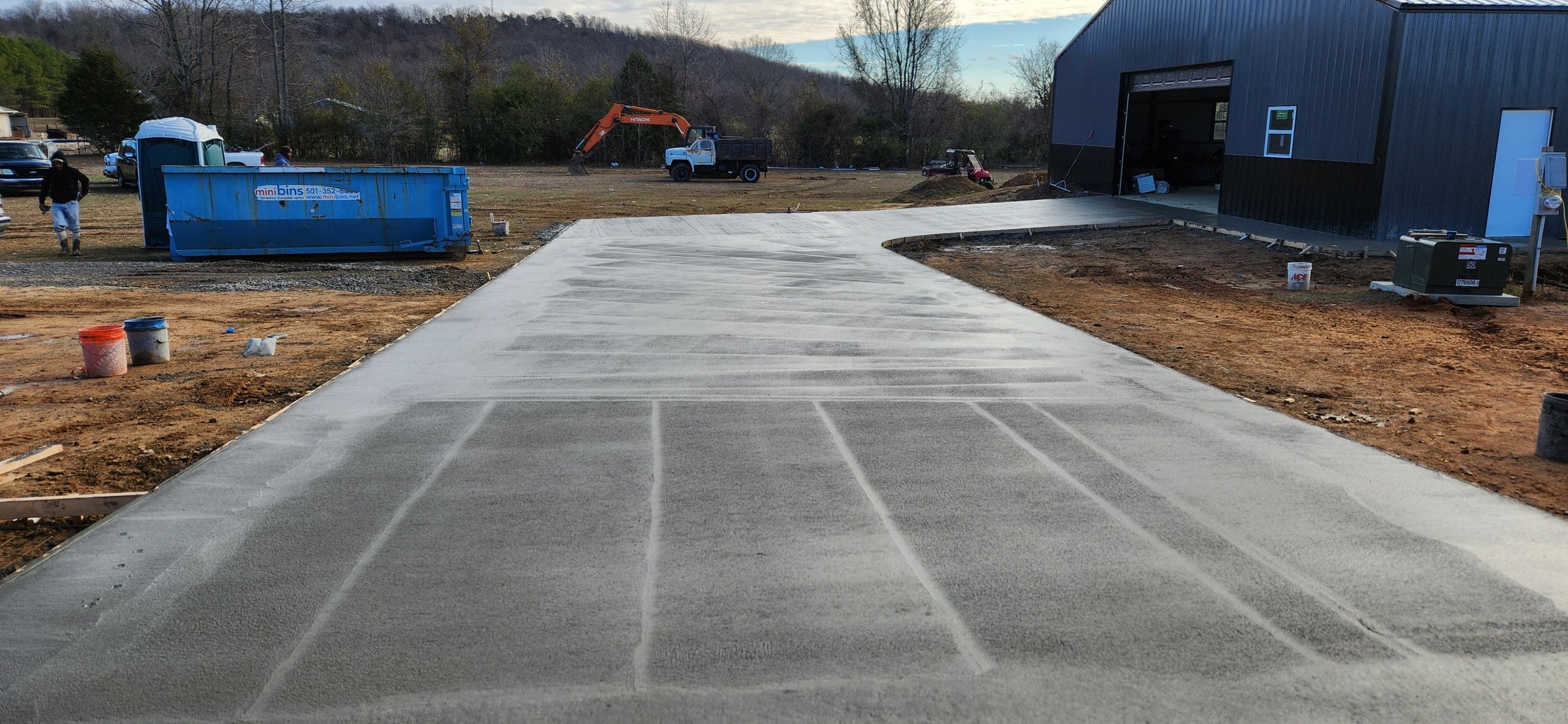

I eagle eyed the whole pour. They pulled up the vast majority of it.

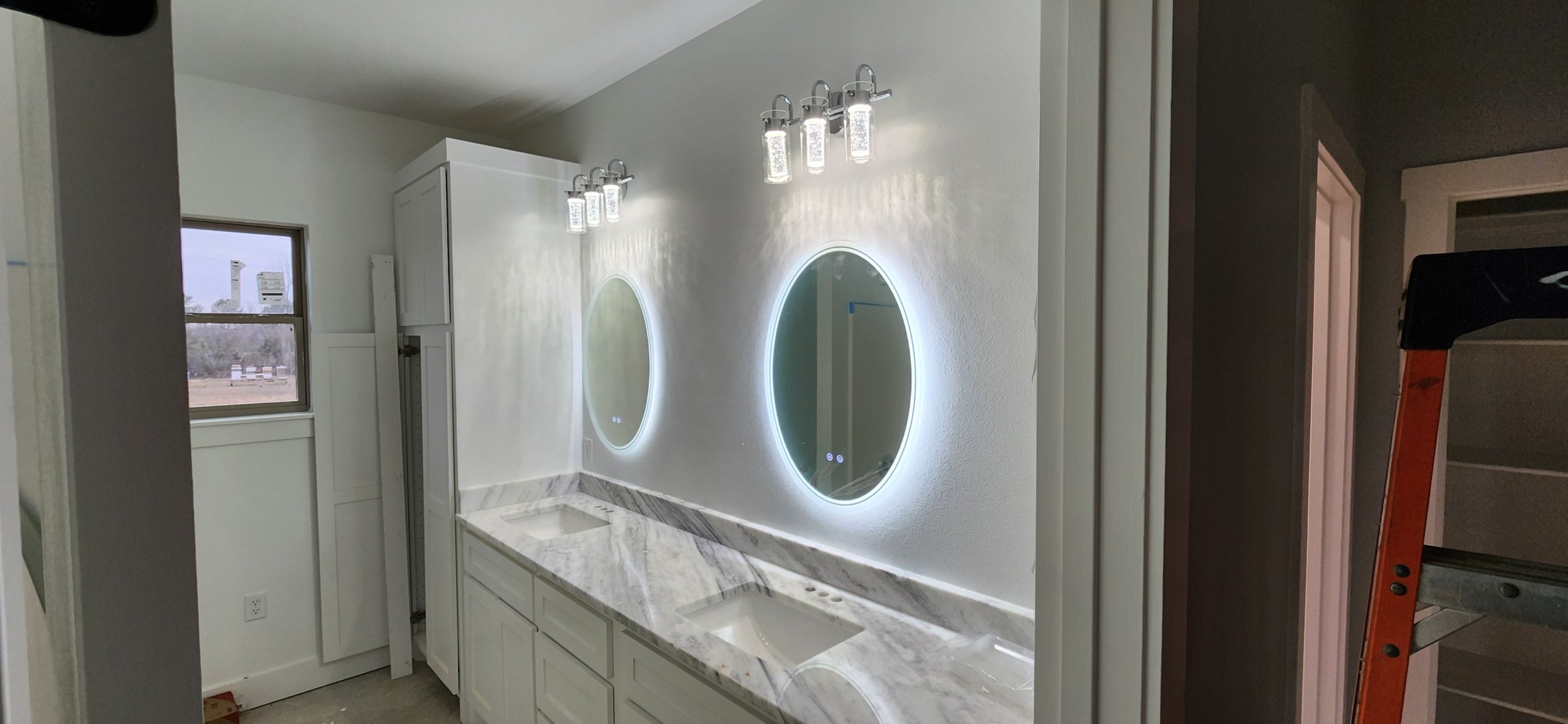

The girls' bathroom is about done! Also got the house trailer sold today! Really nice couple came by and gave a deposit. No problem with us staying until the house is ready and knows it needs to move quick when we get out. It's gotta be off the property before we can close on the mortgage.

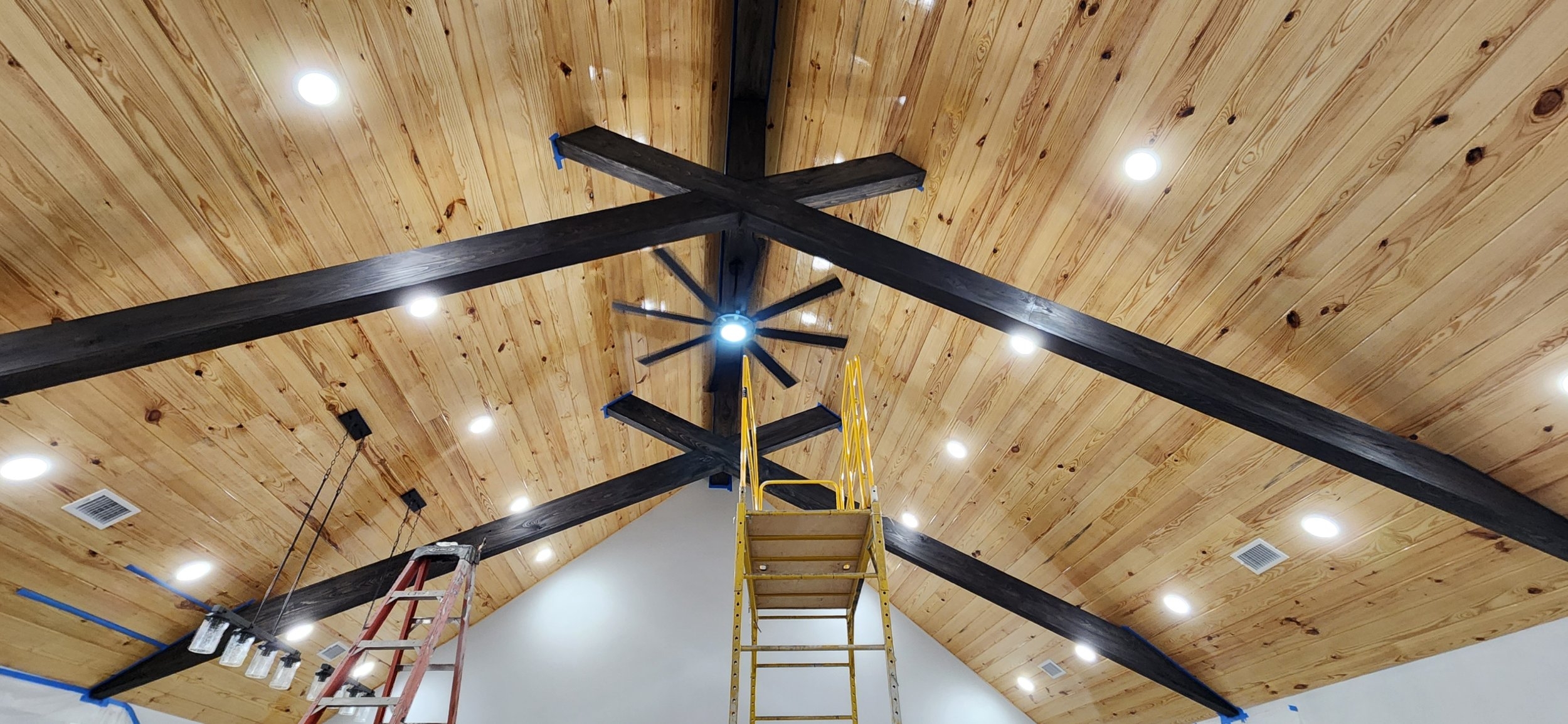

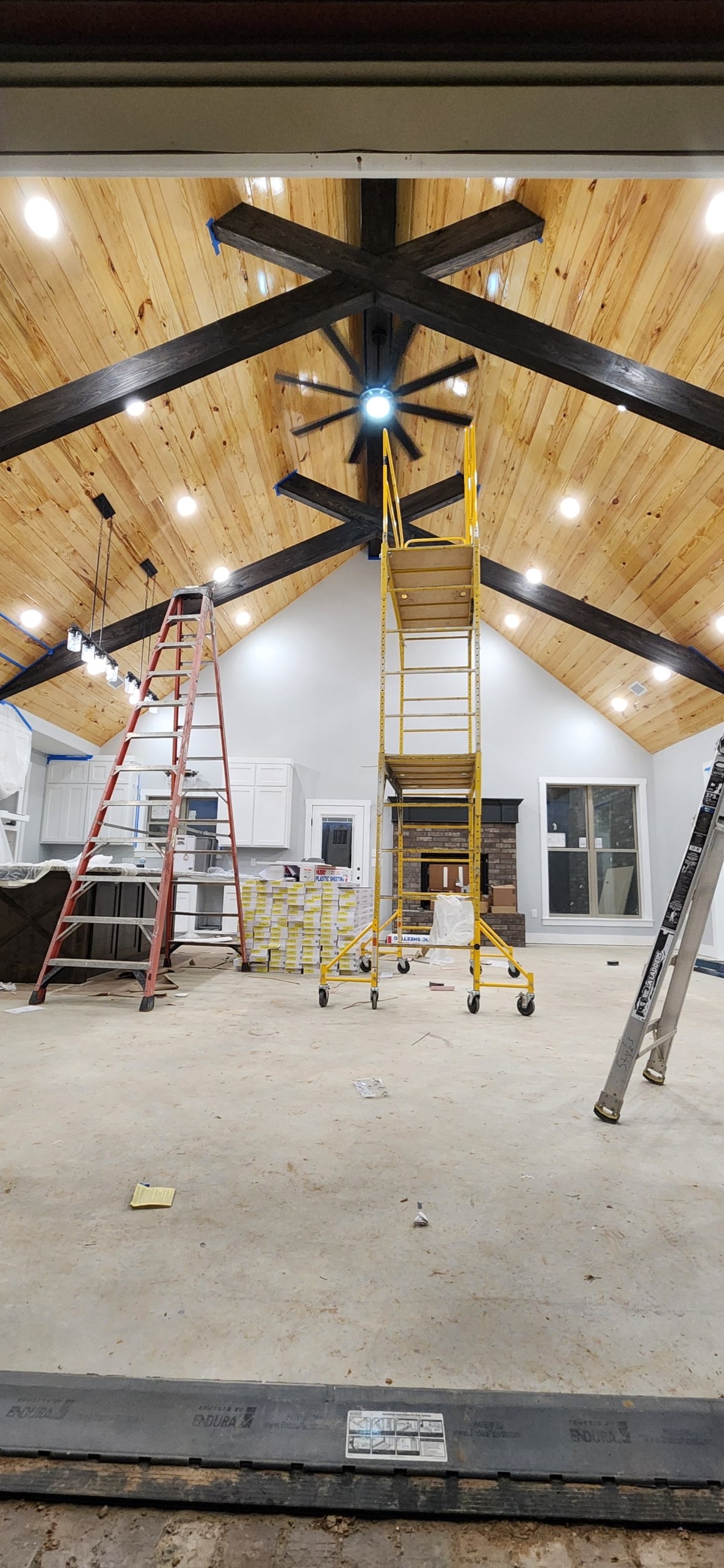

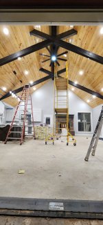

Those beams really set off the wood on you ceiling!!! Very nice.
How high up is your fan? On the box, there should be a diagram showing where the fan needs to be from the floor to be effective. Too high and you don't get any air movement.
   / House Build 2023
#317
The fan is REALLY high. The peak of the vault is about 22'. I got the biggest fan that I could fit between the trusses for a reasonable price. It's 80" dia. It only came with a 2' down rod so I had the center beam made 10"x10" so it would get the blades far enough down to clear the vault by about 8". I would have liked to have a bigger one farther down but this one was the best I could do without having to spend upwards of $2,000. It's supposed to move almost 10,000 CFM of air. I'm hoping it's enough to keep the air stirred up so I don't have hot and cold layers.
