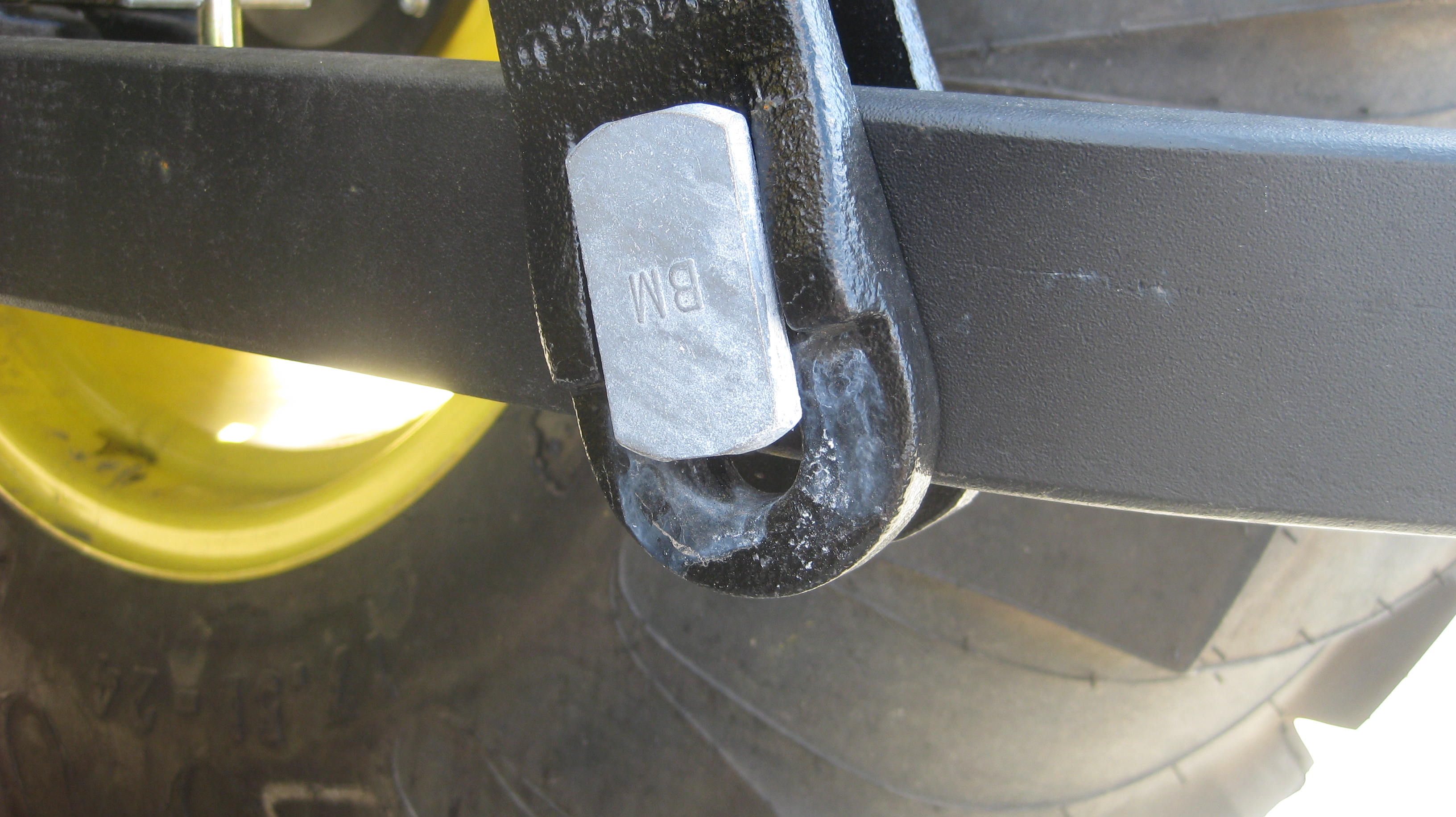

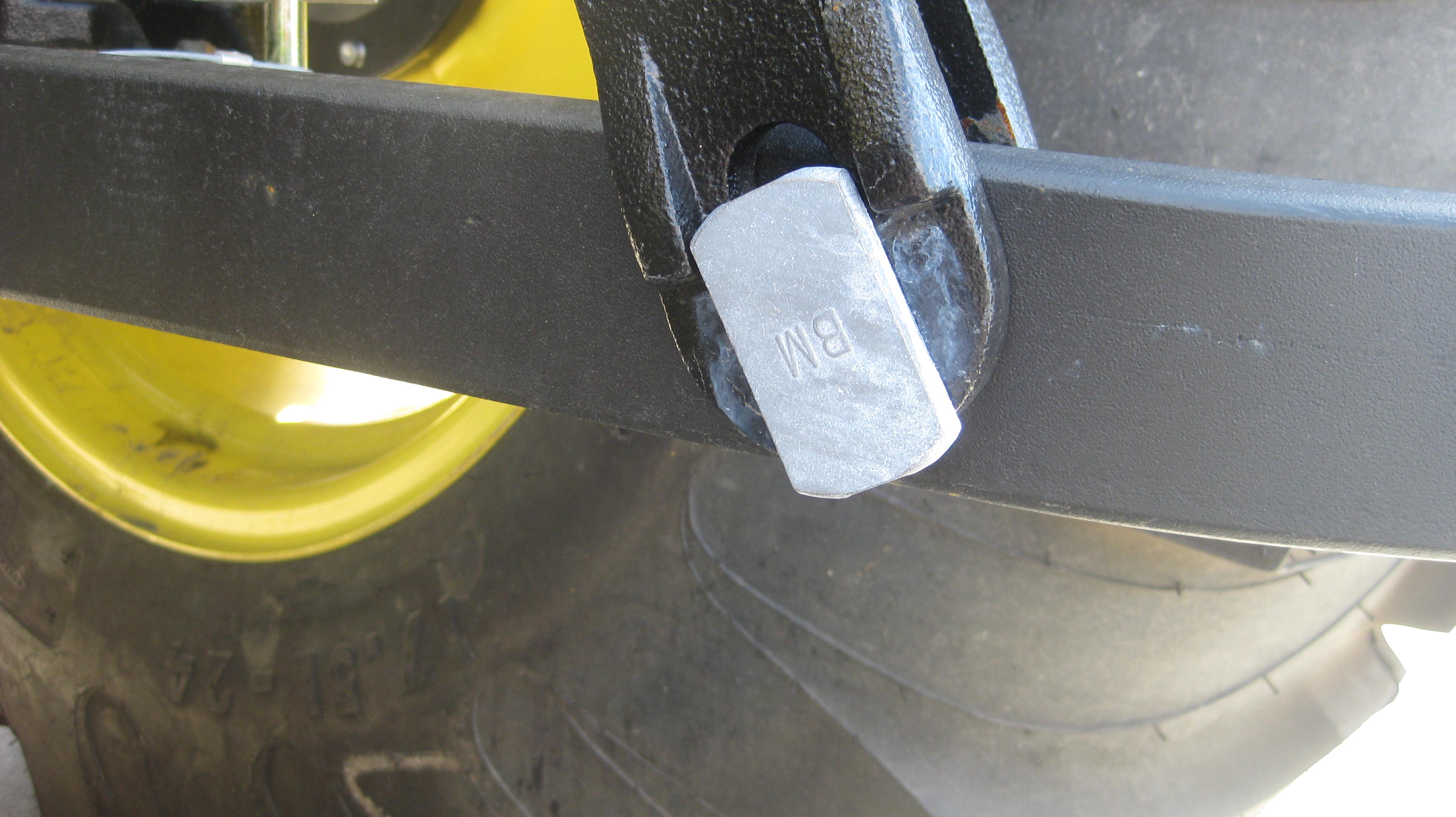

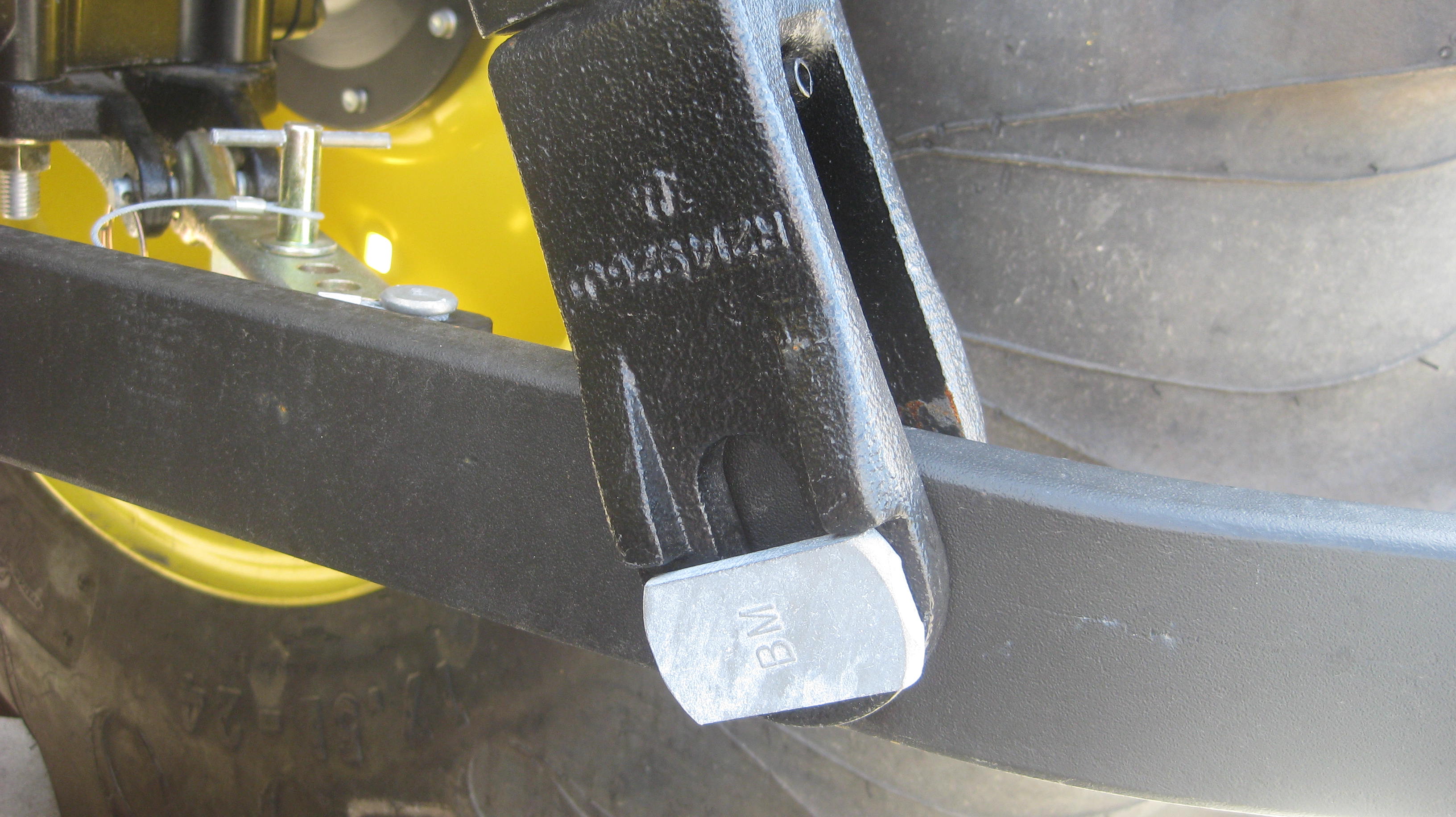

As far as having independent draft link movement, while you tractor may not have it many tractors do. John Deere tractors first come to mind providing a small amount. Pictures give an idea of what is on some tractors. Pictures are of a 40xx series JD side link-draft arm connection.
As far as having a hydraulic side link with the float mode feature, this does not work well for rough mower use, typically only with implements that make full width ground contact, or a finish mower with corner wheels.

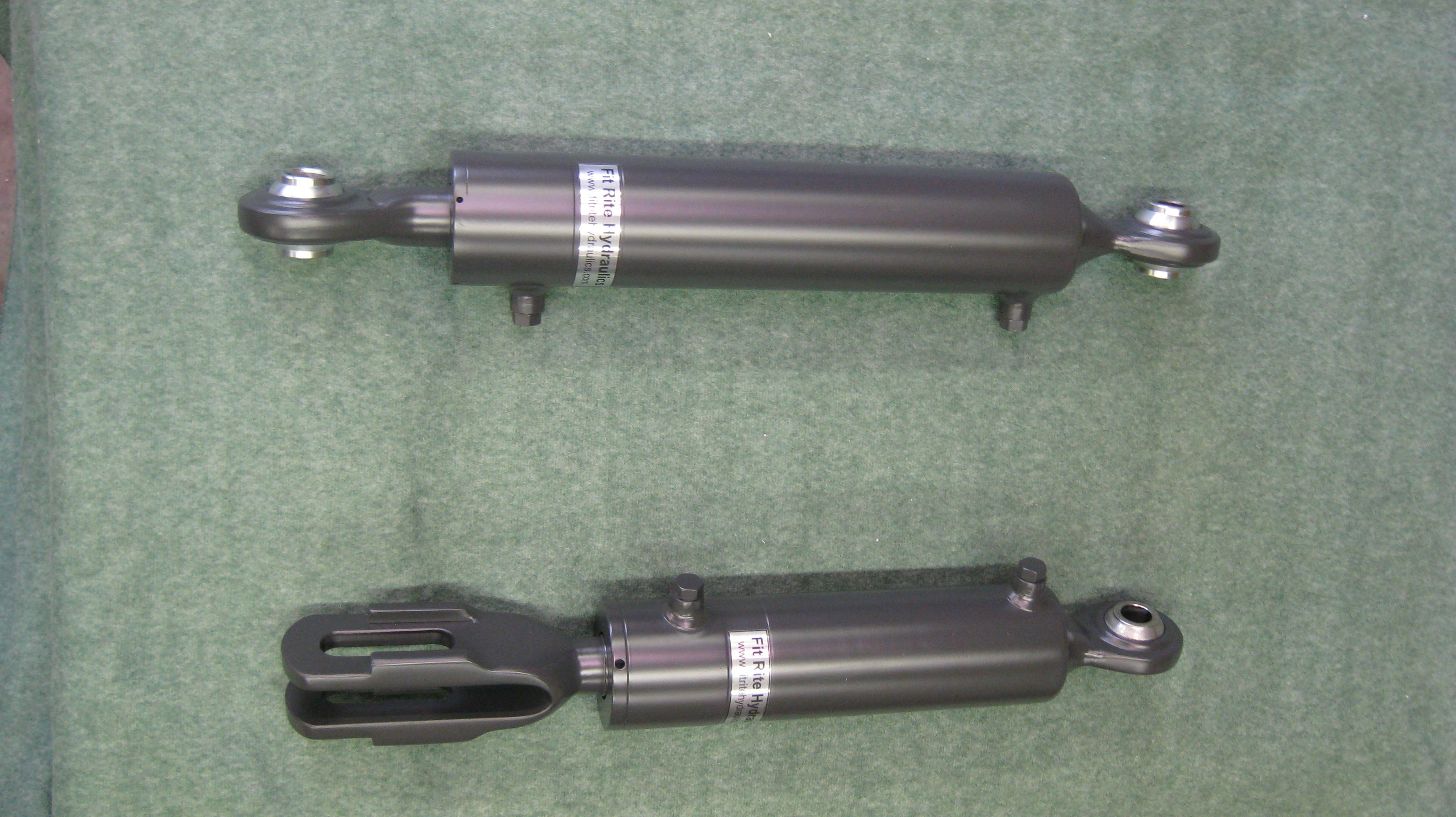

I built my hydraulic side link. Wanted to retain that float ability. That was the most technical part of the build. :)
   / Hydrauluc top & tilt kit #28
You needed the lower unit pictured . Actually both units to not have to build anything. ;)
