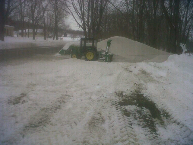

Whatever you do get hydrostatic transmission. Here is my dads front lawn. He used my tractor.32hp 72" rear mount. Save money buy rear and invest in soft cab. I too live in snowbelt south buffalo.
