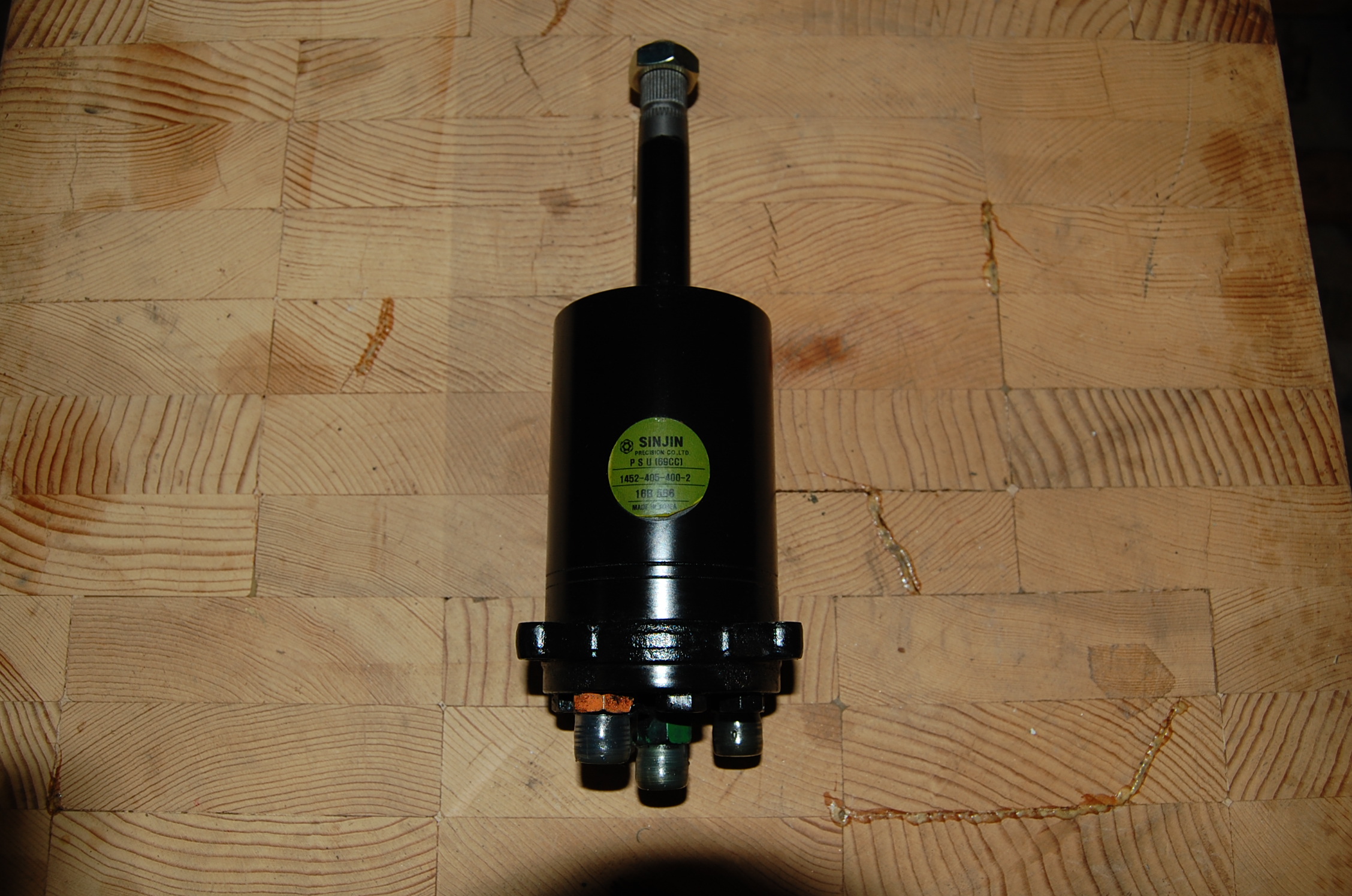

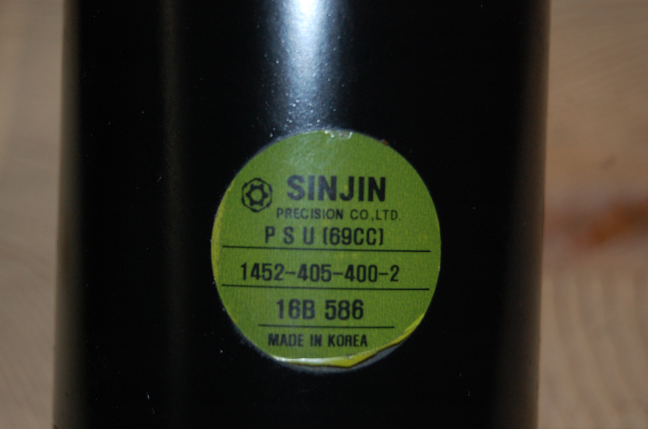

HSU (2).JPGHSU (1).JPG Here's a couple of photos of the "valve", hope this helps.

Hi DirtHauler. I found the SINJIN website, www.sjpsu.com/ and sent off a letter, asking for a repair kit or the if I could buy a new valve. SINJIN calls these a Rear Port Power Steering Unit. They show one, similar to the pictures you sent, but not much info. No rebuild parts were listed. I ran these numbers on Google, but nothing shows up, other than what I already found on the SINJIN website. I will keep looking on the web. If I receive an email from SINJIN, I'll post it. Thanks for helping.

I saw on the SINJIN website (power steering products), TYM was one of their customers, not Mahindra. Also Kubota, Millat Tractors Limited (they make Massey Ferguson smaller tractors) and others I have never heard of. Mahindra wasn't listed as a customer, which would be correct, if TYM builds the Mahindra 2555 and other models. I found a TYM dealer that is close to where I live. I just called the TYM dealer and they use the same part number as Mahindra (14524054002), which is the newer part number for the Rear Port Power Steering Unit. She told me she would call TYM and see if there is a seal kit for these. I'll post new info when I get it.
