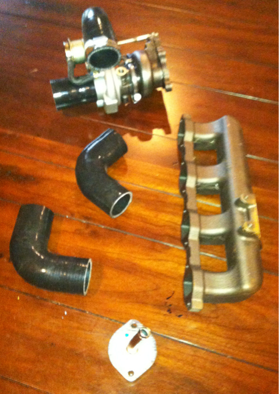

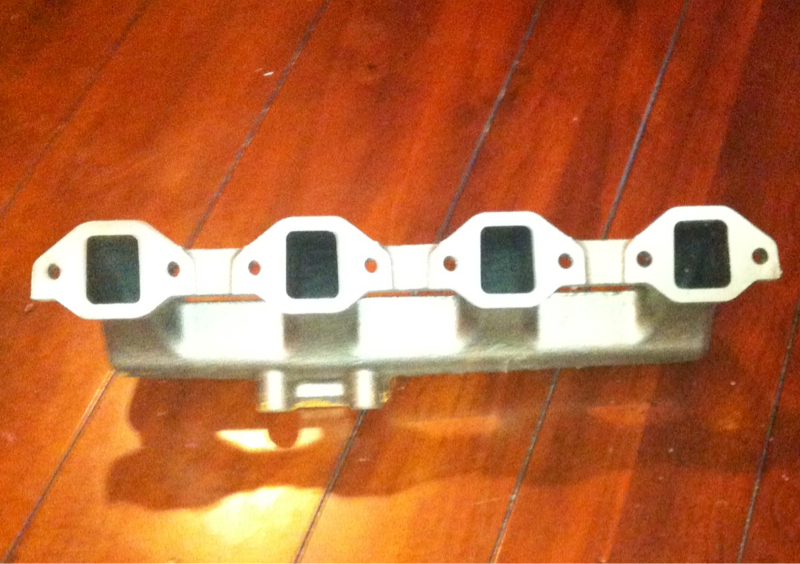

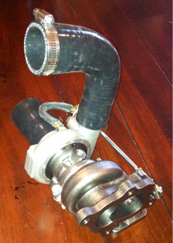

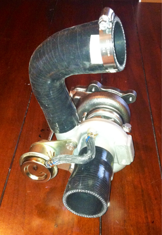

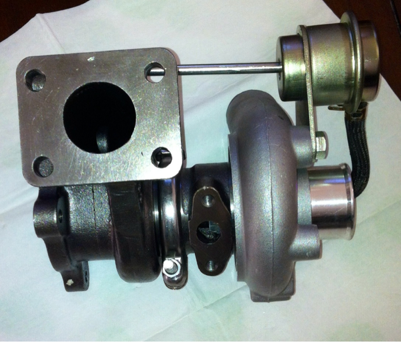

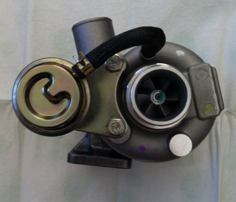

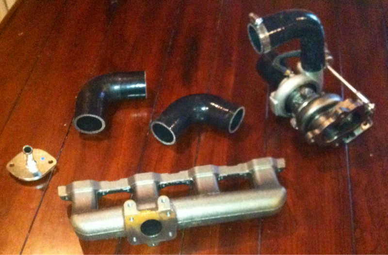

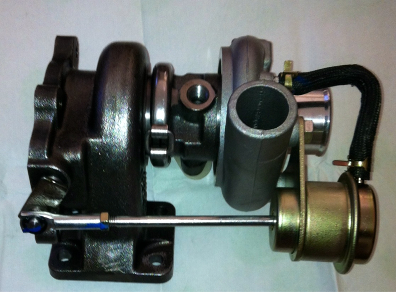

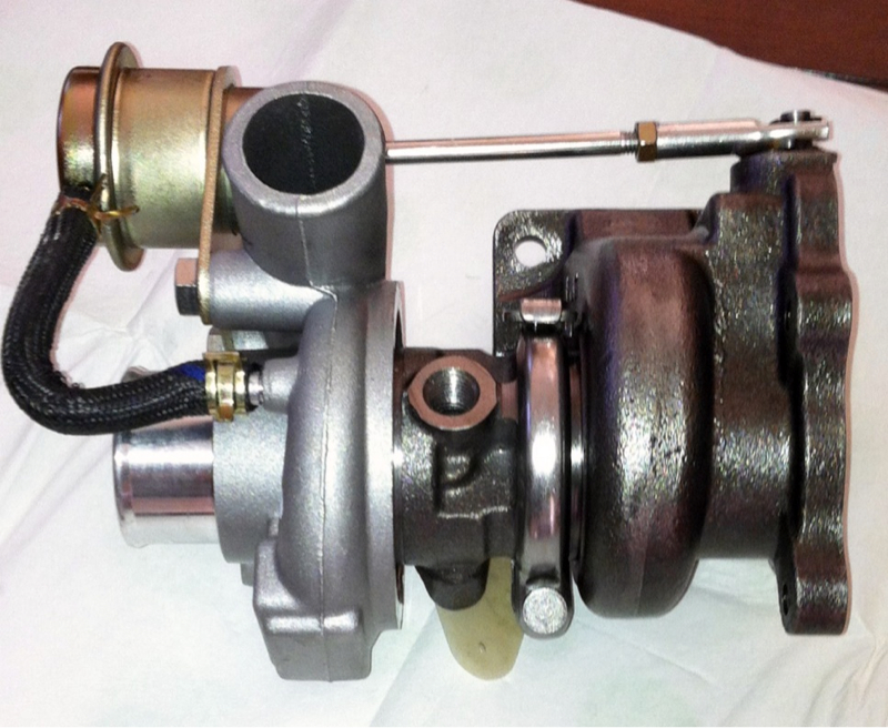

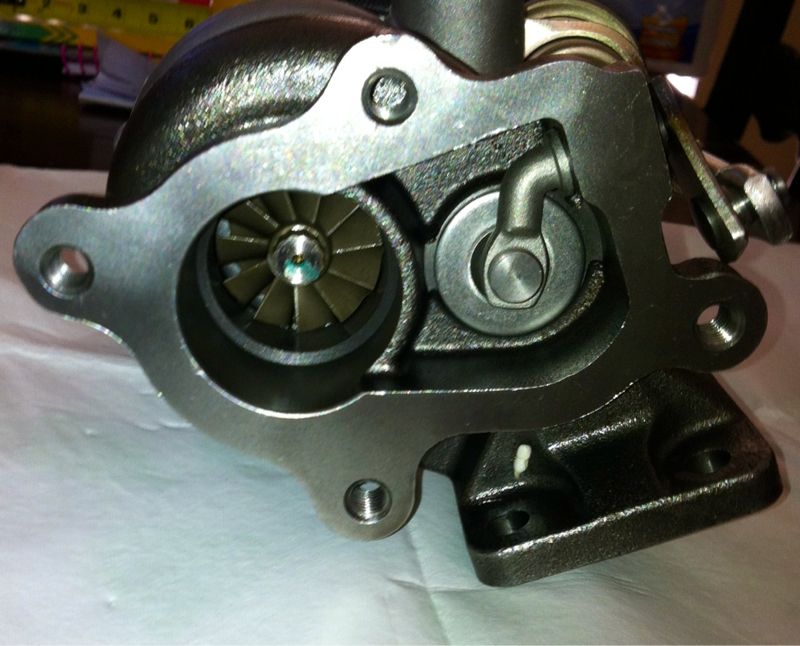

I've been looking at doing this for some time now. So I'm going to install a turbo on my tractor. I have bought the turbo and now I'm waiting on my parts from Caterpillar to come in. I'll post more pictures as I go along. Ask any questions. Enjoy.

What is the brand and model of the turbo? What is the displacement of the engine you're installing it on? Do you plan on adjusting the maximum fuel to the engine (altering the injection pump)? Have fun, mine was (is).

It's a TD03-07T Mitsubishi turbo. Part# 49131-02531. This is the correct turbo for this engine and fulling set up. Yes, I'll post more pictures as I progress with the build. Still waiting on some parts from Caterpillar to have all the complete parts I need.

Just a quick update. My parts from Caterpillar have been slowly coming in. I have most everything that I need now but, I'm waiting on the oil feed line to the turbo from Cat. Their saying it will mid December before I get it. Here are just a few pics of the parts but not all are from Cat that I've received. Any questions please ask.

Yes, my tractor has the Mitsubishi S4Q2 engine in it. Once I'm done with it I'll try a post all the part numbers and where I bought everything from.

I've worked on rotating equipment for a good bit of time now and so I've learned about engines gas and diesel along with manual and automatic transmissions. If man can build it, then man can fix it or make it better. I'm not a low budget or red neck builder. I pay very close attention to specs and measurements. The reason I have been saying I'm buying parts from Caterpillar is because Caterpillar is using the same Mitsubishi S4Q2-T engine in their 305C CR mini excavator as did Montana did in their 4940 series tractors but, not the turbo version of the S4Q2 engine. So, I'm getting parts from Caterpillar and other suppliers to complete my project.
