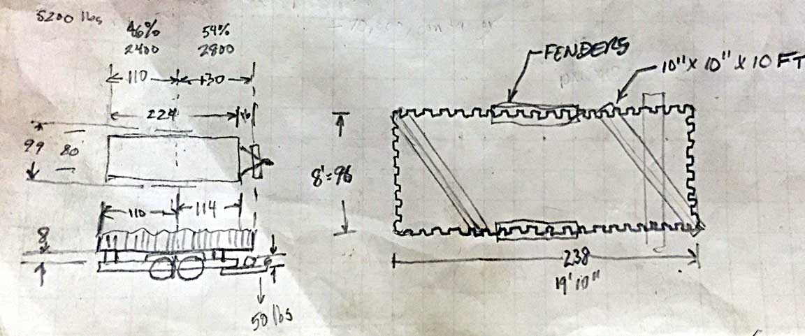

I'm planning to get two ocean containers to store my tractor and other things. I can get a couple container for a reasonable price, 2fer1 delivery. I highly doubt the standard container delivery guy will deliver two containers to the remote location that I have to go. I think for that part I'm on my own.
The plan is to have the containers dropped at a friend's log yard. Where my friend then uses a log loader to set the container on my car trailer. I have a pretty good plan how to get it off the car trailer. The car trailer is 8x20 feet, same as the container. I have to haul it about 15 miles on major public roadways, then 5 miles on forest roads. There will be 10" blocks, so the container is sitting 30 inches above ground. Trailer top is then 30"+102"= 132" high = 11 feet.
Setting the container on 10 x 10 x 10ft beams, at an angle. To clear the 8" high fenders. And then I will rotate the beams straight and jack the container off the trailer. Or maybe like this fella did it on YouTube. He doesn't have fenders to worry about.
Container weight is 5200 lbs. My car trailer is rated for 5700lbs payload.
My question: The placement on the trailer will produce 400 lbs tongue weight + 50 lbs existing = 450lbs. This is a 46/54% bias.
Does this sound like it's OK? Other ideas?
Thanks!!

You could add about 400 pounds of concrete blocks on the tongue if you think it is too light.

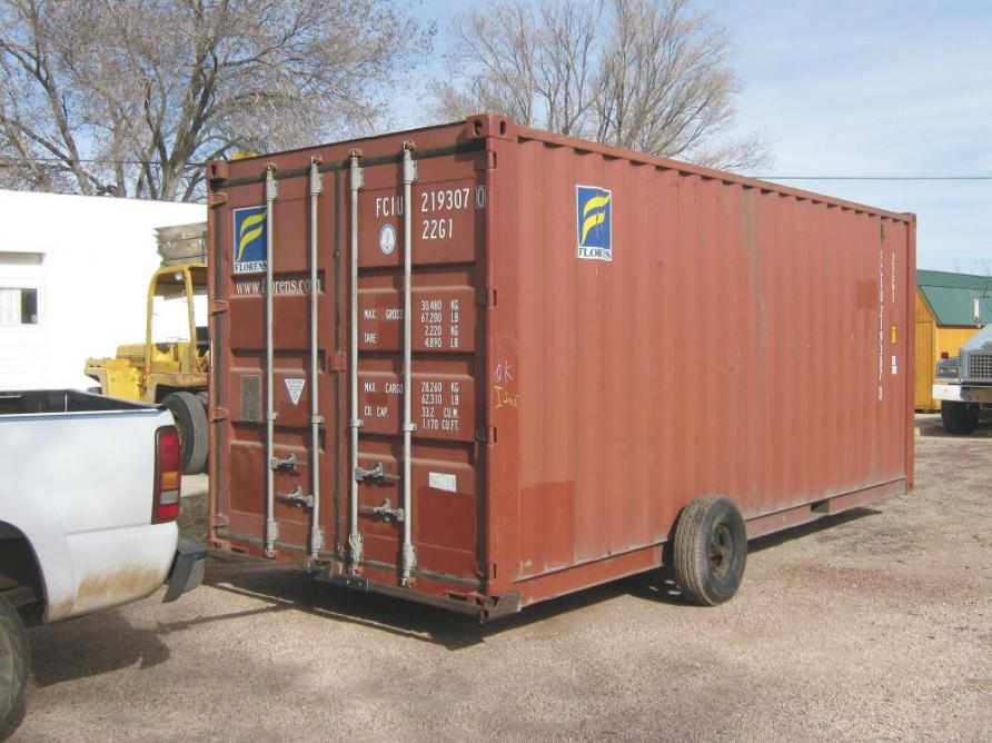

Convert the container to a temporary trailer. :)
https://www.farmshow.com/a_article.php?aid=27616
Or use 2 wide mobile home axles mounted on a large angle, placed about the center of the container, and a hitch to fasten to the front corners.

I would want a few more 10x10 timbers under it to spread out the weight on the floor of the trailer.
   / Move 20ft ocean container on car trailer
The trailer can hold 5700 lbs on 4 wheel-points, timbers out to the frame rails is the easiest load the trailer ever imagined.
Bruce you always deliver! And that's more my style! Current plan is based on a dropoff location near a log loader, and it's 20 miles.

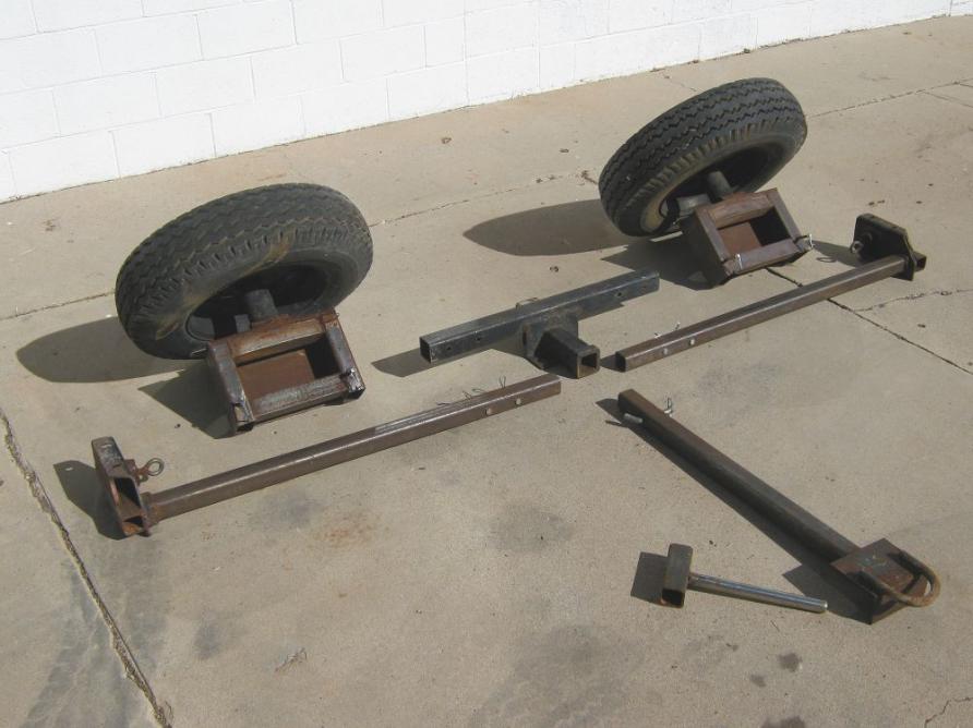

This device ----- will work for the last 10 1/2 miles. I can build it myself (and much stronger, as it has to go 10 miles (twice) on a forest road. If I can get the cans delivered to the end of the public road then it gets easier. Pretty sure I could sell the unit on craigslist when done.

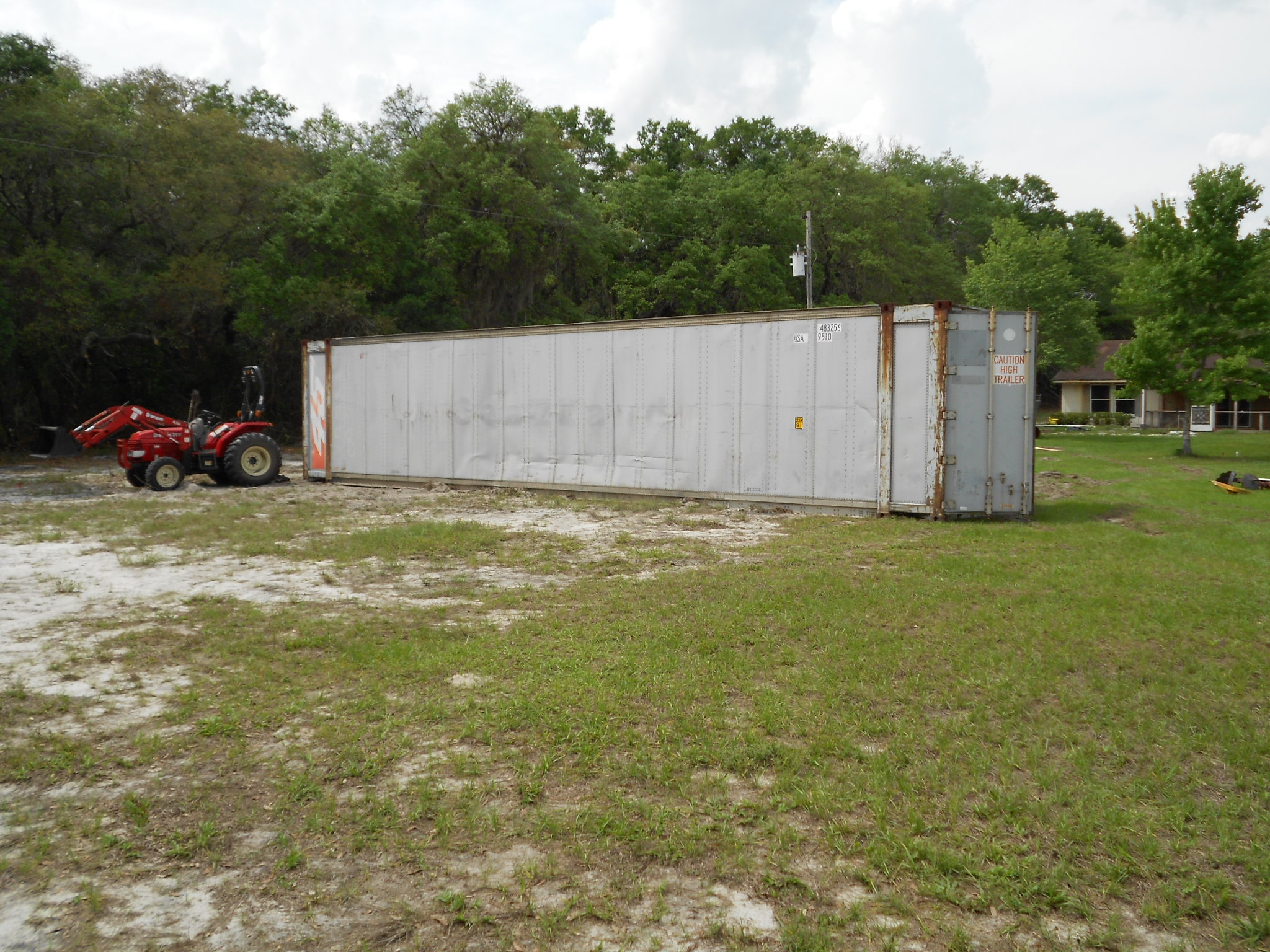

I have moved many dozens of 20' and 40' containers but I was driving a KW Tractor with a 48' Landall trailer picking up and delivering them.
Also a 4 high packer/stacker in the yard.
They are only designed to be supported at the corner pockets and can be stacked 8 high on the pockets. The fork pockets are for lifting empty.
It sounds like your biggest problem is going to be trying to haul the trailer on unpaved roads.

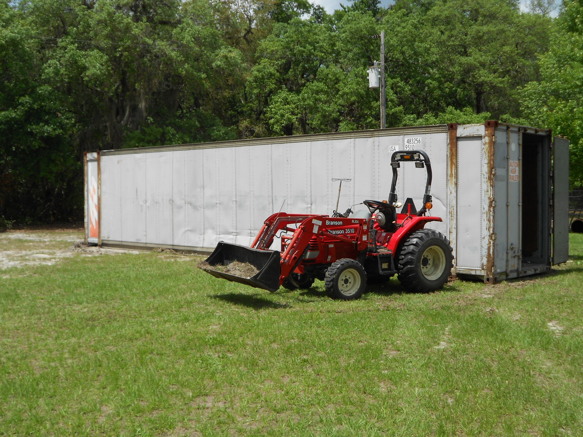

I had my 45'er delivered (I put it in the wrong place) and then I had to move it 90* and 60' because it was where I was putting up a 40' X 60' red iron building.
In the pic I chained the 3 pt to a pocket, lifted and dragged it. I had to scrap the dirt pile at the side rail occasionally.

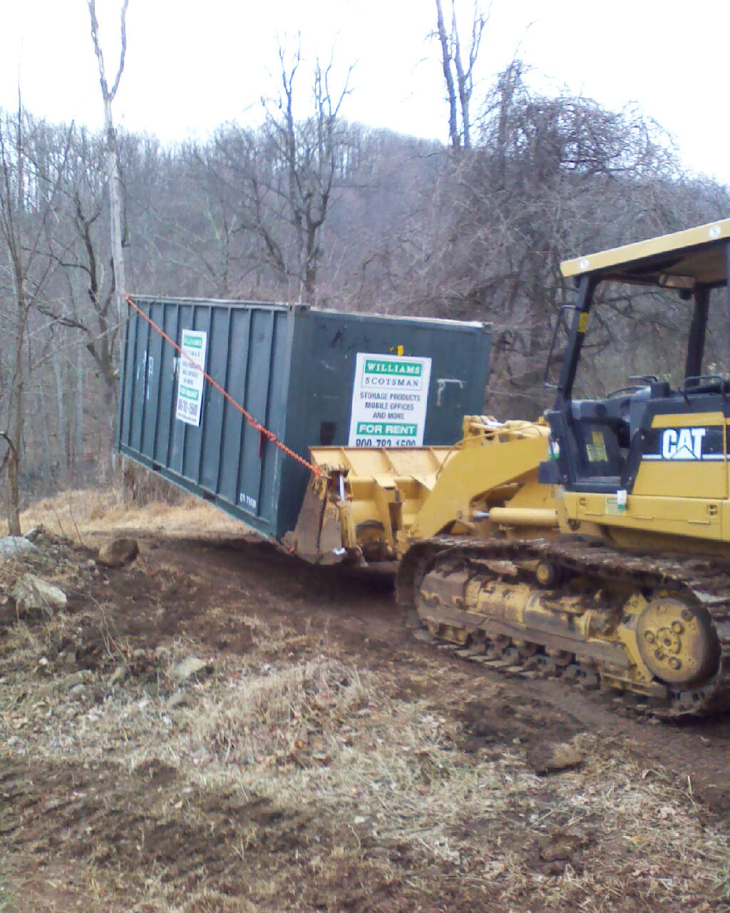

   / Move 20ft ocean container on car trailer #9

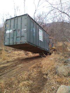

This is how I moved one of mine up the mountain from the drop off point at the state road.
Loader dozer and 3/8" chains.
   / Move 20ft ocean container on car trailer #10

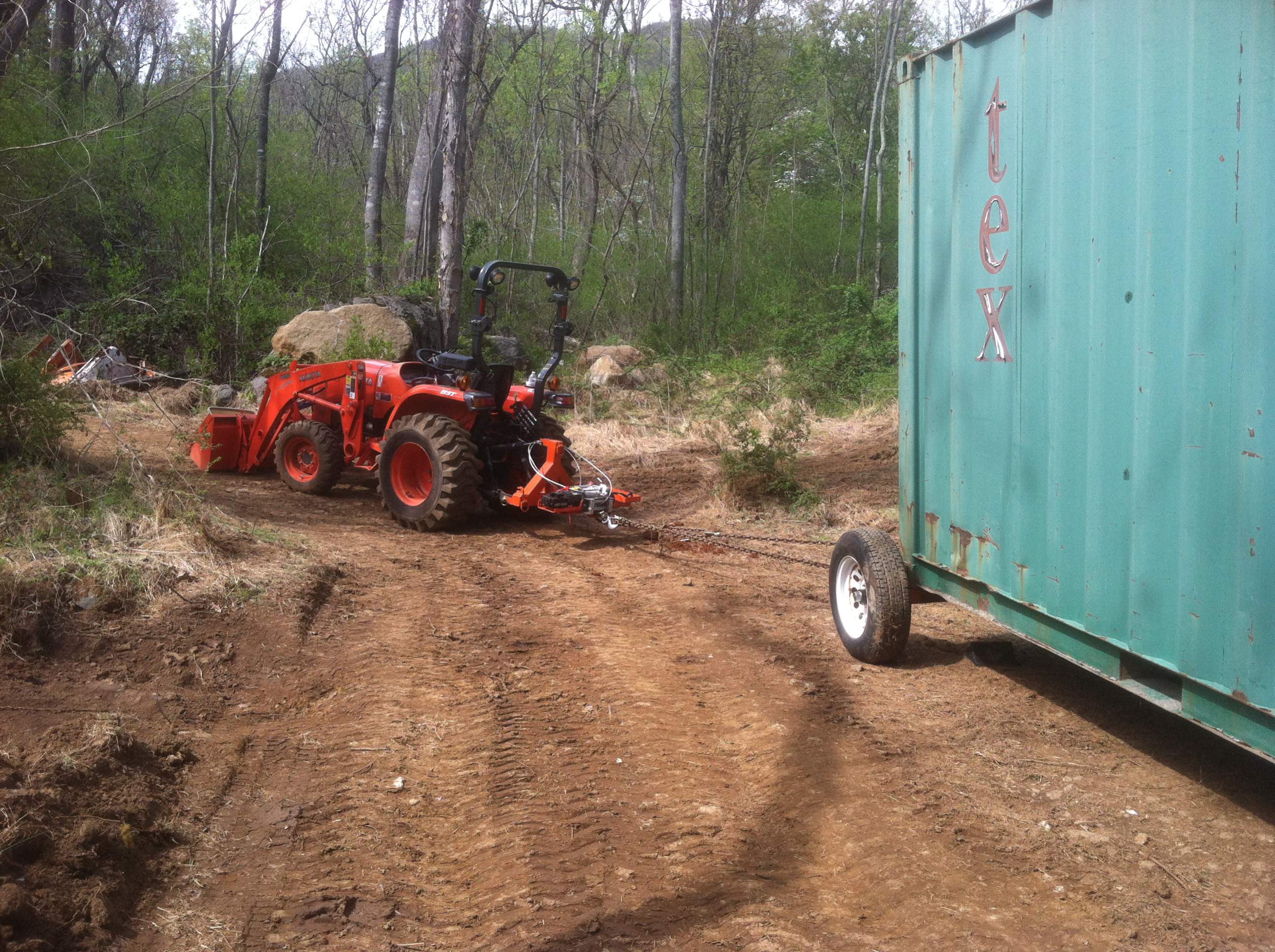

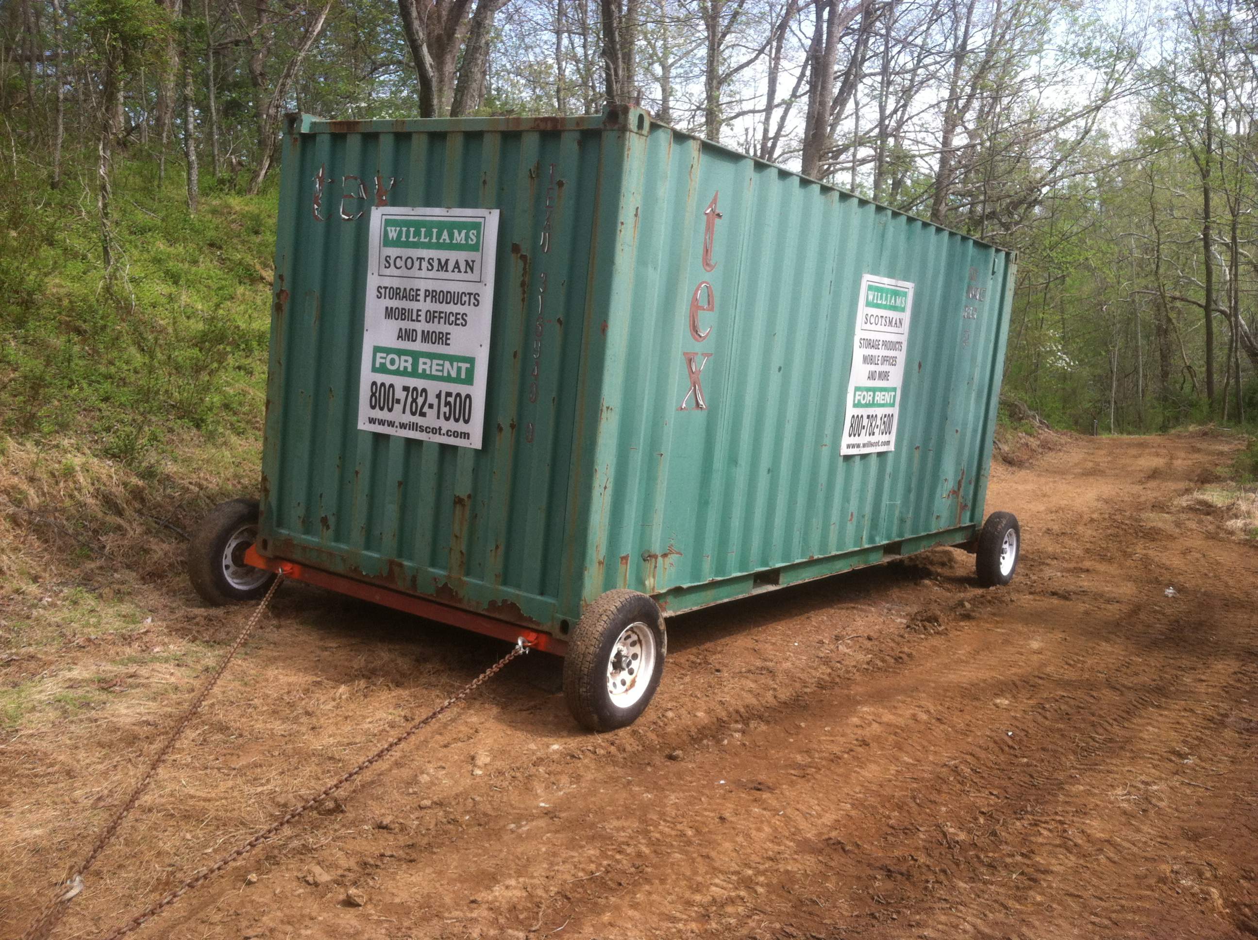

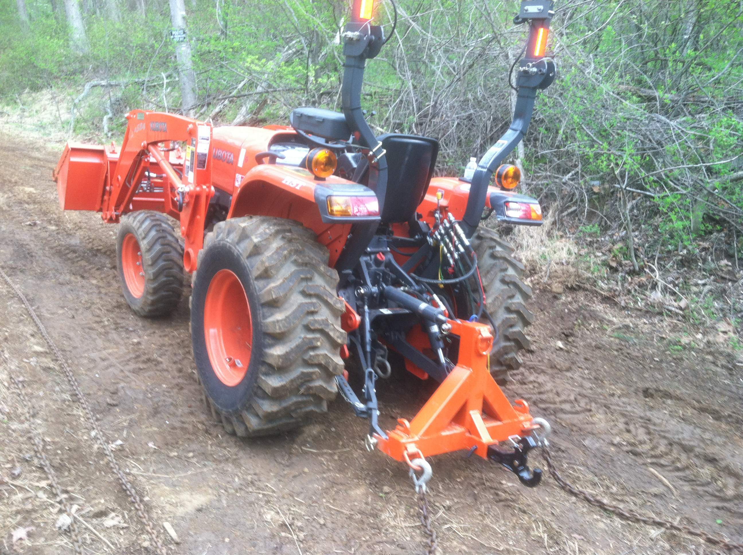

The next one I no longer had the loader dozer on site and built some axles that bolted to the container corner pockets and winched it up the access road.
