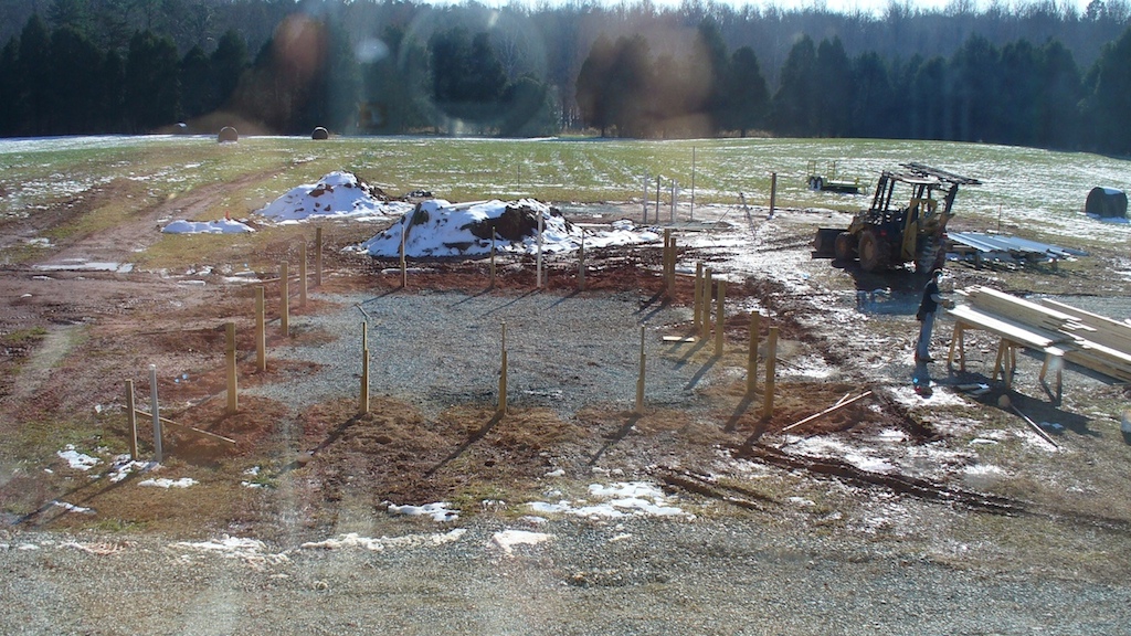

The area where the garage will go is south of the house. This is also where the garage on the house is. I have my electronics shop above the garage, and through a window have a good view of the entire site. The 1st picture shows the site, complete with left over top soil pile from construction of the house (which finished in late 2007).
It is clear that I'll need to do a little earth moving on this job. I got a new tractor in the fall of 2009, which is part of why I needed a garage. What a great problem to have! It's a JD 4520 (60 HP, hydro, 50HP PTO, CAB). I've had a Kubota B21 since 1997 and love it. Clearly these two colors work well together. WhenI got a ball park quote on some of the grading cost (both clearing, leveling, and final grading) it was close to the cost of a box blade. No brainer there, the 2nd picture shows which way I went :thumbsup: !
Another project was started before this- it's a photovoltaic power system (aka solar cells). This will be a grid tie inverter system, about 8KW DC, 6KW AC. I started this project before I had a firm date on when the building would show up. So the area in the 3rd picture is where the solar panels will go. I've scraped the top soil off for my 1st project with the box blade. Note also the conduit and 4x4 post in the lower left of the picture. These are pipes that go into the basement of the house so that when I got around to building a tractor garage, I could get back to the house. I also ran conduit out to where the PV array will go, you can see a drywall bucket on that. On the right, you see lumber that has been delivered for a small shed that will house the inverter for the PV project.
I got a lot done one the PV project before this- you can see conduit pipes sticking up. All the trench work, ground wires, and conduit for the solar project are in. When that project is done, I'll post that project.
The building will be a Morton County Craft 30' x 40'. There is a build date of December 1st, so it's time to get the site ready. The building will go right where the top soil pile is, so the 1st order of business is to move that. It will be just behind/south of the new garage. Seems like there is no more pure form of seat time that moving a pile of something with a FEL.

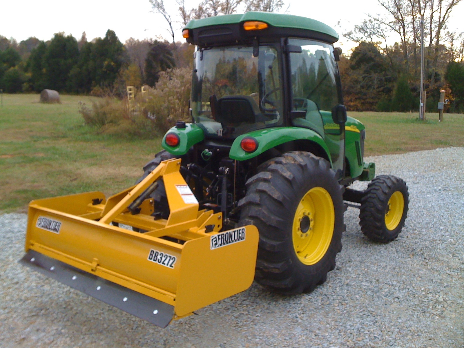

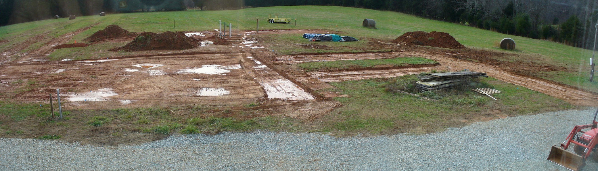

Time to course grade where the building will go. After my using the box blade to clear out the topsoil for the PV project, I decided that a hydraulic top link would be nice. When I got the JD 4520, I got the 3rd SCV so I could control it. Got the top link from CCM. Now to take the top soil off, add it to the pile, and do the course grading. I needed to cut down by 6" on the south west side (upper right in the picture) and fill by 8" on the north east (lower left by the conduits from the house). I put some of the dirt into the trenches left over from the geothermal system for the house. It takes 2 years for a 6' trench to settle all the way. You can see those as "mud streaks" on the left of the first picture.
On the outside of the cleared area, I went about 6' more out to get ready for final grad once the building was in. I had to use the sidelink to get that flat. I found myself wishing I'd listen to all the people who recommended the TnT for the tractor.

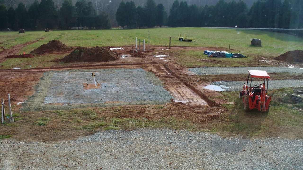

With the building site clear, I turned my attention to the approach to the garage. I took off about 4" of top soil, making yet another pile as you can see in the second picture. I had a stack of leftover pallets from construction sitting in the way. No job is ever done, is it?

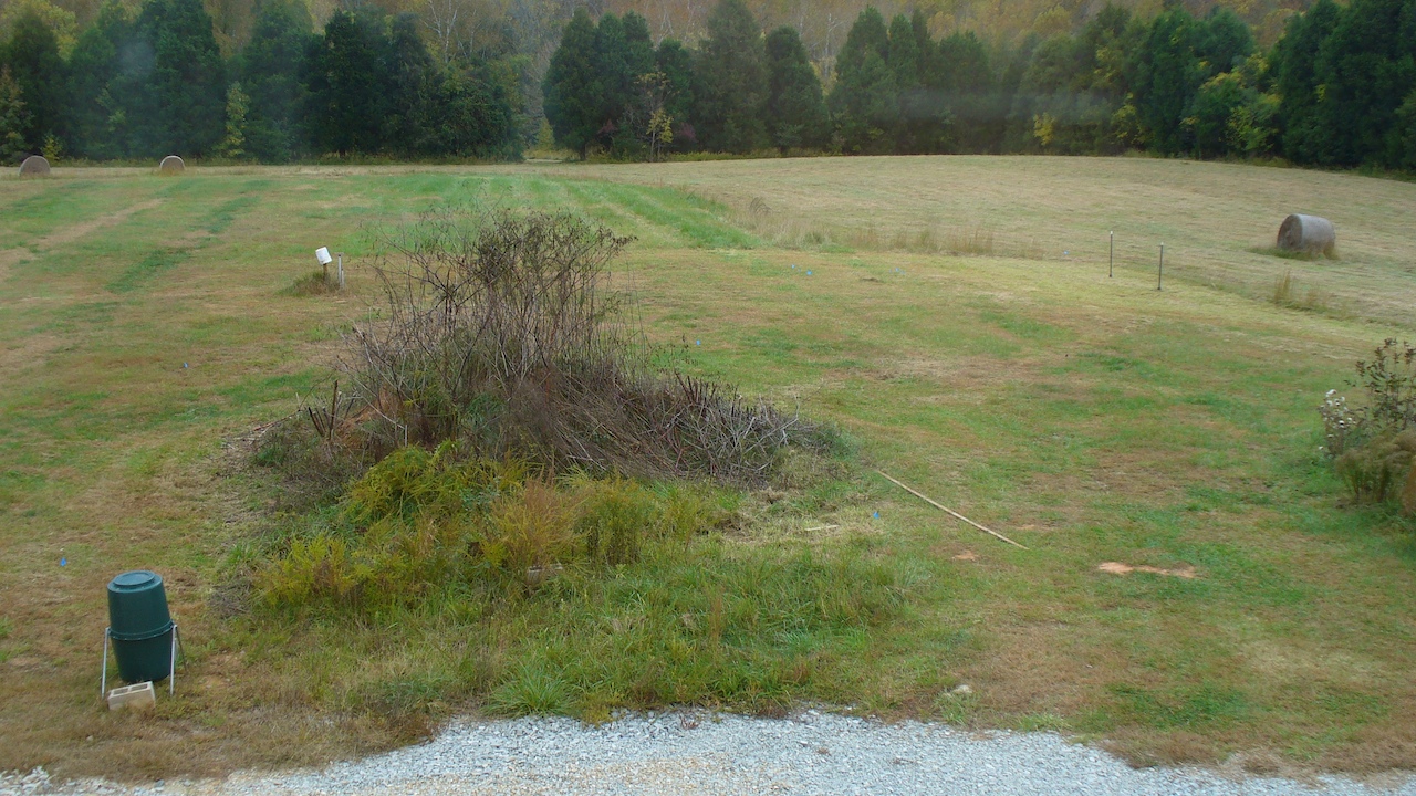

The 3rd picture is a stitched shot of the entire job site. The 2nd story window really helps here. For those who have heard of the red clay of the south, here you go ;).
The 4th picture sets up the next step, the 8" of fill on the north east side. Got the laser level when doing the house and it was one of those "why didn't I get this sooner" things. Great for this sort of thing, and for drainage pipes.

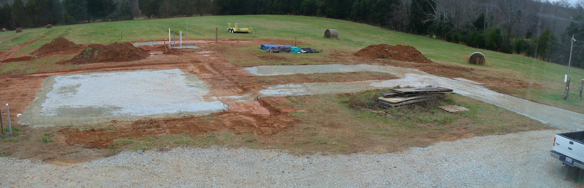

In the first picture you see the laser level in the middle of the building,I put a ring of crusher run so that it was just outside of the building perimeter. Then I will fill with washed stone (1/2 " to 3/4" sized). The crusher run keeps the washed stone from "squishing out" as work progresses.
The 2nd picture shows the garage driveway work. I put down some landscape cloth, then a thin layer of pea gravel, then railroad balast, then crusher run. You can see the washed stone that I had delivered, it's the next step. It will be used to fill the garage area, and to cover the crusher run.
The 3rd picture is another stitched shot of the project. You can see the fill where the garage will be. That is now level to within about an inch. I've not dealt with the problem of the aprons and the level of the driveway, so there is a muddy no mans land between the garage and the drive leading to it.
The long, straight section is there so that the section that comes off the existing driveway is a clean exit, different from the garage. The gravel you see at the bottom of the picture is off of the existing garage on the house. I also wanted a long area so I can park tractors there if I need space to do some small project in the garage. A straight approach also means I am less likely to take out the side of the garage. All entry and exit are straight on approaches. Finally, this is a good area to blow off the grass after mowing. This is also the high spot of this area of the field.

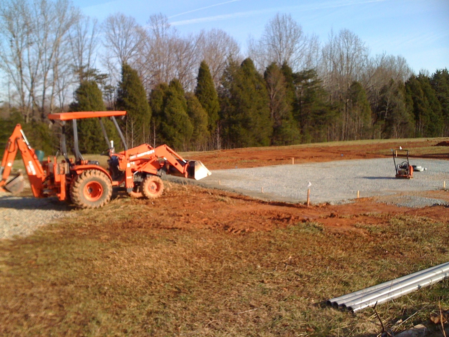

Well, now it's time to get my schist together :laughing:. So I rented a compactor. Made a huge difference, especially on the crusher run. I also packed the driveway, which was a big win. When I drove the tractor on it, it stayed put after compaction.

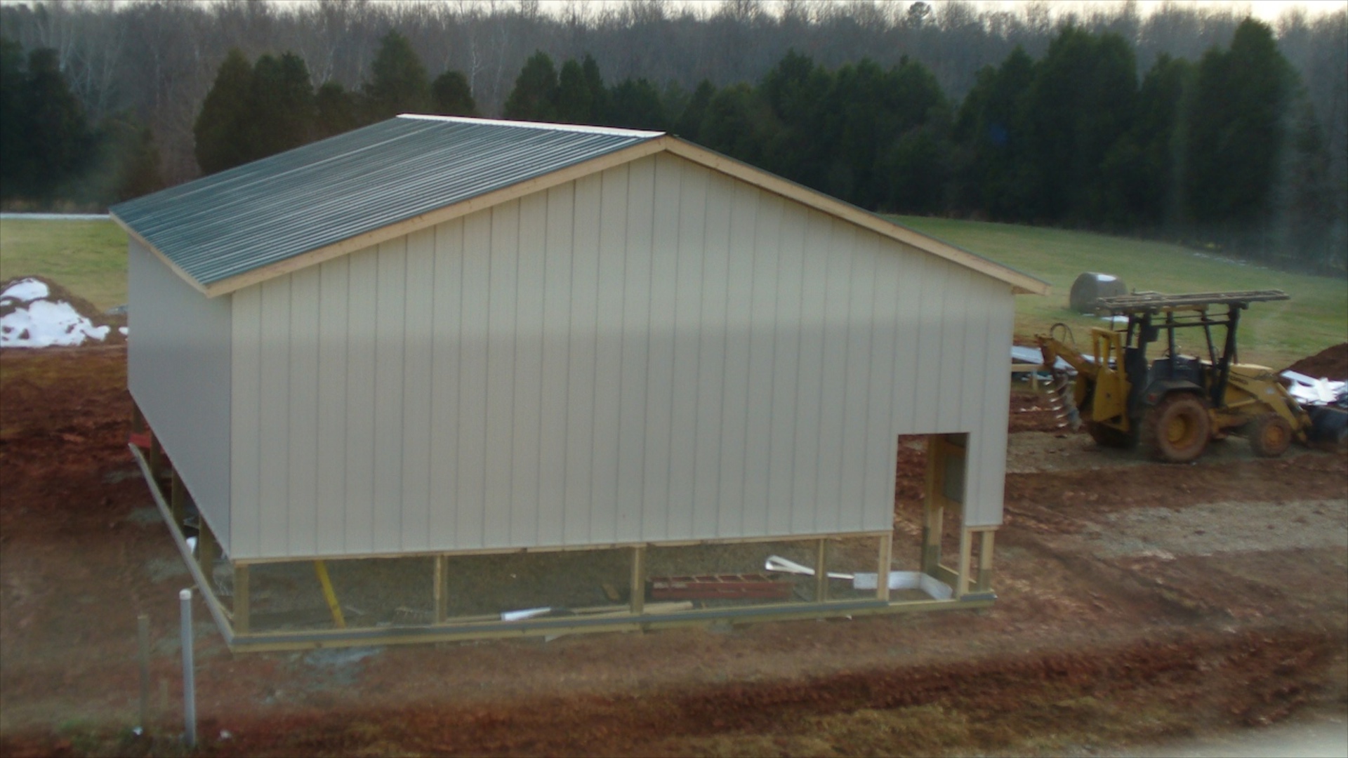

Now the building gets framed. The 1st picture shows that in progress.
The 2nd picture shows the completed framing, day 2 is done.
The3rd picture shows the start of siding on the 3rd day. The tractor is quite something. It's a FEL and PHD, and has a scaffold that can have it's height and tilt set hydraulically. This specialized tractor is the key is the perfect complement to the crew's abilities. No, I don't have anything to do with Morton I was just amazed at how smooth it all went. I think they've done this a time or two.
The 4th shot is near the end of the 4th and last day. All that is left is the Wainscotting siding, facia and soffet. The concrete and garage doors are done by subcontractors hired by Morton.

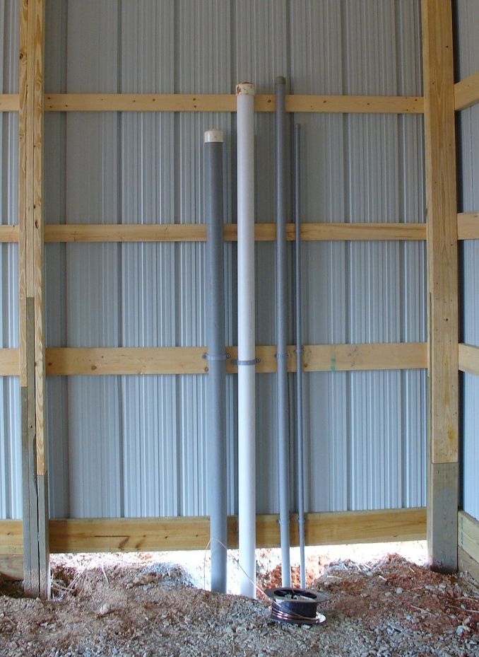

Well now it's going to get ugly. It's about 35 degrees out, wind blowing, it's rained, and the mud is either wet or frozen. It's time to dig up those conduit stubs and re-work them into the building. A bit of backhoe time, but a lot more crouching in a ditch in the cold and wet with a shovel. This is kinda the opposite of the "move the topsoil pile" seat time experience.
The 1st picture shows the conduit after it's been uncovered.This is down about 3 feet deep. There is a 3" electrical conduit, and 3" drainage PVC for other stuff, another 3" PVC for more future expansion beyond any tractor garage, and two smaller conduits that go to the solar project area.
The 2nd picture shows the final result of getting these conduits up into the building. I dug to within about 1.5' of the building with the backhoe. It was one of those "push it too far and put the bucket in the building and you'll be kicking yourself" moments. The last 2' of excavation I would do by hand. It turned out to be a big chunk of soapstone, so it was me and the mattox tighter again. All this took about 2 days. The end depth was 3'. You can see the horizontal ground rod in the trench. BTW, all this conduit work and all of the building was permited and inspected by the county, so everything is on the up and up.
The 3rd picture shows the reworked ground area we saw in the 1st picture. I pack the dirt and gravel around the pipes to reduce trench collapse in the following year.
The 4th shot shows the conduit coming up into the building. I've put another round of wood below the 2x6 band that Morton put on the building. This is in the 8" of fill area on the north east side of the project. There is going to be 4 more inches of gravel added by Morton before the concrete. so the cut area will have 4" of stone under it, and the fill area will have about a foot. Once the conduit was in, I put in the last board, and then on the outside put in a layer of crusher run to support it so the stone would not push out from under the building. The final product hides the mess it was to get it done, from the cold to the well diggers patoot problems.
We had some rains and the fill around the colums sank a bit. I further compressed with a sledge hamer, and then put about 4" of stone on top of it which I then compressed with the sledge again. This will leave a 1 foot collar around each post when the pad is poured. Between that and the concrete base, the posts are well anchored even though it's not solid concrete fill.
I did not do the rebar in the post to tie it to the pad. The post is in 16" of concrete at the base, and a foot at the top. Pushing a post in would be about impossible. And if it's being pushed out, the building has been compromised already. I'll be wrapping the conduit so the slab can shift or settle a bit. Similarly, if the slab settles a bit (I'm talking 1/8 to 1/4" or so) it can slip down the post OK and the ground supports the slab, not the post. I'll let you know over the next 30 years how that works...

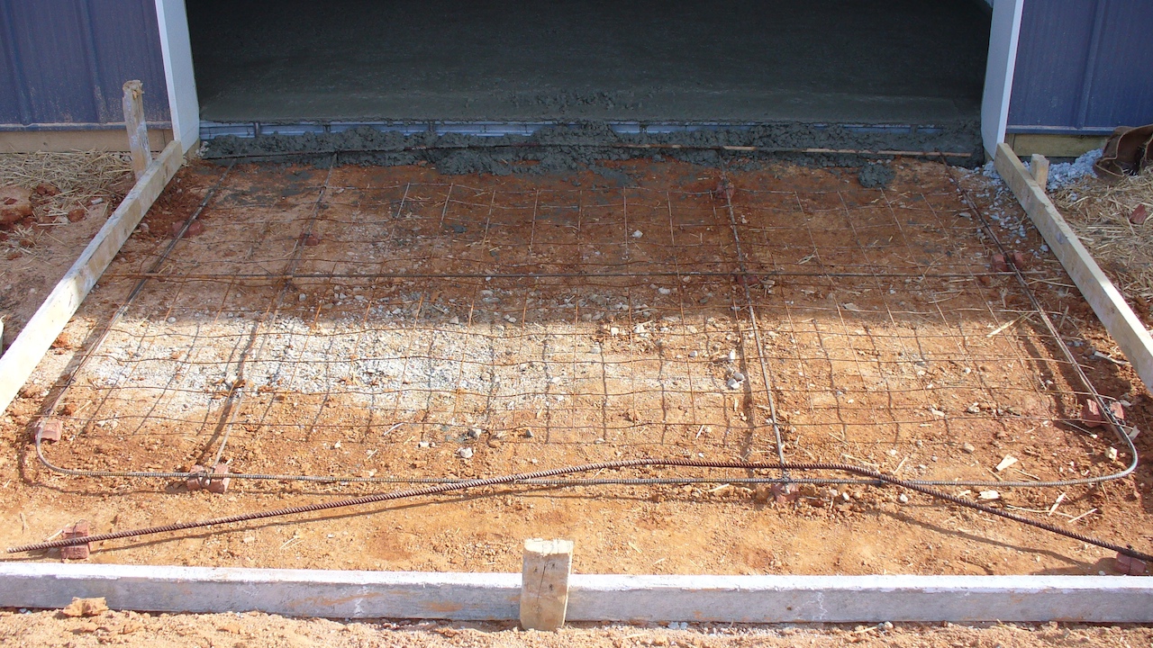

A Pour Day
What other sort of adventure can you have where a pour day has concrete results ? :D
1st shot is the concrete going down. I was pulling up the mesh, as were the workers. You can also see in the lower right a height stake they put in.
The 2nd shot shows the rebar and mesh for the 8' apron. You can see the keyway at the building edge. Four pieces of #3 rebar go into the pad and will keep the apron attached. A pieces of #4 (1/2") rebar is right up agains the keyway (6" from it), and the same is true on the other side. Since this is a maximum stress point, I beefed up the rebar size and spacing here.
I messed up :mad:. I thought the 8' was from the _inside_ edge of the building, it was from the outside. So when I dug the apron and made it for a 2" drop over 8', I came up short. They measure the apron's 8' from the outside of the building. So the apron thickness is 5" except for the last foot, where it tappers down to 3.5" (the 2x4 height). I tossed in an old bent up #4 rebar in hopes it would help. The form for the apron was done after the garage floor was poured. So I had a problem that was discovered in the middle of a pour and cure process. That's about as worst case as it gets. Worker were great about hitting the shovels and digging out the extra foot or so to keep the job moving.
3rd shot is the smoothing. The temperature that day was 65 degrees, and we had low humidity. A good day to pour for being in the winter. They were there until 11:00 that night working it. It got down to 38 that night. I had one crack in the apron where I didn't have enough blankets to cover the last 2'. Glad I had the rebar and mesh in there- the crack should stay put.

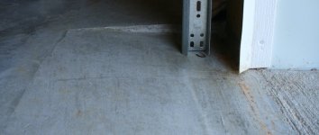

The 4th shot is something I had them do at the door. I also had to play with the heights to keep my 5" pad (minimum). A little extra digging out and then working the gravel pad. I had them cut down about 1" at the door so that water would not blow in. The doors face west, so they get hammered in a heavy rain. It all worked great. I had this done with a 2x6 at the old house, but the step bump was really annoying, particularly if you push something in by hand. The sloped drop down is a big win. The garage has two doors, a 10' x 10' and a 12' by 8.5' high. The 8.5' high means the bump up is not a problem for the tractor FOPS or Cab, and is not a problem with the apron 2" drop and final grading. No water incursion, just drive in, life will be good.
