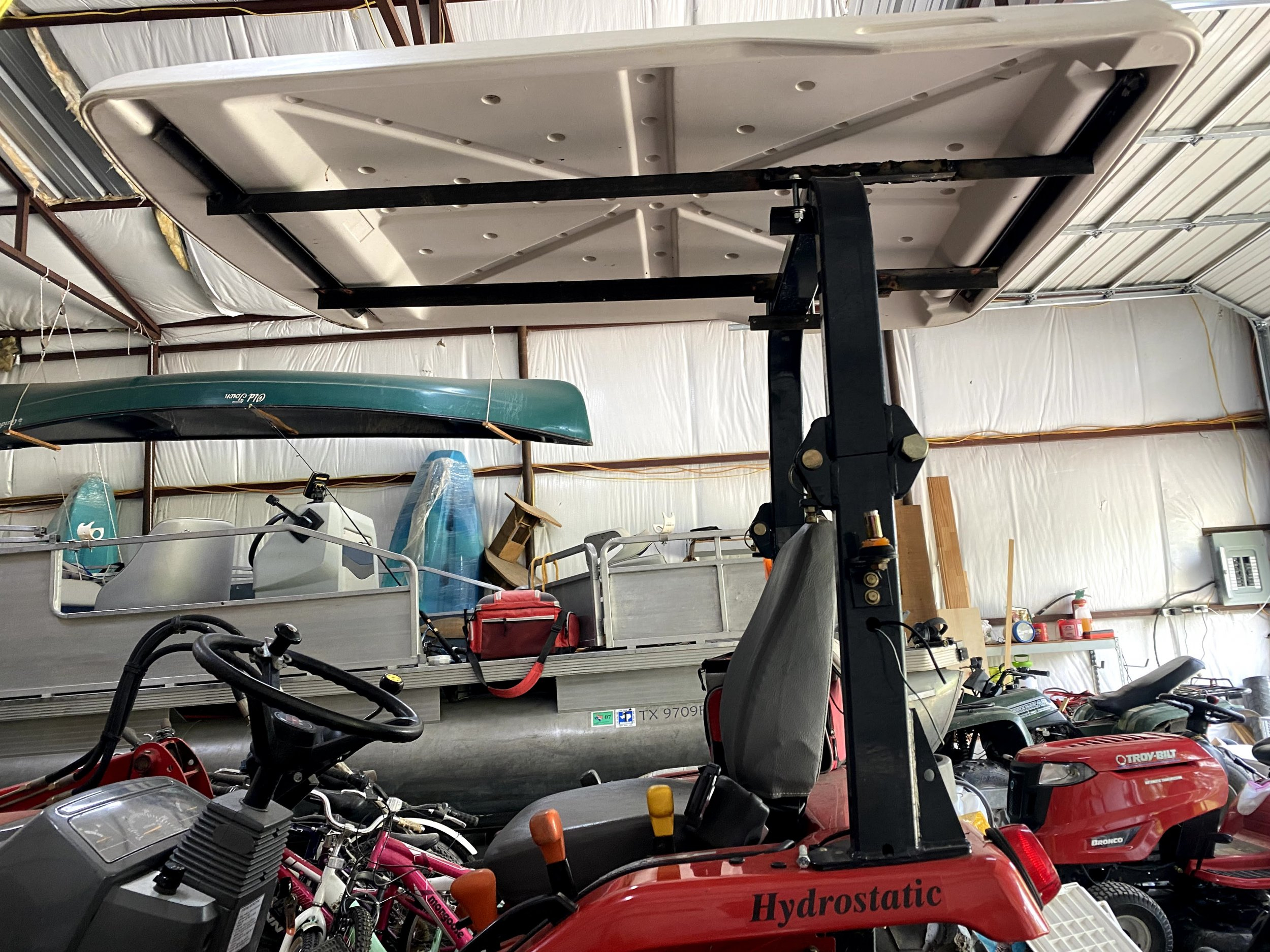

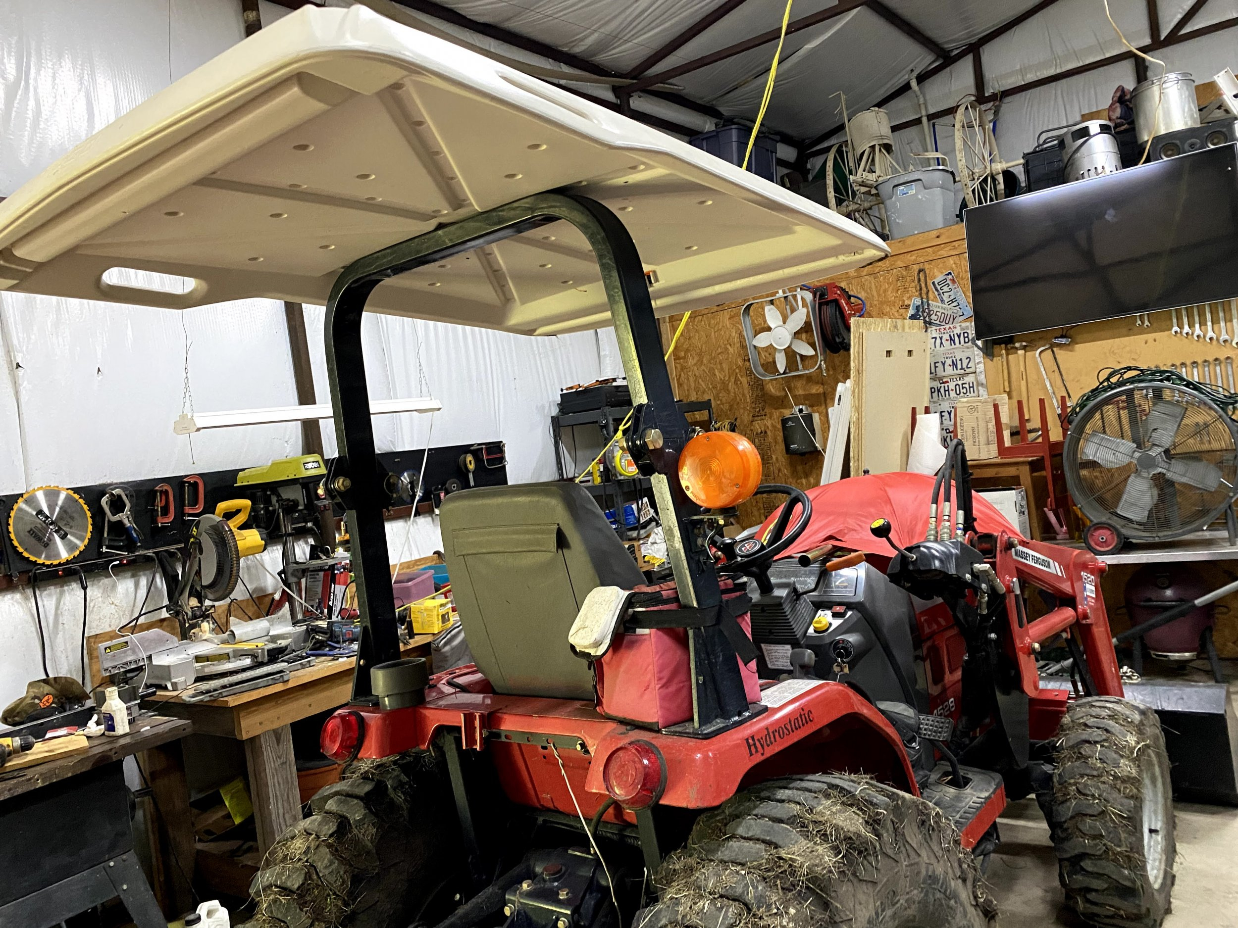

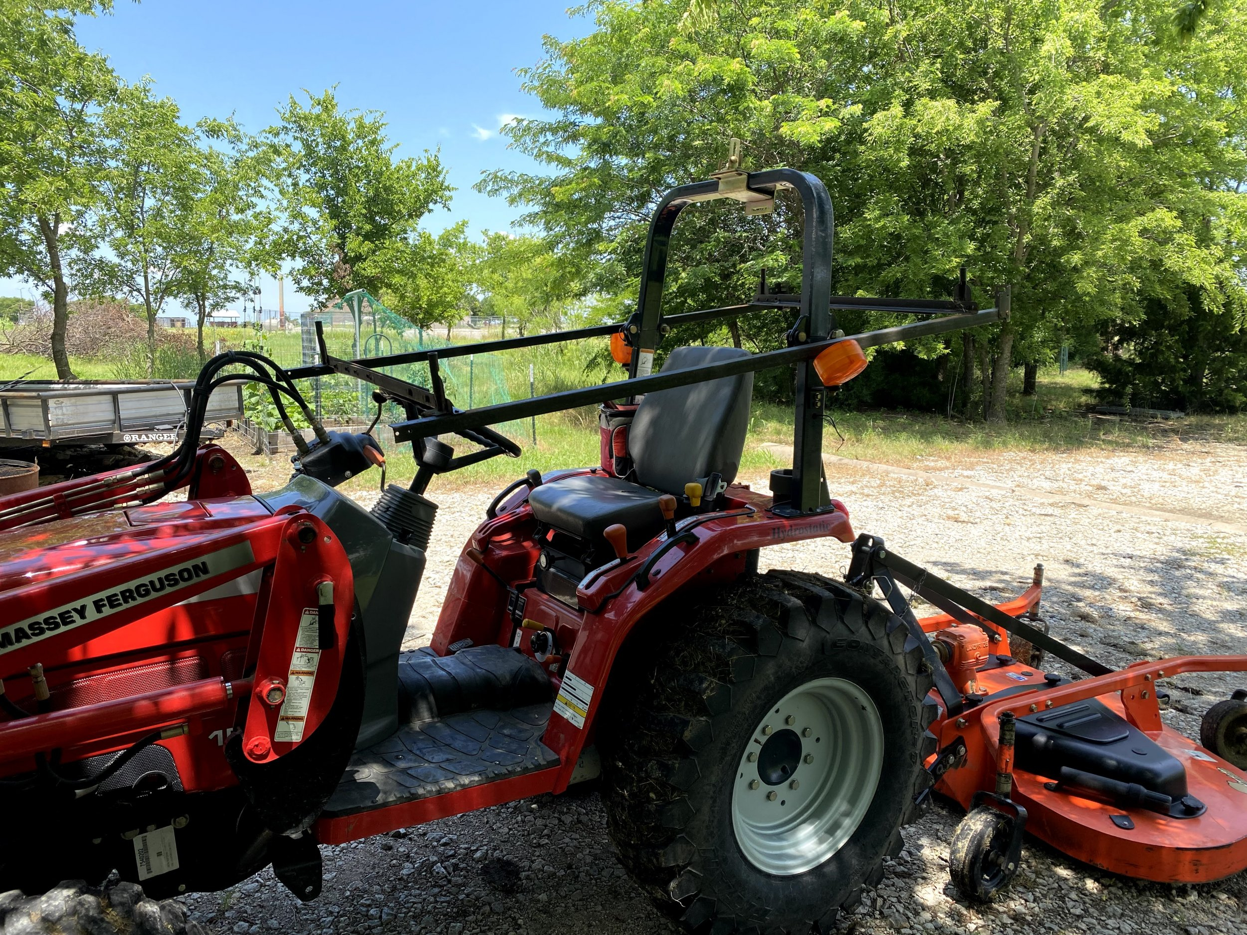

Sick of the old umbrella I used to have, and the little buccee's umbrella just isn't going to survive more than a few tree scrubs.

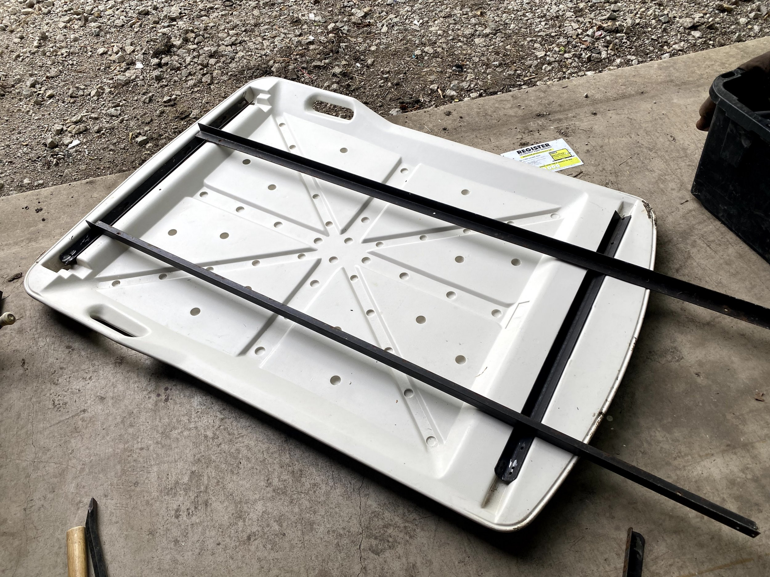

Picked up the golf cart top from a golf cart place, $25. Seems to be the going rate around here.
Frame is made out of one of those adjustable bed frames I had lying around.
Just welded at the intersections (we'll see how long my lousy welds hold...)
This is where I left off yesterday. I took it down, cleaned up the metal, ground off some of the sharp corners, and painted it.
Seems rock solid, should hold up ok just mowing my small acreage, all pretty smooth terrain.

I would add a piece of angle iron on each side on the front
to give extra strength just bolt them on as it don't seen
like it has protection from a big tree branch or very strong
gust of wind maybe bend the top???
