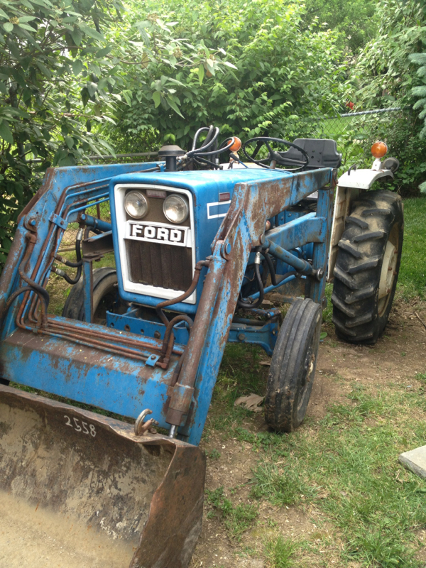

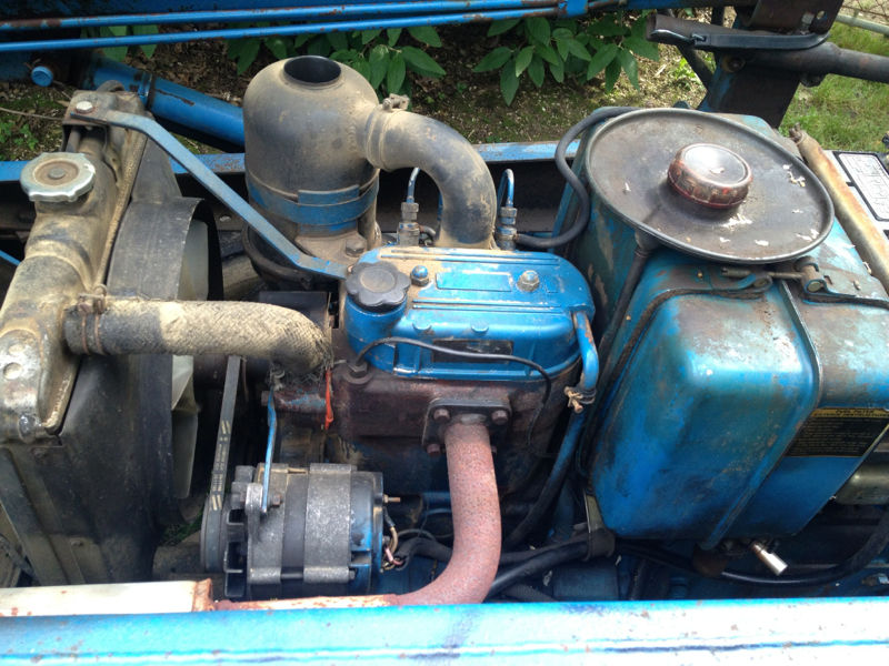

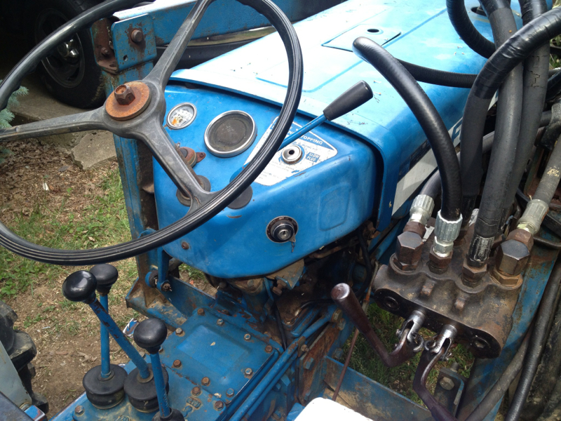

I have a couple of questions in other threads about my new to me Ford 1600, thought I'd start a dedicated thread vs. hijacking other threads. My 1600 has unknown hours, has a loader, and at this point I believe everything on it except the proof meter and the horn actually work! I'll use this thread to ask the experts for advice as I navigate fixing this tractor up for use maintaining my 8 acres. First, some pictures......

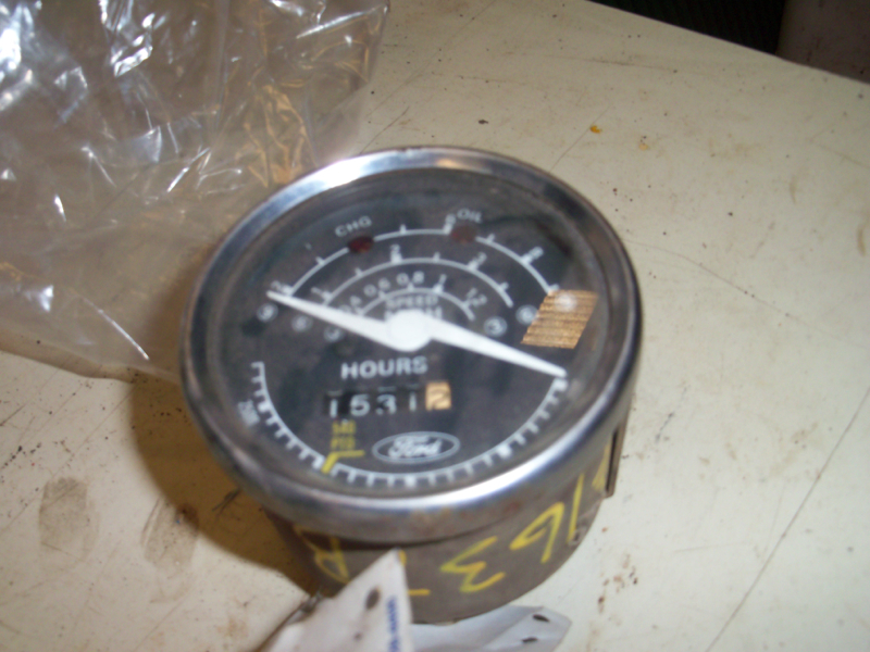

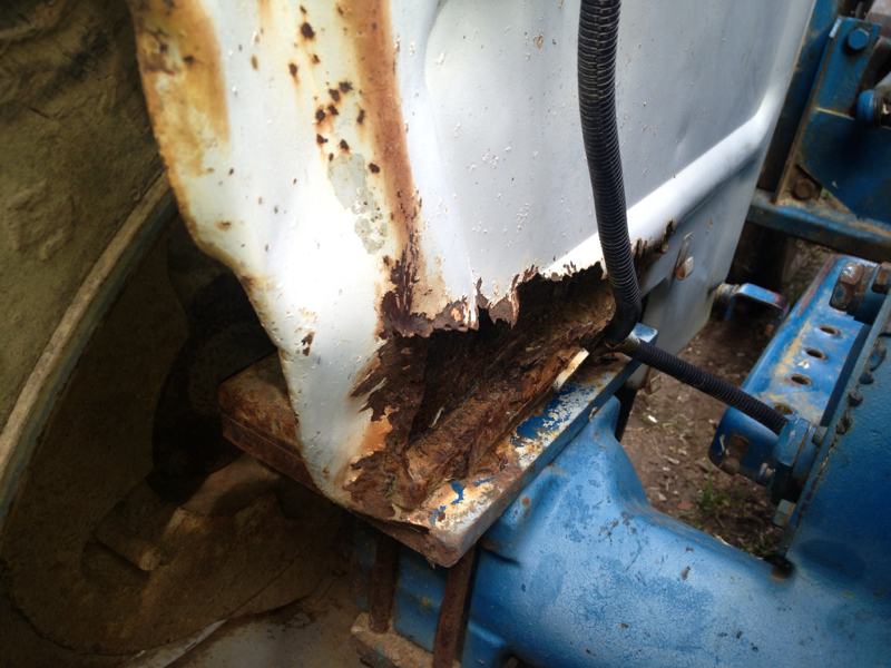

The existing proofmeter is toast. I found a replacement one based on advice from another post, just $70. The last picture below is the new proofmeter I bought. The only rustthrough is at thebase of the left fender. Ugly butI don't think it's hurting anything just yet.

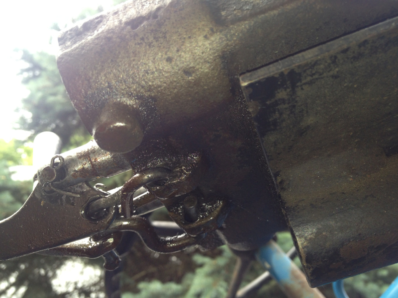

My plans are to fix the leaking spools in the loader joysticks, fix a leaking bucket cylinder, then do all the need fluid and filter changes.
Where can I find kits to rebuild the loader joystick spools and the loader cylinder that are leaking (posted in the other thread already, sorry, no more duplicate threads from me going forward)

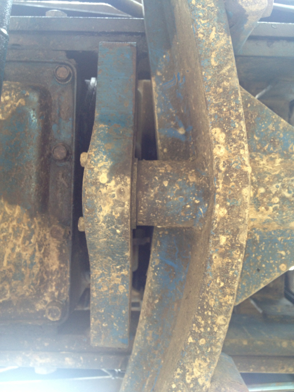

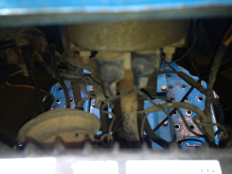

Next issue.....the tractor pulls to the left when moving forward. I think the "axle" (i guess its really not an axle, but i dont know what its called) is bent. See pic below taken from directly benieth center fron of tractor, the clearance/gap is closer on the left side. Anybody ever had this issue? Can an adjustment to the tie rods compensate for this problem?

what you show is the front axle and it appears to be bent but geometry of front axle pivot and axle does not support it. It might be design associate with 1600. went and looked at NH site. The diagram is isometric and does not show directly from top of bottom to see if the bend is there but can't see it bending the axle without the force g transferred with some deformation on the pivot. The problem with pulling one way is the tie rod. On one occasion I hot a stump with my 1700 tie rod and it bent it some causing to pull to the right. I tool the tire rod off with a ball joint separator tool (pitman puller) and straighten the tire rod and adjusted the toe in angle and she started going straight with no pull to either side.
JC,
ps. jack up the front of the tractor with the axle secured on two jack stand. The front wheels should be parallel and facing straight ahead.
