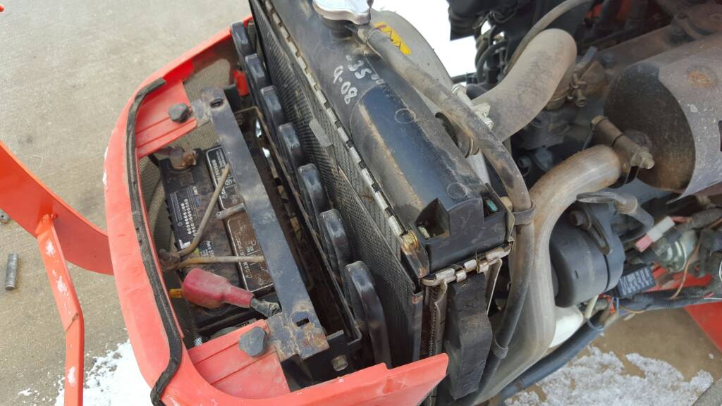

I have a pin hole leak near the top of my radiator on my Kubota B2620. The top of the radiator, where the leak is, is some sort of plastic.
Do you think if I drill it out to about 1/8" and put in some JB Weld, would it hold?

Can you show pics of exactly where the rad is leaking? Most plastic header rads end up being replaced by copper ones. Most fail at the gasket that seals the header to the core, though having a pinhole from a defect in the plastic header is a possibility too, I suppose.
   / Need to Repair pin hole leak on my radiator
Picture of radiator. The engine is cold and not running so no leak in the pictures. uploadfromtaptalk1451928103315.jpguploadfromtaptalk1451928121158.jpg

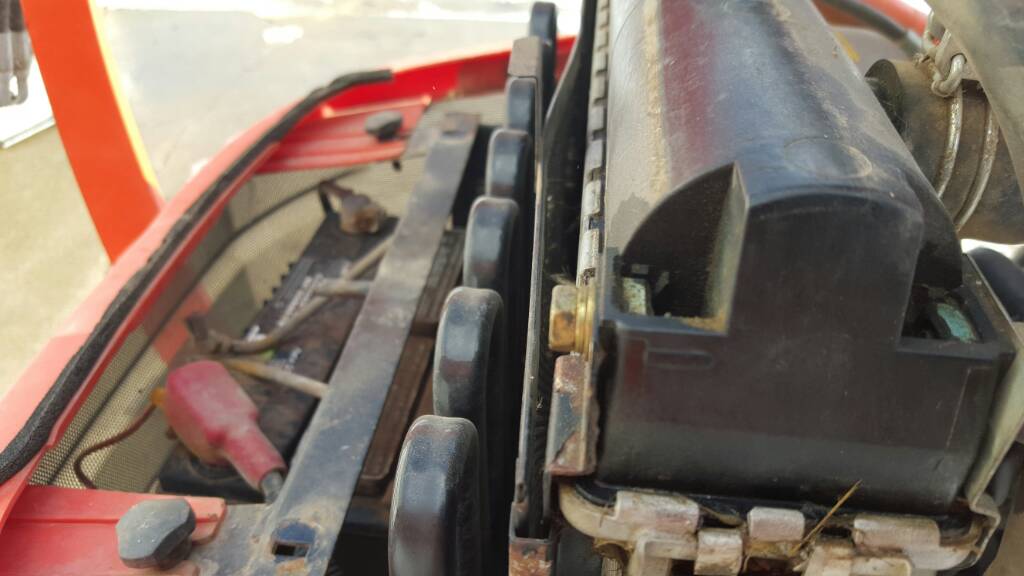

Here's a close up. I can't see the pin hole.uploadfromtaptalk1451928247089.jpg

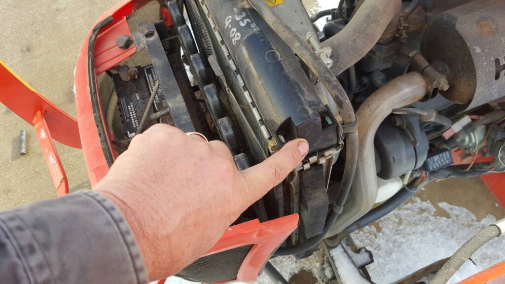

Thanks for the pics, seems the end cap portion of the header has a hole in it, if I'm following where you indicated with your finger?
Usually those rads fail where the header is crimped to the core, as can be seen in your pics. This one might be saveable. Note: Some plastics can only be sealed with a plastic welder, but I think you can get around that here due to the small hole size.
