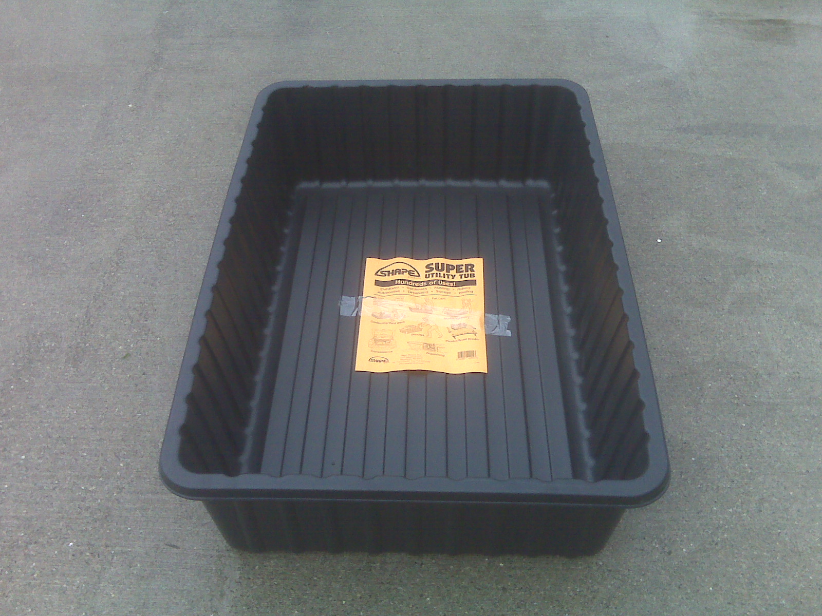

Another thread in the past about oil draining mentioned the difficulty in finding a large and suitable container for the purpose of catching a large amount of fluid. I have about a half dozen of these, sold as a "concrete mixing tub" at Menards and other home center stores for about $9. Size is 3 feet long, 2 feet deep, and they are 8 inches deep and hold 20 gallons. The only problem is they are impossible to lift and pour if you have more than 5 gallons in them, you need to empty them out with a bucket. They also make an excellent dip tank for trying to find a leak in a tire when you fill the tub with water.

   / Oil Change Surprise - New Holland TLB #26
I bought one of those big tubs at Home Depot that are used for mixing bags of concrete. It's maybe 2' by 3' and holds a lot. It's big enough that I rarely spill even a drop, regardless of circumstance. I think this is the one: Large Mixing Tub-887102A at The Home Depot
They make a thicker one and a thinner one and you want the thicker one. It will hold more than you can handle so I limit to maybe 4 gallons and then funnel into a 5 gallon bucket. What drove me to this was a disaster of changing the gear oil on a high clearance Case-IH tractor and I managed to spill a couple gallons over me, the floor and most things in sight.
