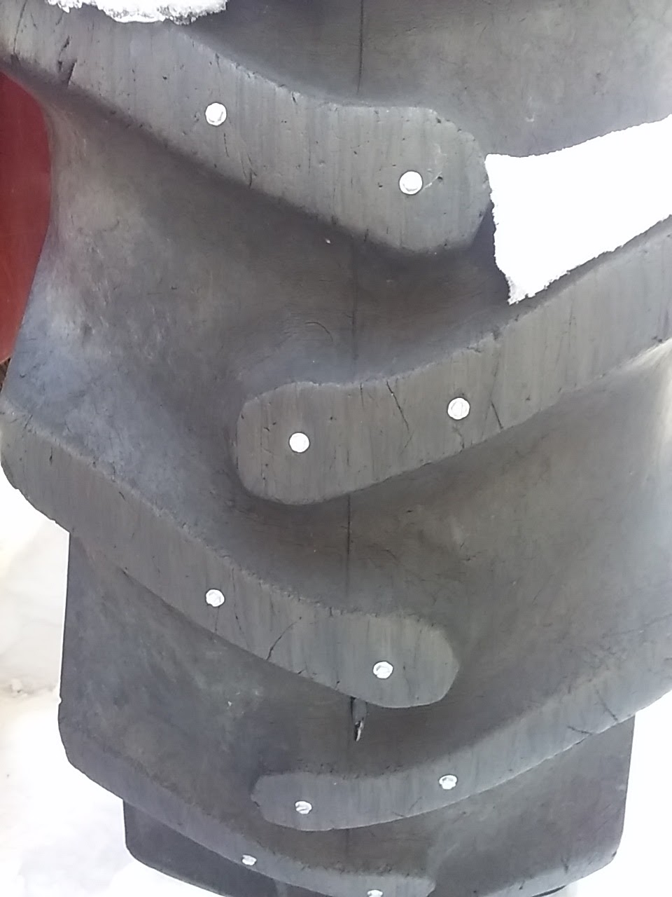

I've seen other threads where people suggest studding tires with $1+/stud special ones. Not wanting to spend $100/tire, I went a litle different route. My IH464 has R1 on the rear and tri-ribs up front. For $6, i bought two boxes of 3/4" hex head sheet metal screws and put two in each lug. It was amazing the difference it made. I went from getting stuck if I dropped a wheel off the pavement to plowing through most anything. The rears are loaded and I have two sets of wheel weights per side, so weight isn't a problem.
If anyone is wondering if studding works, the answer is yes. I just can't see justifying hundreds when the sheet metal screws work so well.

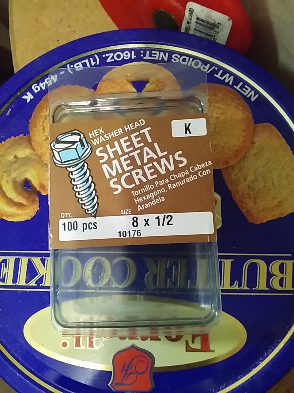

skills, what size ( # ) of 3/4" length screws?

I had to find the bin with the extras, and I was wrong the first time. They are #8 x 1/2" hex head.

Do those screws ever fall out? I've take a drywall screw out of my truck tire and I hate the idea of giving myself a flat.
   / Studding tires
I haven't had any fall out yet, but I don't know that I'd go so far as to say they never do.
skills, thanks for the update on the screws. Can you tell us what pattern if any you used or a picture would be special. I am thinking of this instead of grooving my tires. Mostly for grip on grassy side slopes for finish mowing, I'm not sure grooving will improve the grip I want. The R4's I have tend to slide when the ground is dry and hard. When the ground is moist (not the grass) there is more traction. Thoughts?
