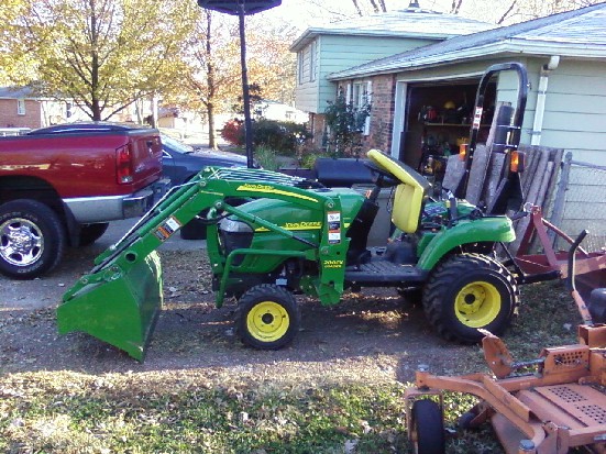

3.00 star(s)
MyThreeSonsMowing
2305 John Deere
Unhappy w/ Overpriced 2305 Doorstop
Model Year: 2010
Bought to do landscape work and move snow - FEL/54" blade & backblade. At 111.0 hours, radiator perforated in 3 locations, catastrophic loss of coolant and blown motor. JD Corp. blames ice formation on fan blades for perforating radiator. Since ice was the "cause" there was no warranty coverage! Flexible mounting of radiator seems issue #1, as too much play results in fan spindle making contact w/ water pump driving blades into fan. It would seem to make more sense to rigid mount and eliminate rocking issue of radiator, just me and common sense talking. Issue #2 - if the fan is sucking air through why is it designed to allow for ice formation and then leading to FODing of my radiator? Seems a better design is called for.
Pros: Good little workhorse in good weather.
Cons: Not solidly built for cold-weather operation.
