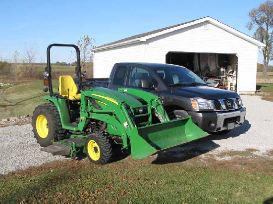

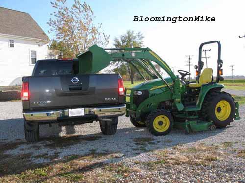

BloomingtonMike
3320 John Deere
John Deere 3320, R4s, 300X loader, 72" MMM 7-iron
Model Year: 2005
I bought my tractor from Cross Implement in Minier IL, a rural Ag tractor dealer. Brad Cross really worked with me to get me the tractor I wanted at the price I wanted - a trait I really like in rural dealers. The 3320 at the time was the logical choice for dealing with IL snow, loading, and mowing of 6 acres back in 2005 (there was not the choices that there are in 2010 in the smaller compact tractor lines). I added hydraulic lines down the 300X loader (300CX option that I made work) and I use my loader with a 72" hydraulic angled Deere (thank you John) snow plow as well. The 300X loader is strong and really works well with Load Match but make sure you have plenty of ballast. Also a good set of pallet forks will change the way you do a lot of work around the yard. Forks are also great to load and move wood and tools. The R4 tires are a perfect choice for the light loading I do and are easy on the lawn even while mowing. The 7-iron 72" deck has been great and I am just now changing blades and will change the belt soon as I noticed a crack. I also did my 400 hour service at 300 hours ans many tractor owners recommended it at 200 hours and I was lazy. Took a few hours but I was slow. Definitely doable by any wrench owning tractor owner. I am happy with my 3320 Deere and would buy again!
Pros: Has enough PTO hp and weight do to the fun work without needing a barn to store it in. Large backhoe option, and a full suite of attachments make it very powerful for sub 10 acres. I would not want smaller to push snow.
Cons: Price - you only cry once though. This one will cost as much as a truck!
Photo Uploads:
