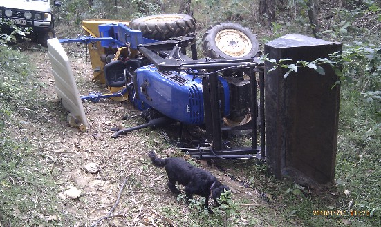

Phil Lovering
JM-284 JInma
Excellent Workhorse
Model Year: 2010
Very minor problems with hydraulic spool fitting leak, apart from that an excellent machine. A special note: I live on the side of a steel mountain and can testify that the roll over protection WORKS! It saved my life when I lost concentration and went over the edge rolling completely over! In addition we pulled it out, topped up the oils and worked perfectly, but the ROPS is a bit bent!!
Pros: Excellent value for money.
Cons: Part can be hard to come by, but they are getting better.
