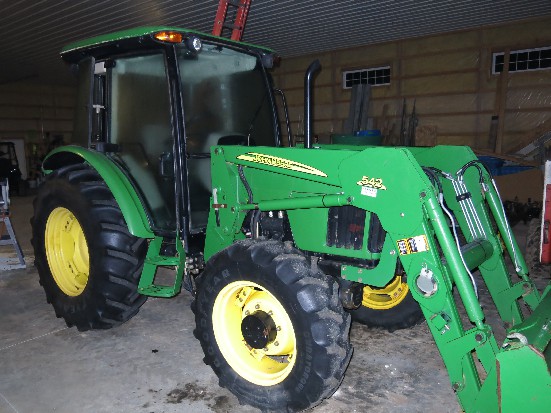

Model Year: 2008
I compared the JD to Kubota models in the 60 to 75 HP range. Both make fine tractors. This used 2008 JD 5603 came up at the dealer with low hours. It has 99 HP so I went with the bigger/used tractor for same price as the smaller new. It has the cab and loader as a plus. I'm just now getting it set up with implements. Only problem was with the hydraulics. The loader lift was jerky, especially at high engine RPM. Even noticed it in the steering. Finally talked with a knowledgeable JD mechanic and he suggested changing hydro oil and especially cleaning the pick up screen. It was an easy job and I found the screen was plugged with gunk. After cleaning, problem solved. Tractor starts easy, even at cold temps. The air heater was a little different but works like a pre-heater on diesel glow plugs. Once I figured it out, engine started every time in the cold. The cab air-conditioner and heater are sweet! No more coming covered in after mowing or disking covered in dust and grass.
