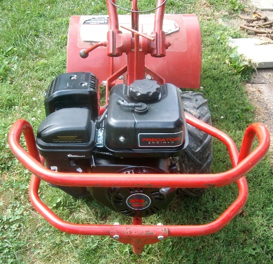

Engine Swap Troy Bilt Tiller
Model Year: 1982
My 6hp Tecumseh engine locked up and I replaced it with a predator engine- #69727 212cc OHV horizontal shaft gas engine - EPA & Carb from Harbor Freight. This engine was used on my Troy Bilt Horse Tiller replacing the 6 HP Tecumseh engine. Swap was very easy to do and Engine bolted right up with no problems. Had to use a 5/16 by 24 thread bolt for the shaft and also replaced the bolts bolting the engine up to the PTO which are also 5/16 by 24. Was easy to start on initial startup, let it run under no load for a few minutes shut it off and restarted on the first pull.
Pros: Easy to start, dependable, quiet and good power output.
Cons: None.
