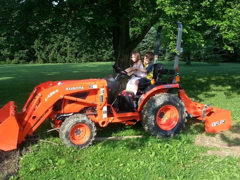

Kids love tractors too:

Many people think the B sits much higher than the BX. Here's a pic that compares. Not much different in my opinion. I'd buy the B too!
I definitely thought that at first. The B looks so much bigger, esp given the bigger tire sizes. It wasn't until I drove one just after being on the BX I realized they were really close. My wife was surprised too.
