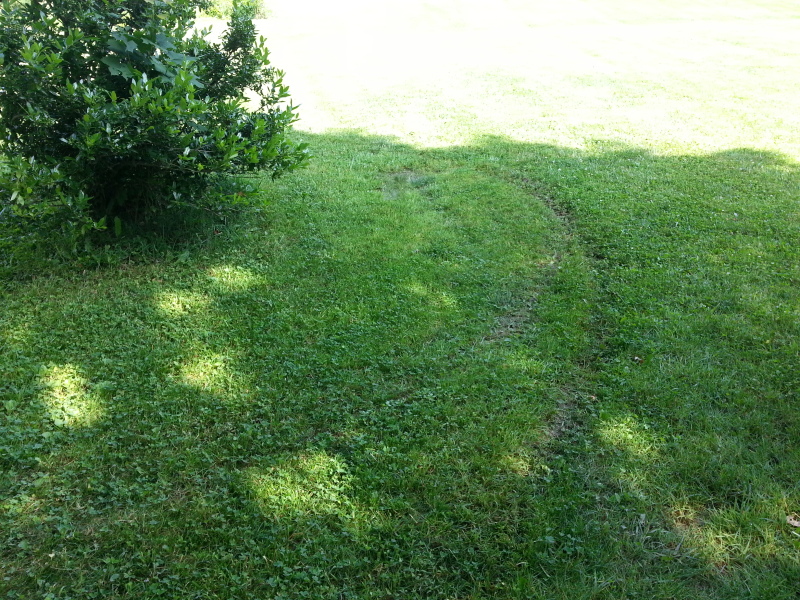

You're not in 4WD when mowing, are you? That's the only way I can get my R4s to damage my lawn. In 2WD they are fine. Heck, I imagine even turfs would damage a lawn in 4WD.
Its def in 2wd. I do have very heavy clay and it's been very rainy. My drainage is terrible too. So it may be the ground is softer than average. Ill get some pics of the lawn as soon as I can. Harder dirt may be more forgiving.
French drains are on the project list. Lots of bh practice :)

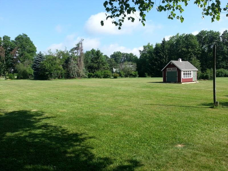

Overall nice cut:
I'm mowing in 2nd. Lots of rain this week, so grass was long. Ripped through it w/o a hiccup from the motor. The old 48" gasser would bog down and I was taking a lot of half cuts. Would be nicer if the clippings were a bit finer and mulched in, but this is the 60" on OEM blades.
Learning patterns to limit sharp turns. Avoiding making tight circles.
But in the squishy areas...
This is the third mowing. This is also after all the construction work to build the foundation for the shed. I ran over this grass constantly moving loads of dirt and rock, as well as carting around the backhoe. Bounced back pretty well and no major damage.

Looks good.I found the clippings long with my 54 inch deck until adding mulching blades.Are you going to change the type of blades on your deck?
   / My new B2620- 1st week review
#29
It would be nice, but not high on the list of expenditures. How much did they cost btw?
   / My new B2620- 1st week review #30
I would get the Oregon Gator blades - about $20-22 range each, (I paid $18 ea for 52" cut) get two sets as shipping will be less. I have them on my ZTR and they do a great job on grass and leaves in the fall. Take a wire wheel or sander and remove the coating on the cutting edge before installing.
On the R4s marking - take the turns wider, and yes it has been very wet lately - give it some time before going to turfs.
Good write up too, and on the BH, as others have said, you will get better. Nice property and nice machine.
