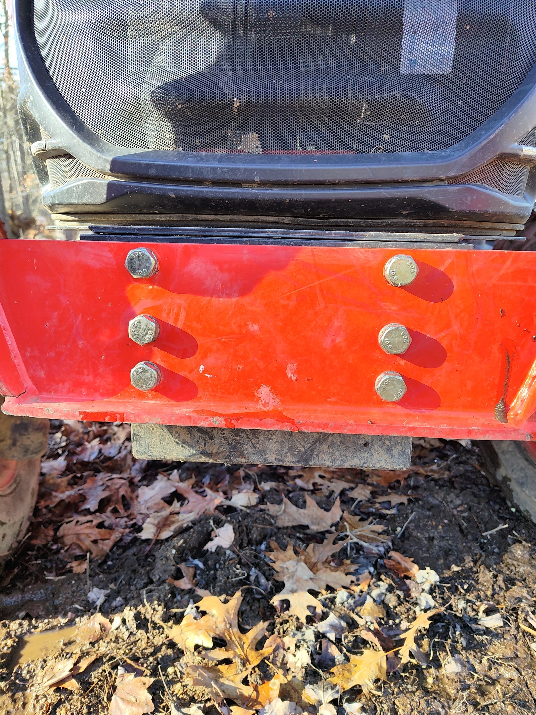

This is probably somewhat of a newb question. I have a Harbor Freight winch and was originally thinking I'd have to attach it to the back with a towing receiver or some configuration like that. Then I noticed the front of my tractor has this plate on the front as shown in the image below. Can a winch mount be attached there? If so what would be the best way to mount?

I built an hydraulic winch from scratch and mounted it on the same place. That's where the front weight bracket and weights would go.
In order to reduce the risk of splitting the tractor in half, make sure that sub frame is going all the way to the bell housing and then the loader mounts tie it together with the rest of the tractor.

Did you notice the crack in the lower left of that plate?

It can. Best way is to build a mount for it. Personally, I'd build one that had a receiver hitch underneath it. This, of course, requires that you have steel fabrication tools and skills. Given that you're asking this question, I'm going to assume that you don't, which leaves hiring it done. Doing that is probably going to be fairly pricey. Just depends how dedicated you are to the idea. That said, I'll just reiterate what has been said. Tractors aren't generally set up for large electrical loads, like a winch. They're designed to power things via hydraulic or mechanical means, not electric.

I put a plate with a tie down on mine. Could have been a receiver tube. Used a piece of cardboard to make the template. My bolts weren’t long enough, ordered (I think) 12mm x 1.25 x 45mm, the thread was different than I expected to find.
