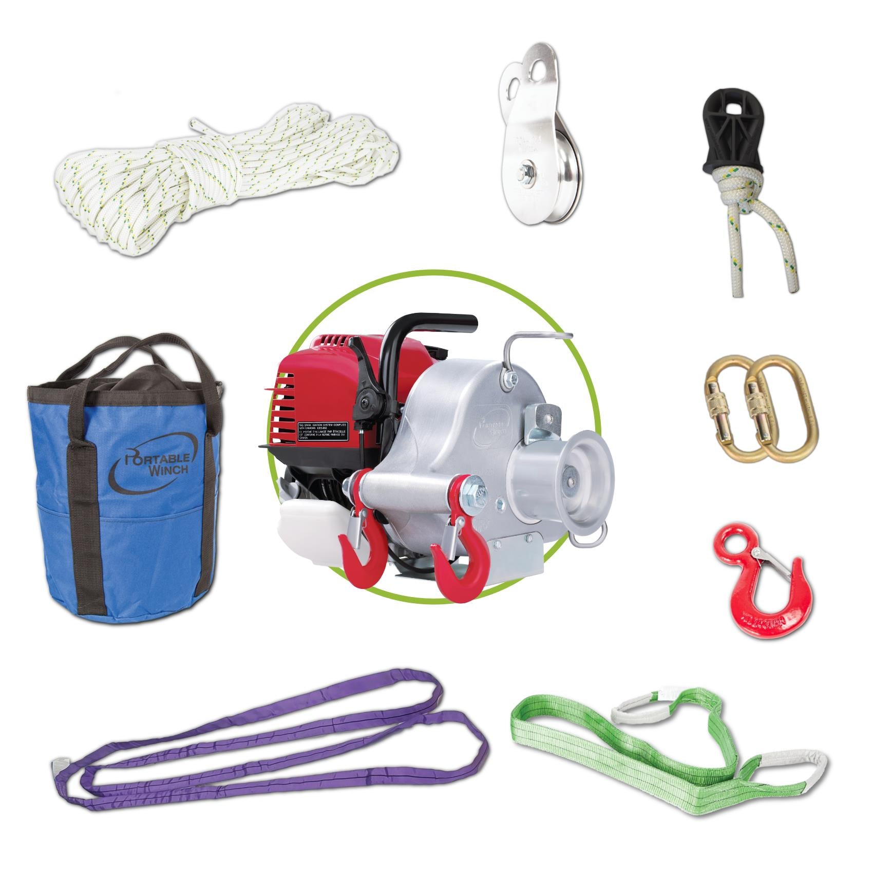

These winches are very slow and power draining for what you describe as others have stated.
I feel you’d be better off with A capstan type winch for the work you describe.
There are larger ones as well.
This may or may not be a solution depending on what the intended use for winch operation is....
Been thinking about one along of these lines as a alternative to a PTO logging winch (not recovery) as I have some stuff to pull out (dead trees and brush) that is in about 200 feet beyond where sane tractor access is prudent.... Only other option is to carry out by hand (ugg don't think so, to old for this) ....
   / Attaching Winch to Front of Tractor? #42
He describes his intended use.
I think this is a fit for what was stated.
Much faster and he doesn't necessarily have to attach it to the tractor to do viable work.
One of the advantages is a capstan winch doesn't care how long a line you need as the residual line length is not stored within the winch.
