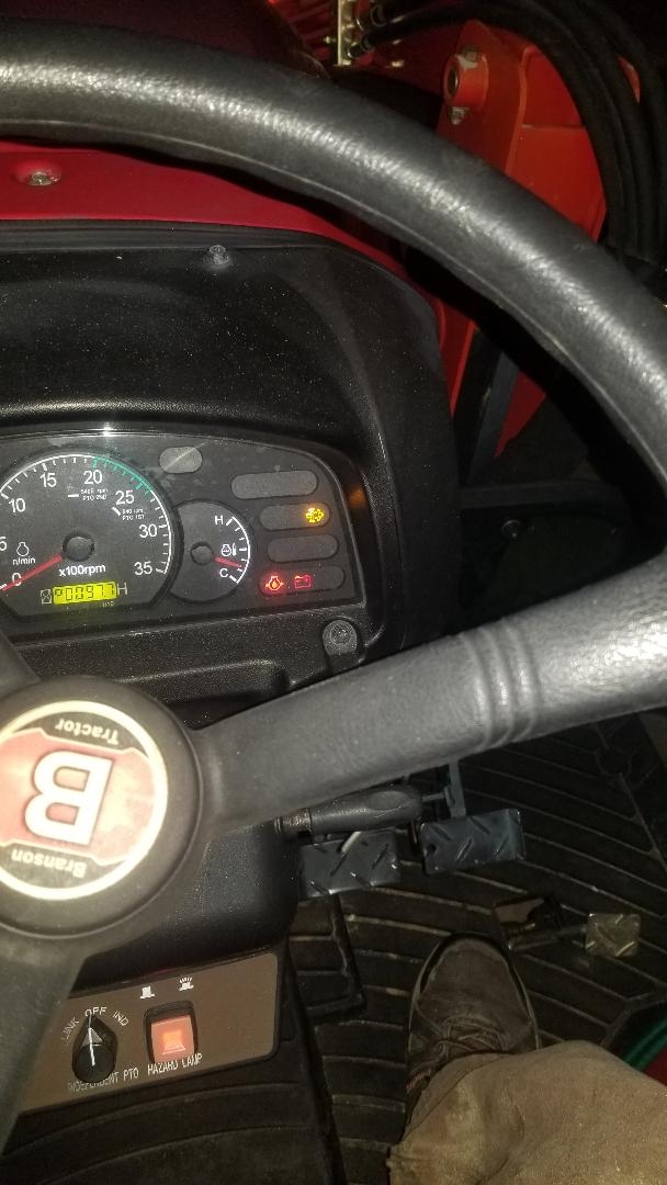

2017 3520R Can anyone Identify this light on my cluster? Tractor as had this for about 2 hours run time over a few days. Has now slowed and will die. This change took about 2-3 minutes. Will start and idle for a minute or two and then choke down and die. Is it telling me clogged DPF ? Does the 3520 have DPF? Tractor is new to me with 93 hours. Thanks in advance.

Thanks Earplug. You confirmed my suspicion. Now the question is can it be cleaned in the field as it has clogged to the point of not wanting to run. Not sure it will even load on trailer. Tractor is mostly used for forklift purposes and never runs hard.

Thanks Seville009. Found that last night and after reading up on the DPF and how it works I will be deleting it as my tractor will never run hard enough to keep it clean. In the interim I need to use it and it is unusable as long as the filter is in place(won't run). Can't run it hard to heat it up if it won't run. Removal to chemically clean would be only option or replacement with muffler. I could not find any posts on what muffler/silencer has been used to do so. Or, order the European model silencer (HRK0600800A0) but cannot find any source for this.

If you don't want to delete it yet, you can open the DPF, clean it enough so the engine will run, then take it on the road for a drive in the highest gear for half an hour or so. That should create enough heat to burn whatever is inside the DPF and a last a little bit longer.
This is the older DPF system without the ability to force a regen, so it depends solely on relatively high loads on the engine to create enough heat to burn the stuff.

Thank you all for your answers, suggested threads and advice. I removed the DPF can and cleaned it with compressed air. It took about 15 minutes to remove and about 1 hour to blow out. Luckily I am on a job at a friends farm and he has a very large compressor. Had zero flow through filter for about 20 minutes and clouds of soot in the air before I began to have small puffs go through as individual channels would open up. Blowing alternately from each end until no more soot and fully free flowing air at all areas of filter.
Running fine again for the moment. I don't like the idea of the muffler replacement as it doesn't have the aesthetics I would like and I don't like the Idea of simply gutting or drilling the DPF for fear of being too loud I primarily do FEL and about to add Backhoe to the tractor. Almost all work done with it is at or just above idle so it will be a continuing issue. Really poor design on Branson's part.
