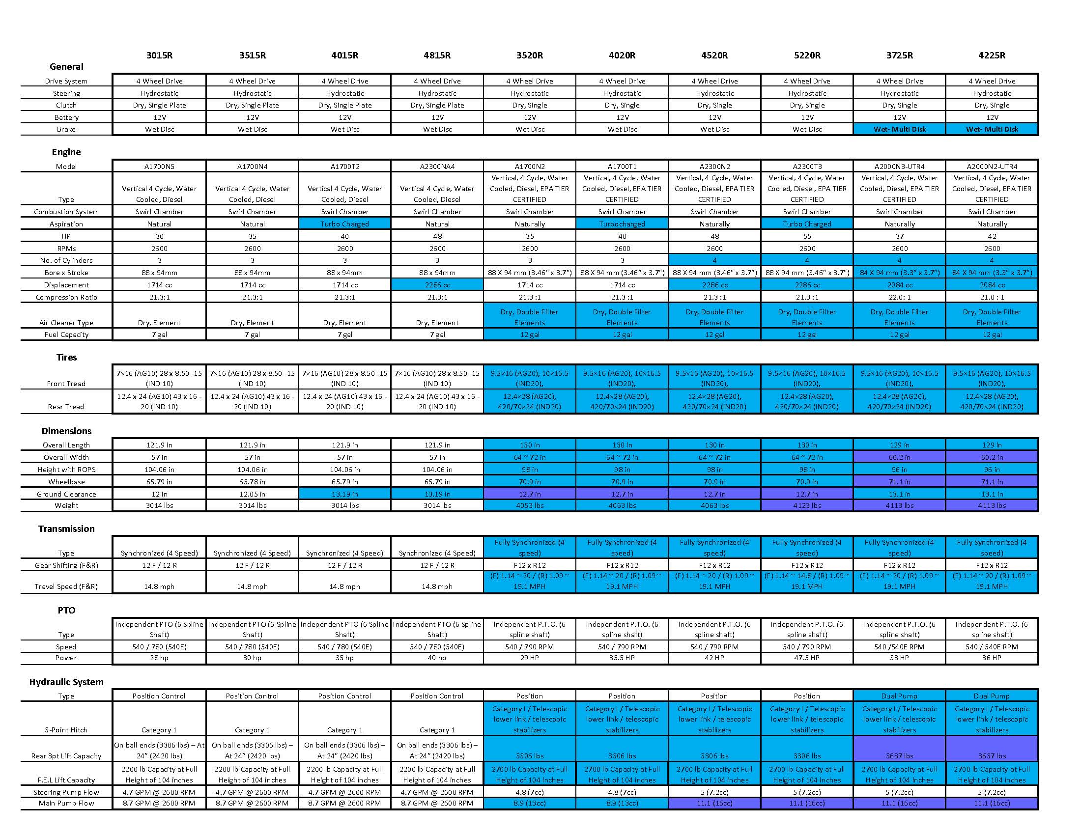

Quick question, do the newer engines in the 20 series (tier 4 compliant) ones still have this same DPF/DOC emmisions system? This thread originally started about a 2015 tractor.
The reason I ask is that I am in the process of replacing my 40 year old Long 510 tractor (52 hp) with a new Branson and on the Branson website it shows the 20 series as being tier 4 compliant engine. The 15 series is not specified as being tier 4 compliant. The reason I am asking is because I would rather buy one of the 15 series or an older version that get something I am not able to work on myself. I would not remove the emmisions system immediately, but I would like to know that if it starts giving me problems I can.
I am still in the process of researching what exact model I am going to get but I am leaning toward the 4020R or 4520R. THis is a little spreadsheet that I put together for the 30-55 hp shuttle shift Branson tractors off the info on their website in case anyone else is shopping :)
   / 2015 Branson 3520h DPF Issue #116
All Branson tractors are Tier 4 Compliant. And the best part is that they don't need any computer to run the engine. Hence the ease of the removing all the DPF parts. Just need to remove the data logger, the DPF can and get a new muffler on and it's good to go. However, it seems that the Branson DPF system doesn't give much problems at all. Still it's good to know that can be easily "fixed" if there is any problem.
The 15, 20 and 25 series are pretty much the same. Being that the 15 series doesn't have cab (They just started selling them with cab in Europe) and it's a bit smaller frame than the 20 and 25 series. The 25 series is a newer and upgraded series of the 20 series, so it might have some minor bugs corrected from the previous series.

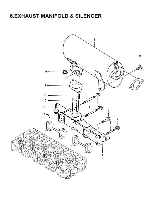

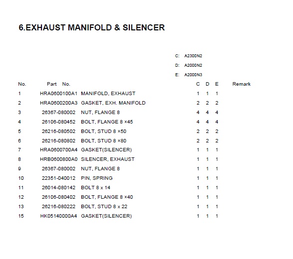

Would anyone happen to have the Kukje p/n for the silencer for a 2016 4720h Branson handy? I run mine up to the high end of the RPM range but am only doing a lot of FEL or Backhoe ops so the exhaust isn't getting as hot as it should to burn that crap off....
Thanks in advance!!
   / 2015 Branson 3520h DPF Issue #119
I'm not sure if you are able to find a silencer for Branson tractors in the US, since they have to be sold with the DPF canister. Maybe the dealer can work something out on that.
Worst case scenario, you get a silencer from another tractor and fabricate something to make it fit.
Anyway, here is the part number.
