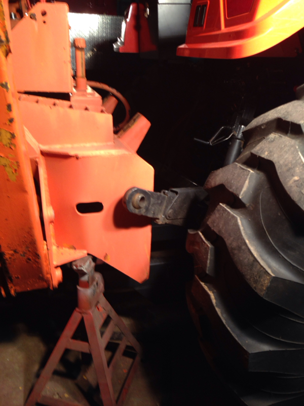

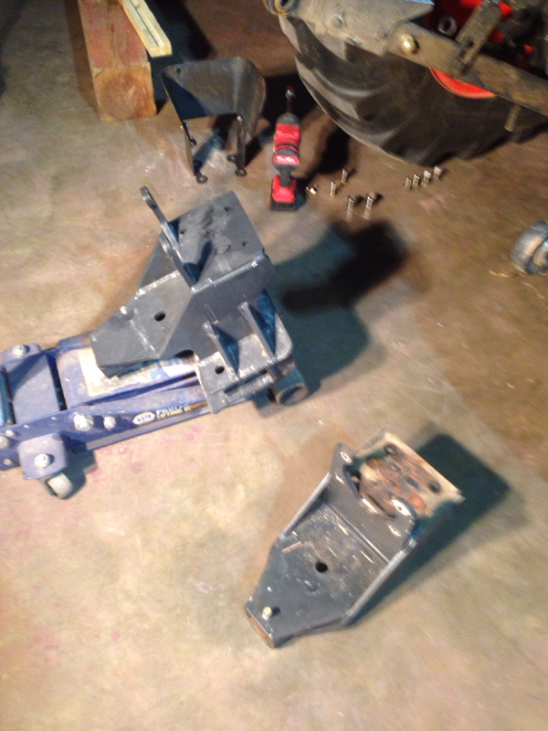

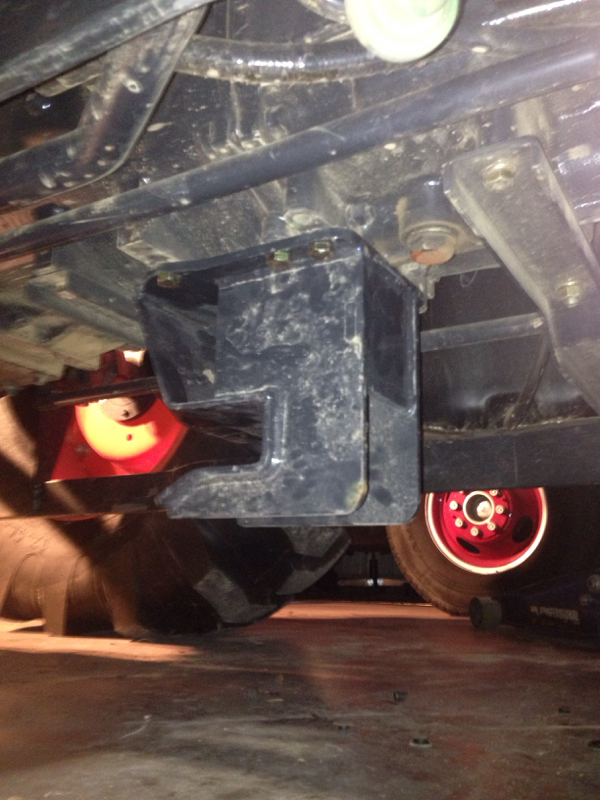

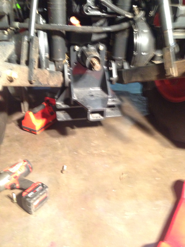

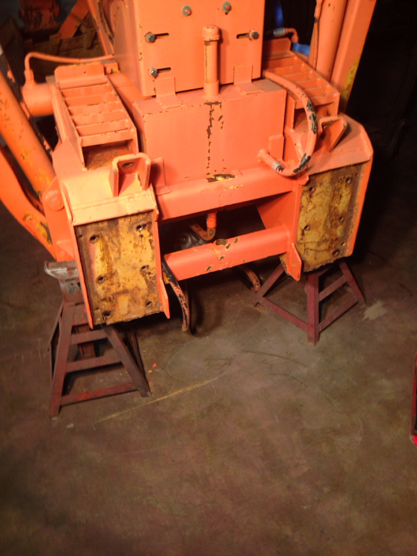

Finally started the backhoe mounting on my NX , I ended up buying a factory subframe from my dealer at a big discount I couldn't pass up. The backhoe came with my kubota L3410 when I bought it 10 years ago. I sold the kubota after buying a new NX5510 cab and decided to use the backhoe on it instead of buying another one. The backhoe is a case D100xr SSQA mount that was converted to a self contained hydraulic system with pto pump. Here are a few pics of the new frame mounts for the tractor and the backhoe with the old subframe removed.

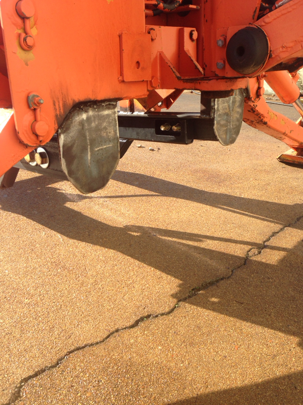

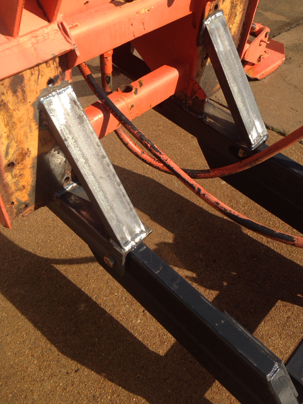

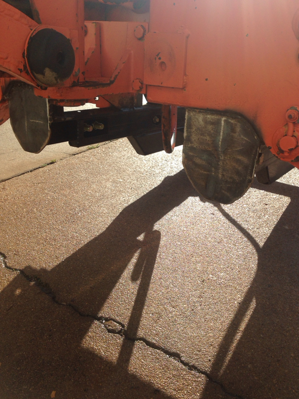

Finally got back on the backhoe project, welded up mounting brackets to the backhoe that bolted up to the factory NX subframe. I still have a few little odds and ends to wrap up but for the most part its ready to try. For now I'm going to keep the pto pump, but plan on switching it plug into the tractor hydraulics later.
